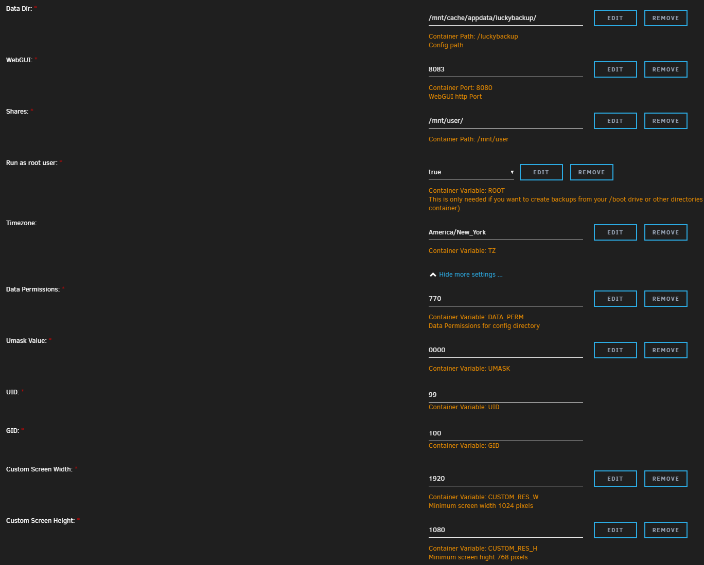

I just noticed this in the template settings for the luckyBackup container:
Shouldn't these vars be PUID and PGID? All other containers I've ever used, these vars have the P in front. Could that maybe be cause the UNKNOWN owner issue? Basically, the owner isn't being set?

Here's my LB container settings (I will at the least take your advice to set the host files to read-only):

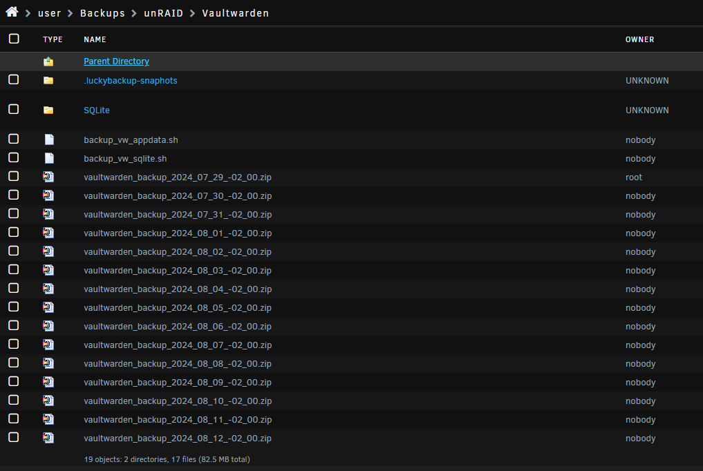

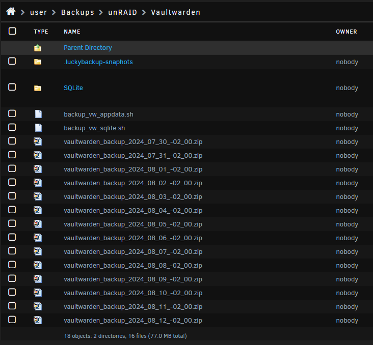

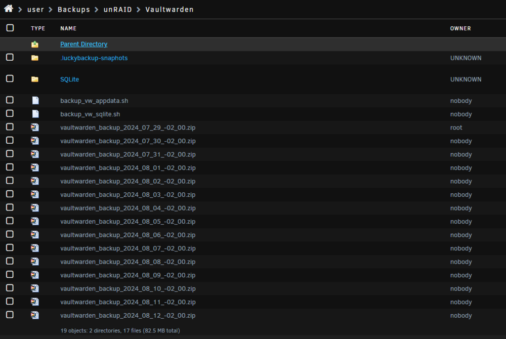

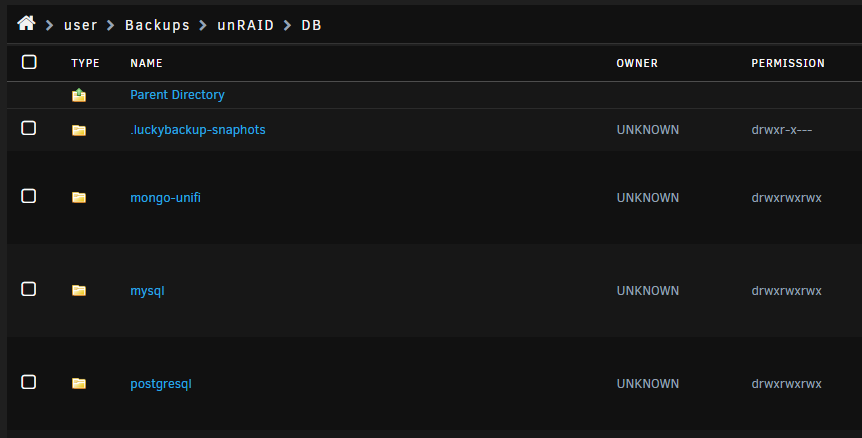

Okay. I did a test and running the LB task is changing the owner on at least one folder and I can reproduce the outcome every time.
With the host folder set to read-only, I get errors in the log. I assume because it wants to write the .luckybackup-snaphots (incidentally, those folders are misspelled. Missing the S in shots 🙂 ) folder to the source?
Not a big deal as long as it backs up. So, just for testing, I switched the host directory back to read/write.
I set owner:nobody on the entire folder to be backed up. I run LB backup task and come back and the files have the correct user, but all the folders keep being switched to UNKNOWN every time I run the task.
But, it does not set the owner to UNKNOWN on the destination (maybe because all the files are already synced and it has nothing to write to the destination).
I posted a separate thread on the unRAID forum to see if I can get somebody that knows more to give me some insight as to why this could be happening. I don't think it's just a LB thing. Obviously the db-backup container is doing it too.
Before LB run:
After:
Edited by Mattaton
Link to comment

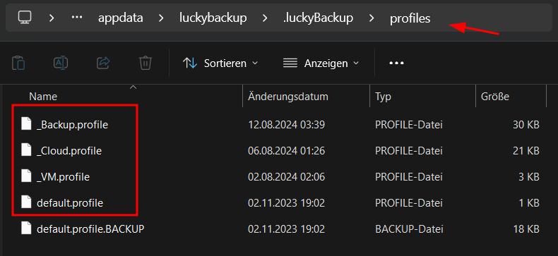

may upload your profile files instead
especially the one/s which includes the jobs which are causing this

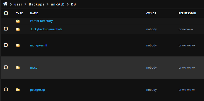

Okay. I've attached the profile for these tasks.
@Kilrah I wanted to point out, I have this issue on all folders that LuckyBackup backs up. Not just the ones that db-backup also has access to.
For example, my Vaultwarden backup folder is not touched by db-backup, but when I sync that folder to the remote server with LB, the Vaultwarden folder and all folders within are changed to owner UNKNOWN (including the .luckybackup-snaphots folder that LB controls). See images below (before/after LB run).
Does this same thing on all folders that LB syncs, including my Immich folder (which is the live folder used by the immich container and not a backup that is just synced to the other server).
I can make the volume read-only to LB, but if I do that, it can't write to the .luckybackup-snaphots folder.
daily.profile
Link to comment

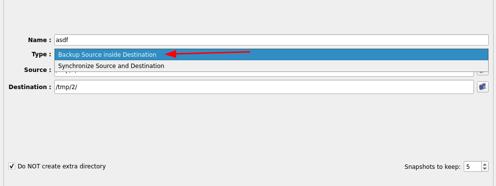

You have set up a sync not a backup task:
TypeSync=1
You have to use this option:
A sync will always sync the two servers and will not Backup them, I think that is your main issues (by default it is set to Backup Source inside Destination).
This was also a thing because I wanted a screenshot of your settings because it would be pretty obvious in the screenshot too...
Link to comment
12 minutes ago, ich777 said:
Wait, the .luckybackup-snapshots should be in the destination not in the source...
TypeSync=1
Okay?
But isn't sync a viable option if I want the destination to have on it exactly what the source has on it? So if a file is removed from the source, I also want it to be removed from the destination. Is a sync not the way to do that?
Basically, I want a duplicate of the backup on the source on the destination.
Wait, I see what you mean. If I were to add a file onto the destination, it would copy it onto the source. BAD. I don't monkey with the destination, so this has not been an issue. But I can see how it could be.
I assume you aren't saying this is the reason that the owner is changing, right? Like, if someone were to use sync (and mean to) the owner shouldn't change on the "source" side, right?
Edited by Mattaton
Link to comment
Sorry but that is not what a sync does, a sync does synchronize the two servers.
To explain that a bit more in detail rsync will create a list of all files on both servers, then compares the files between the servers and syncs the files from Server A to B which are missing and also syncs the files from Server B to A which are missing, so that you have both directories exactly the same but that could also lead to old files being synced back from Server B to A.
You want to use a backup task because you only want to sync new files from Server A to B and delete old files which are not existent on Server A anymore.
Sync:
Purpose: The primary goal of sync is to ensure that two directories (source and destination) contain the same files.
Backup:
Purpose: The main aim of a backup task is to create a copy of files in another location for safekeeping, without necessarily making the destination identical to the source.
