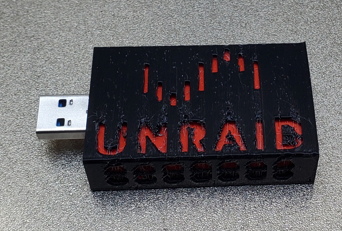

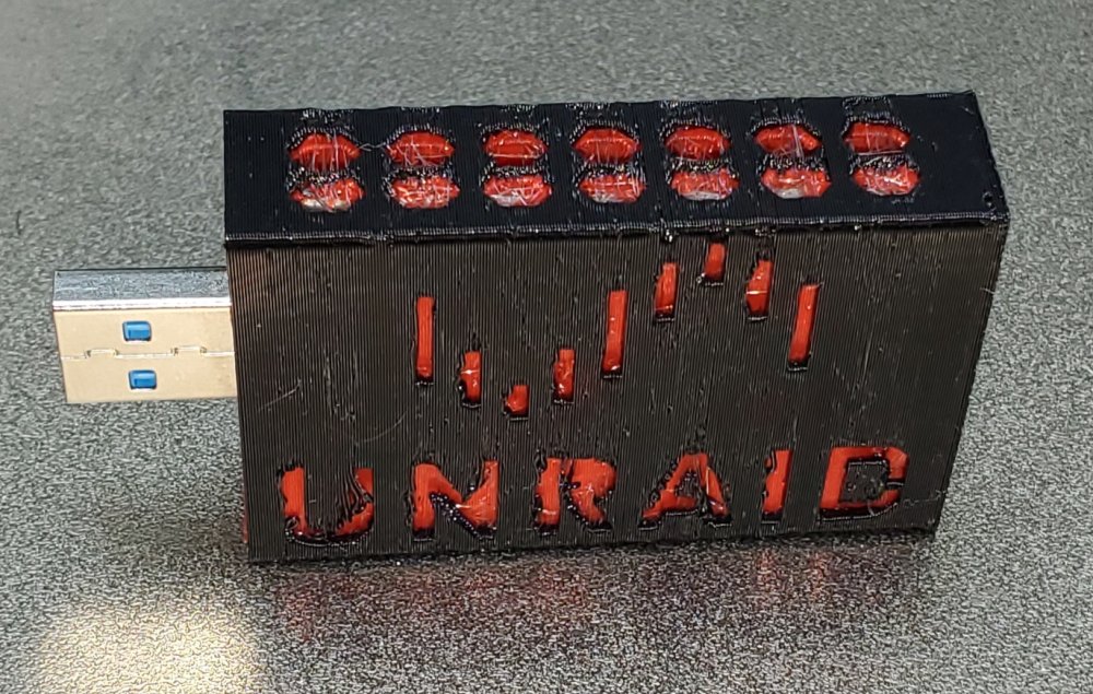

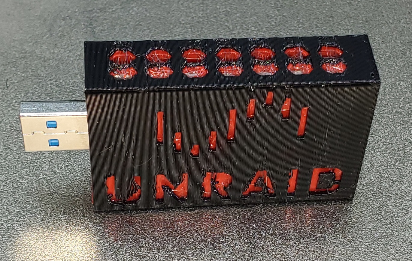

I spent a few hours in blender, here's a rough draft. I can add Unraid text pretty easily, but I just wanted to get a proof of concept going. It's a very tight fit, Printed in PETG, so stringing galore across all the tiny holes. First draft was no ventilation, just the two shells, which printed perfect in PETG, but I wanted airflow possibilities.
Have you checked temps after prolonged running yet?
Yes, checked the temps with the solid case models I've tried and no issues. Your case most certainly won't have any issues with all that ventilation. Good job!

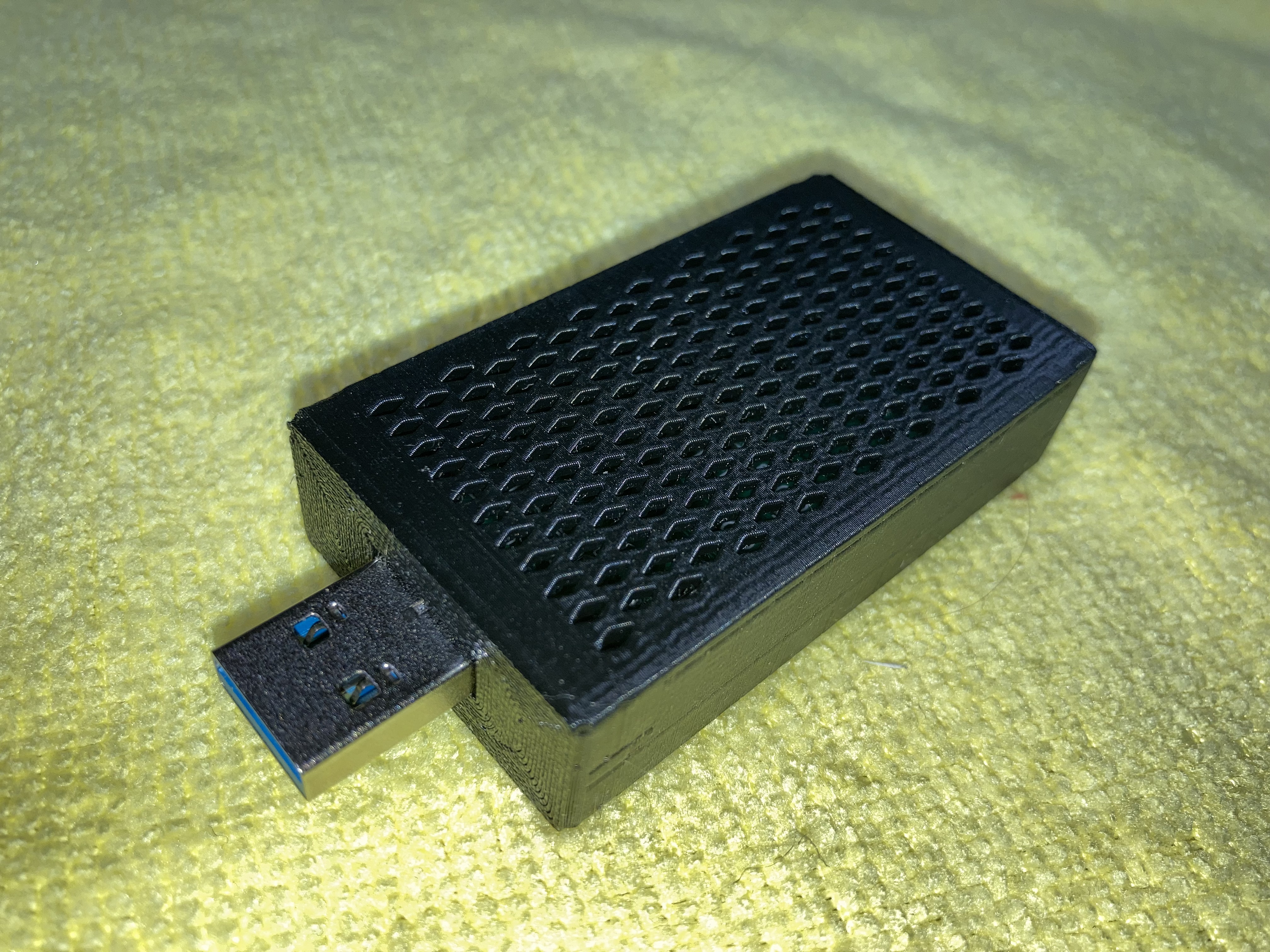

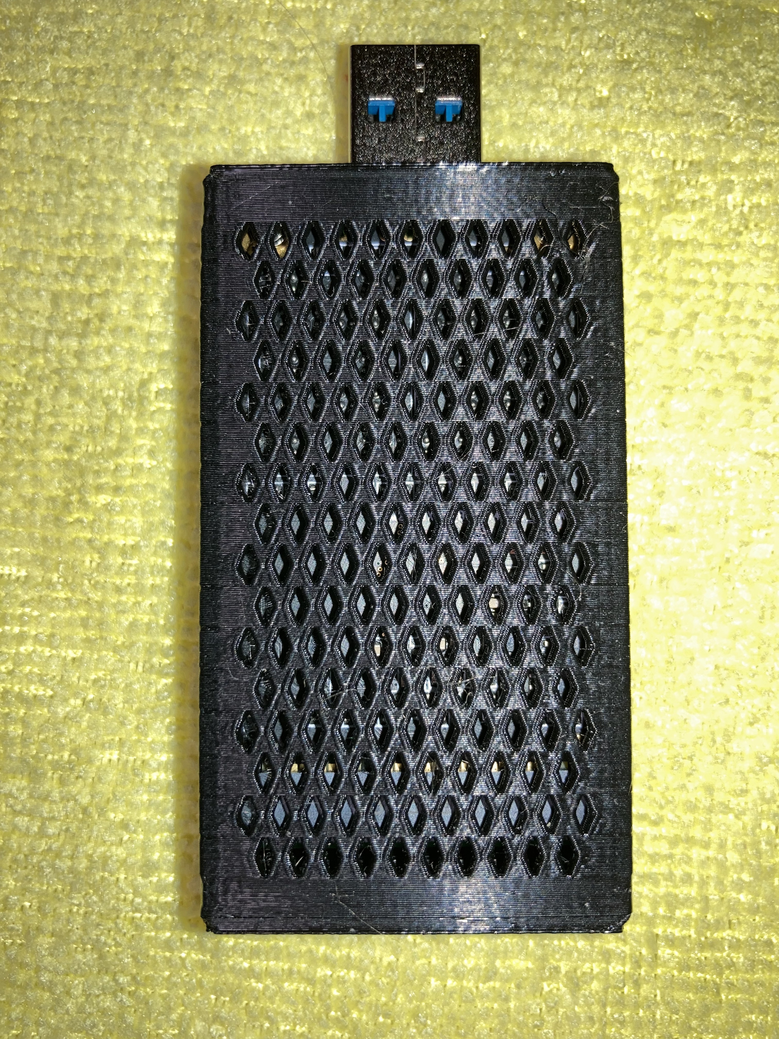

    After seeing your request to JonathanM, I created my own design which I am happy to share.  It does not have any markings or trademarks, but it does have around 350 diamond-shaped ventilation holes fo

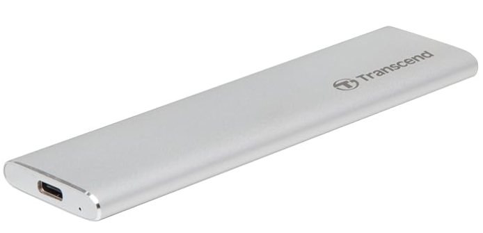

That's certainly another option. I'm tempted to buy one of the Eluteng to m.2 SSD adapters that looks like it will also have a unique GUID. Too bad the GUID isn't just the enclosure for this Transcend model as that still means a license transfer if/when the SSD dies. But as m.2 SSDs use the higher quality NVRAM, it may have a long life.
I had one of my systems corrupt the mSATA SSD about 8 months into use. I swapped on a replacement mSATA SSD, used the Creator Tool and then restored my backup and was back up and running in 10 minutes. With the Transcend adapter that might take a bit longer as you have to transfer the license as the GUID will change with a replacement m.2 SSD.
That said, I fully tested the mSATA SSD that got corrupted and it's fine. Ran multiple tests and nothing wrong at all, so it was just a random corruption but no actual failure. I suspect a m.2 SSD would behave similarly - you would just have to reformat, rebuild using the Creator tool and restore your backup instead of replacing the m.2 SSD. That way the GUID remains unchanged and no license transfer will be required.

Crappy print quality, but it shows the basic form.

Couple issues that I need to work through. I'd like to make a little something from my hours of design work, however, it's using registered trademarks, so I'm not comfortable asking for money, or even releasing it without Limetech's ok. The Limetech team is super busy with way more important stuff, so I haven't even had the discussion with anyone that has the authority to discuss it. I don't want to add more distractions to the mix, it's bad enough that they are dealing with the premature announcement of the license restructuring.

After seeing your request to JonathanM, I created my own design which I am happy to share.  It does not have any markings or trademarks, but it does have around 350 diamond-shaped ventilation holes for cooling.  I've uploaded the .stl files to Thingiverse along with some images, notes, and settings.  You can download the files and read more design here:  https://www.thingiverse.com/thing:6520361
I hope that folks find it useful.
Downloaded the .stl files from Thiniverse, ordered them for printing from Craftcloud, total only $11 after production and shipping.
Thank you Missy. Will donate to a local charity per your suggestion.

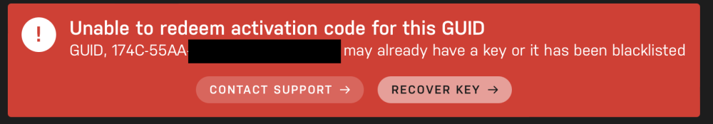

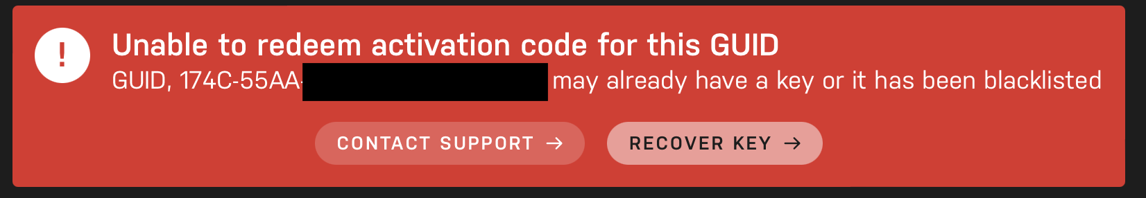

Warning:  I bought both products from those links and got this GUID-used-or-blacklisted error when I tried to apply my activation code:
So much for "appears to provide unique GUIDs for Unraid."
I emailed Limetech support and am awaiting their response.  I suggest that people hold off on buying these pending some sort of resolution.
I will amend my post. Thanks for testing and sorry it didn't work out- you should be able to return the adapters within 30 days. I'm trying to determine now if this was a "bad batch" or something that changed from a manufacturing standpoint. Thus far, I have not heard back from Eluteng in my communication attempts.

*Already downloaded your thingiverse files. Thank you for sharing. Hoping they might fit.  Clean work with an Ender 3 @Miss_Sissy

@Miss_Sissy your .stl file worked perfectly to house the referenced parts. Just arrived. Thanks for sharing.
I'm glad that the design worked and I'm sorry that the parts don't provide a unique GUID for our use with Unraid.  I was nervous that you couldn't do any iterations to make adjustments, but it sounds like the service you used has printers that 'agree' with mine.

I had assumed that because the poster was listed as an "administrator" on the forum and posting that "we've been internally testing and vetting" the devices that it was advice coming from Unraid's internal team and the device would work.
Add this user to the list who bought the recommended device and found the GUID had already been blacklisted (used).
Overall not too much $ lost I suppose, just $30 on Amazon for the device (plus $11 for a (really nice) enclosure for it). Unraid has been worth that and more, IMO.
The post now says "caveat emptor". I would humbly suggest the admin team "caveat postor" to prevent similar in future.
