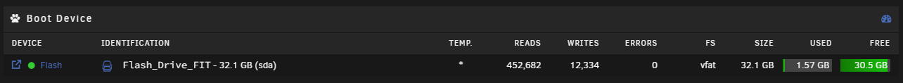

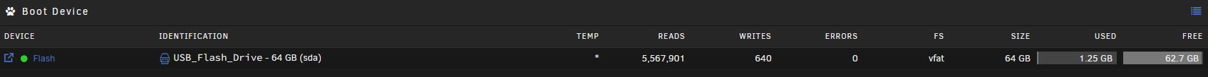

Uuuhhh...what am I doing wrong???
Other than updating plugins regularly, why am I writing to flash so much more than you?
Probably this

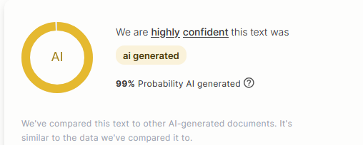

Moreso now that it's being debated against ChatGPT

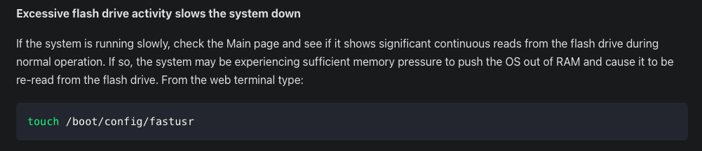

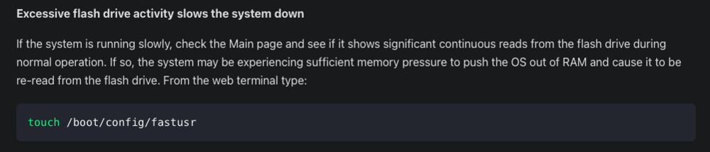

There is also a piece of code you can enter if you see lots of reads happening from your usb stick (unraid 7 issue).
