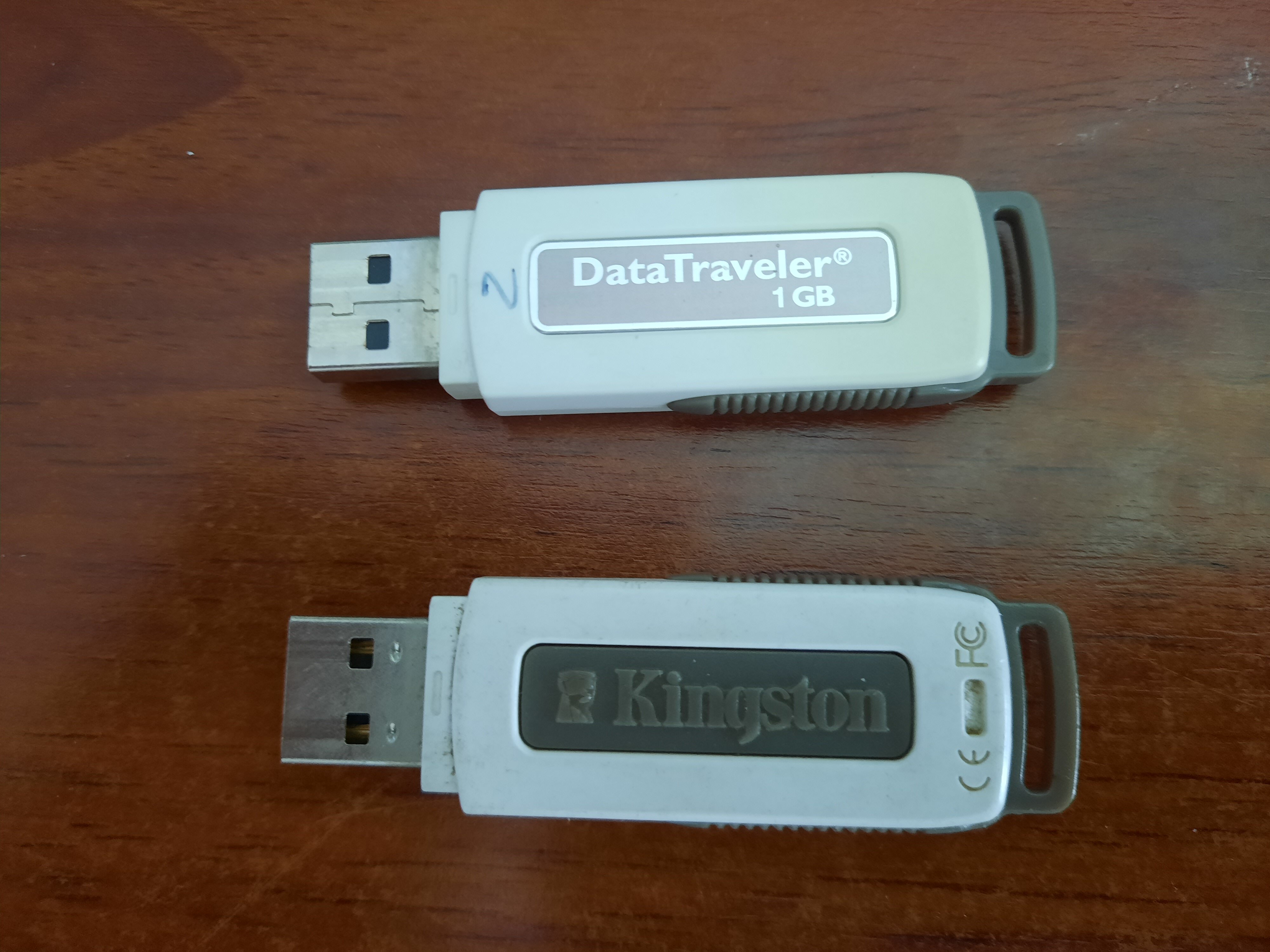

Assuming the stick was made and purchased around 2007, it likely contains a large-node MLC flash chip—either 70nm or 56nm—paired with a low-power, thermally efficient controller
Those are indestructible in the Unraid environment.
No wonder they're still running in your machines.
