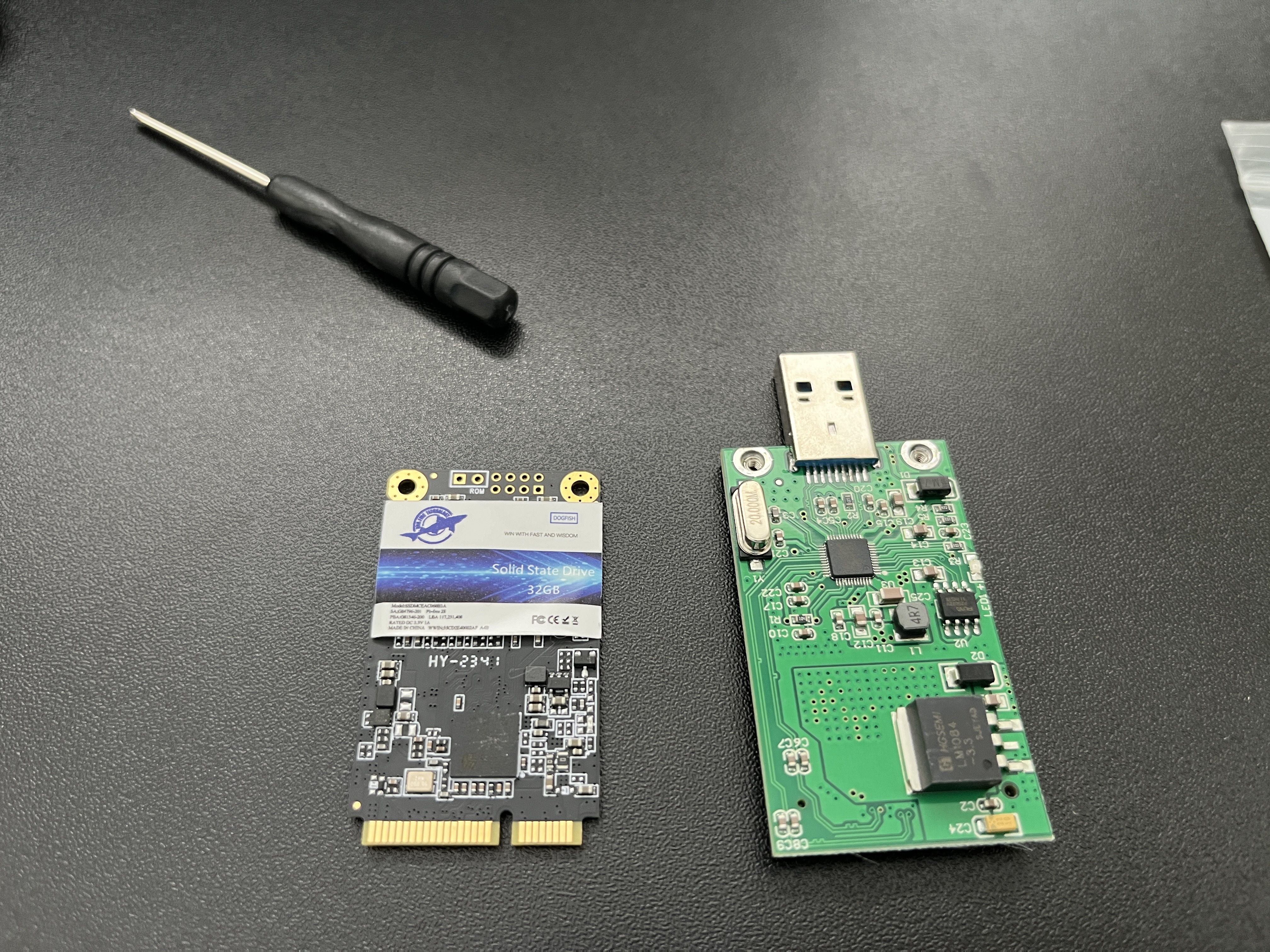

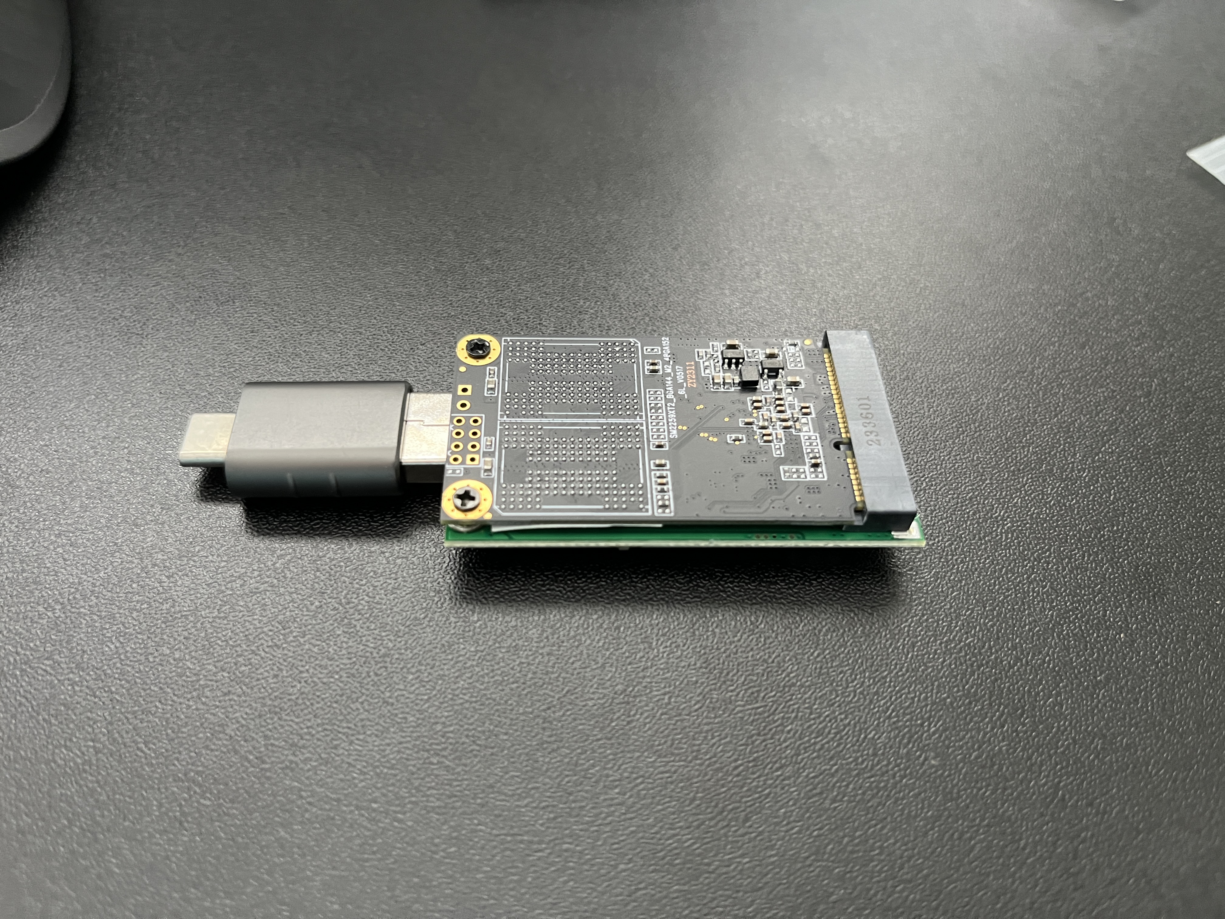

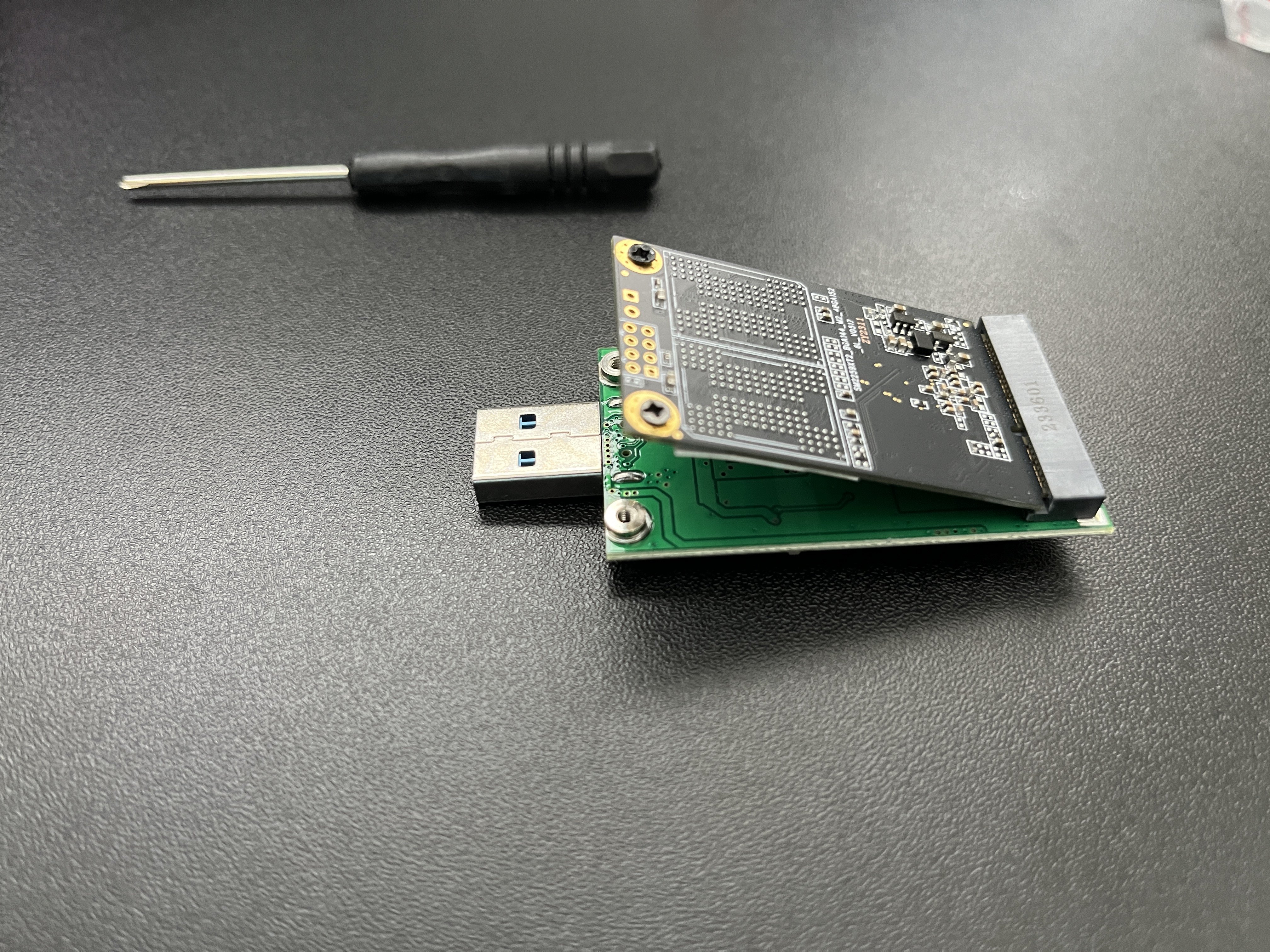

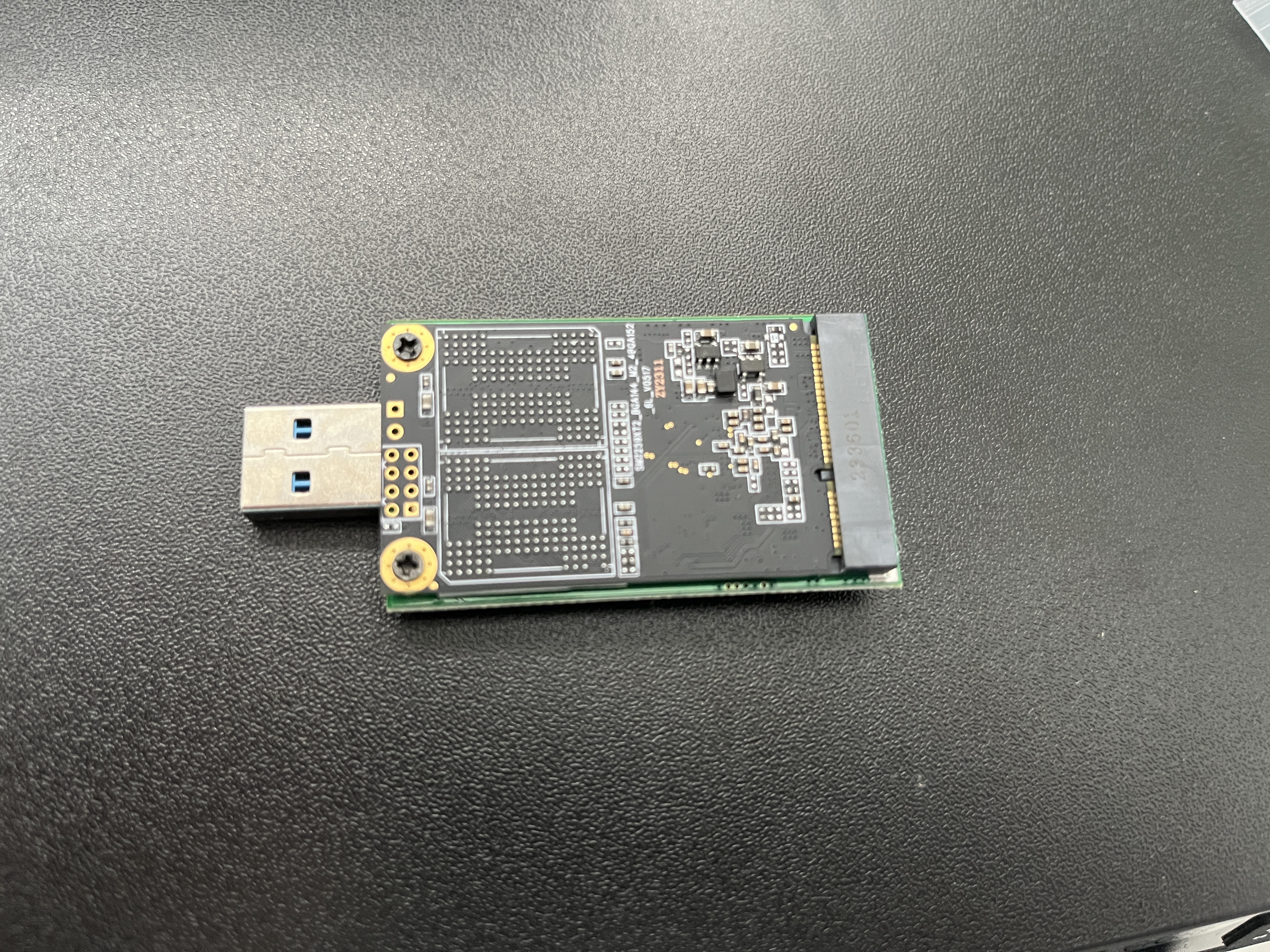

Another option/alternative to USBs that we've been internally testing and vetting are mSATA adapters/drives:
This USB mSATA adapter (~$10) appears to provide unique GUIDs for Unraid:
This 32GB mSATA drive works with the above adapter (~$15):
To avoid having the adapter hang off the back of the machine, these can allow you to mount it inside your case (depending on your system):
Important notes/caveats:
  1. The mSATA drive does not come pre-partitioned, so you have to create one yourself.
  2. Windows sees it as a hard disk, not a removable drive, so the USB Creator might not write to it and you may need to use the manual method. The USB Creator worked fine from a Mac for me.
  3. While we're not officially officially recommending these just yet, multiple members of the Unraid team are running OS instances off of this exact set up. We hope to have a full blog/video on this alternative soon.
You can use them for Unraid VMs too, just be sure to configure "USB 3.0 (qemu XHCI)" in the VM template (even if the host only has USB 2 hardware!). As always, if you are running the same make/model of drive for both the host and the guest you will need the "USB Manager" plugin to pass the drive to the VM.
Major props to @AgentXXL over in our Discord server for doing much of the early testing on this.
NOTE: This solution is no longer valid as the manufacturer is not longer implementing a unique GUID on the adapter. Sorry for bad news.

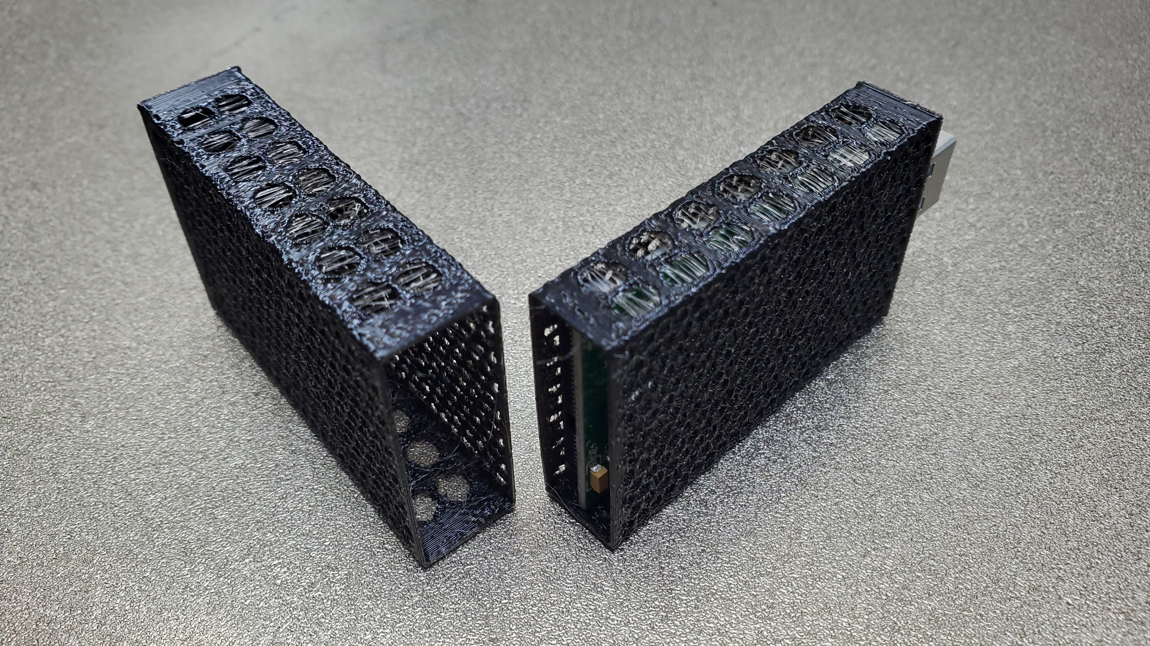

I'd recommend using appropriate insulation to cover the circuit boards if you want to put these inside your case. Either design and 3d print some sort of case for it, or maybe wrap it in Kapton tape.
(generic available for cheap) https://www.amazon.com/dp/B017CSQJ6G/
There are some models for a case already available on 3D printing repositories like Thingiverse. I've tried all the ones I could find and none of them are an exact match for the Eluteng adapter. I've been meaning to make one with unRAID engraved into the case, but it's become a back-burner project. Guess I might have to get on that. For now I'm using just the case portion of one of the ones I printed - the end cap where the USB plug sticks out isn't a good fit for the Eluteng adapter so I just left it off.

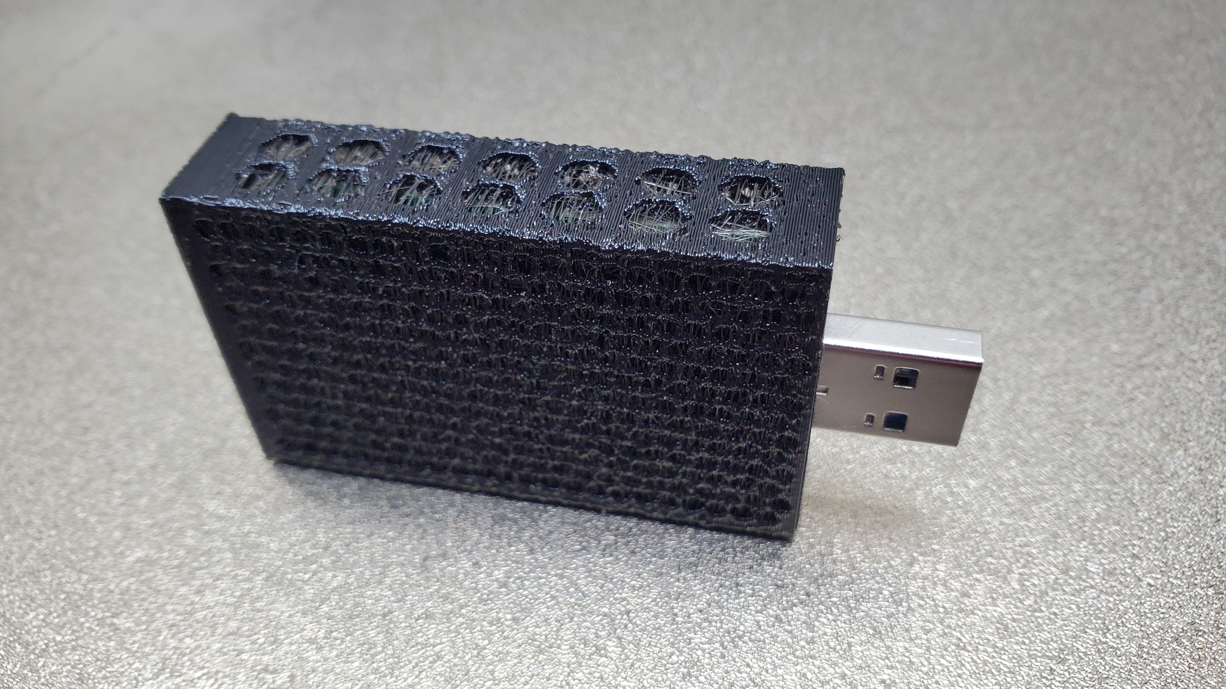

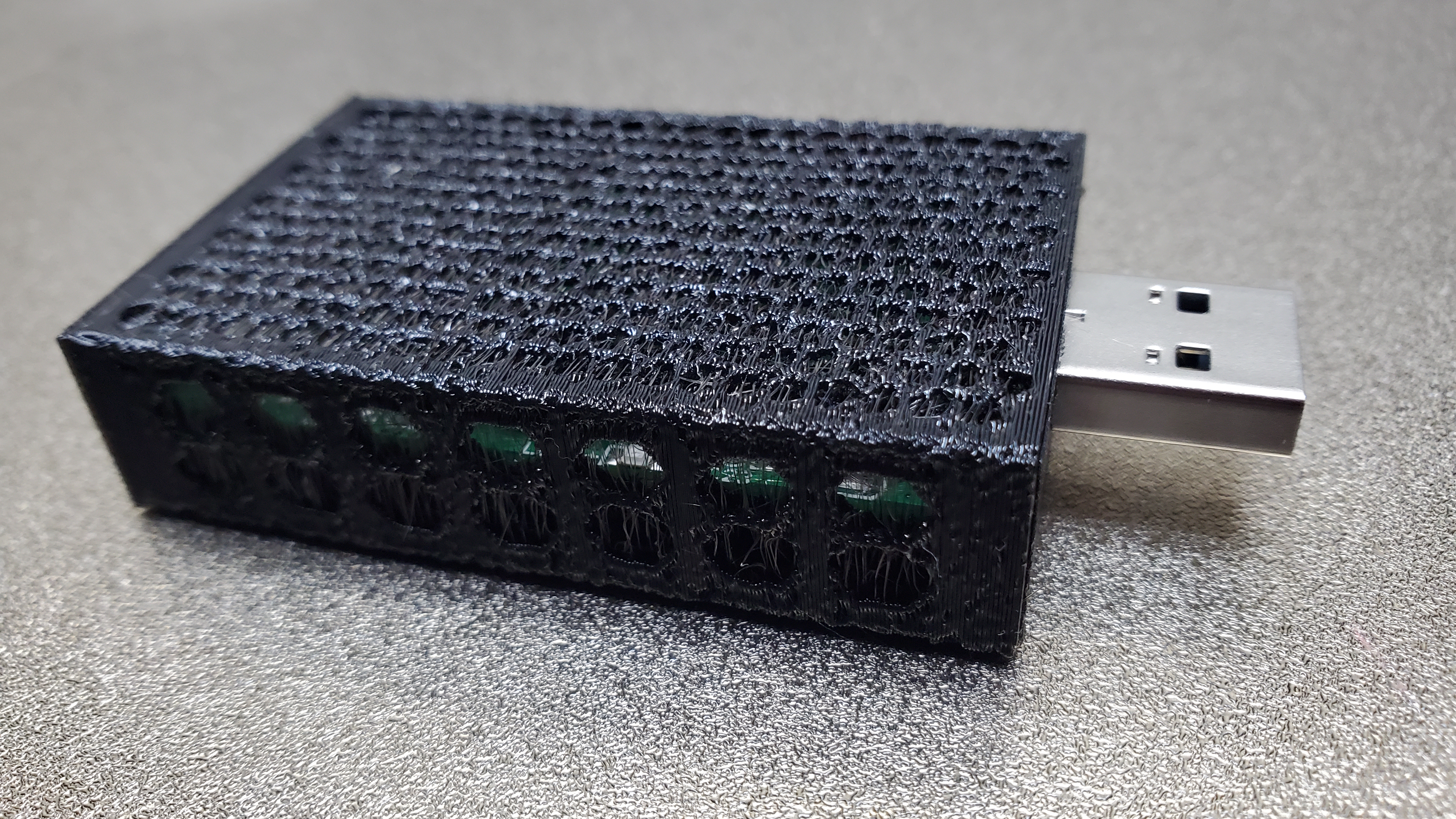

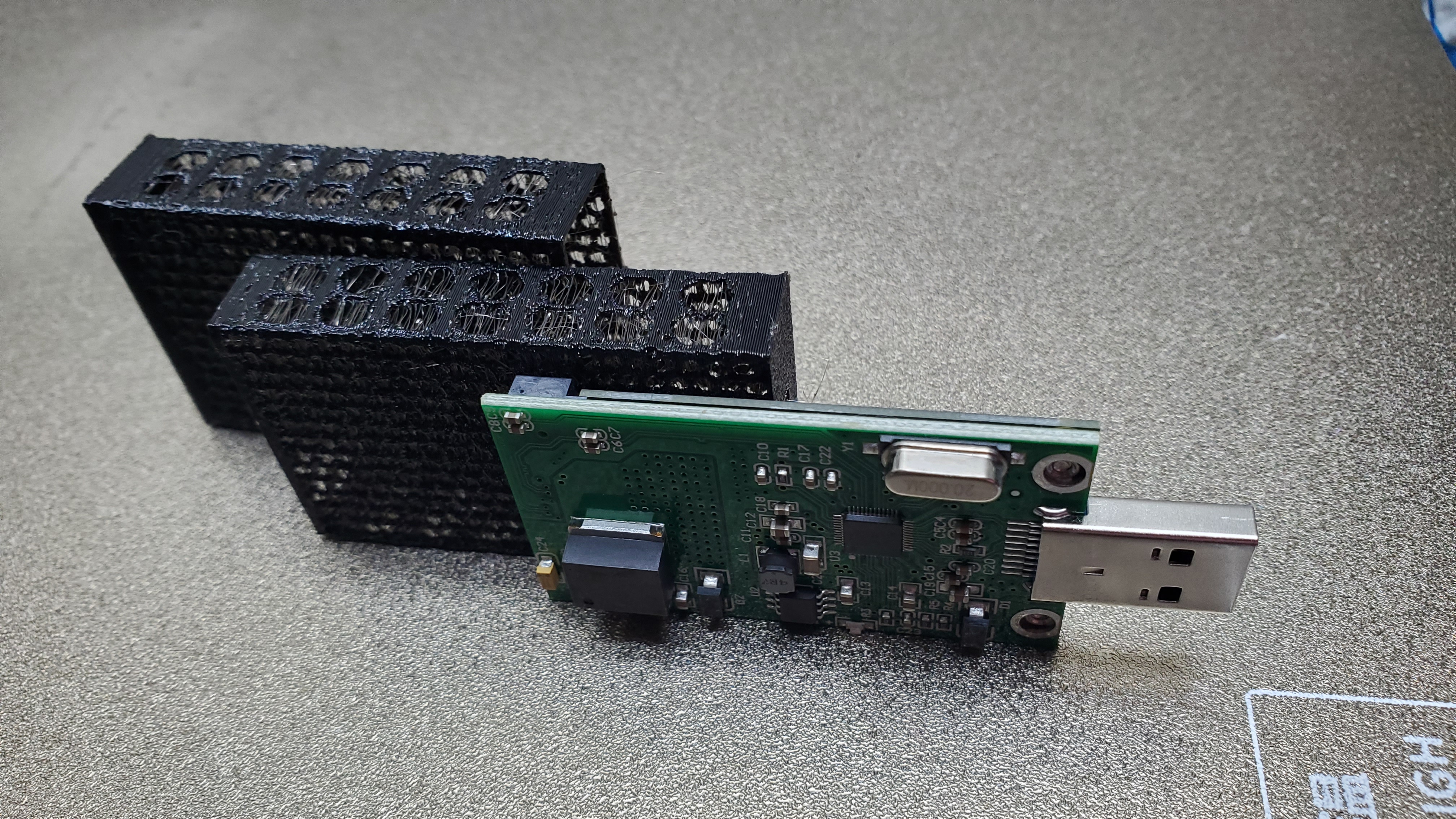

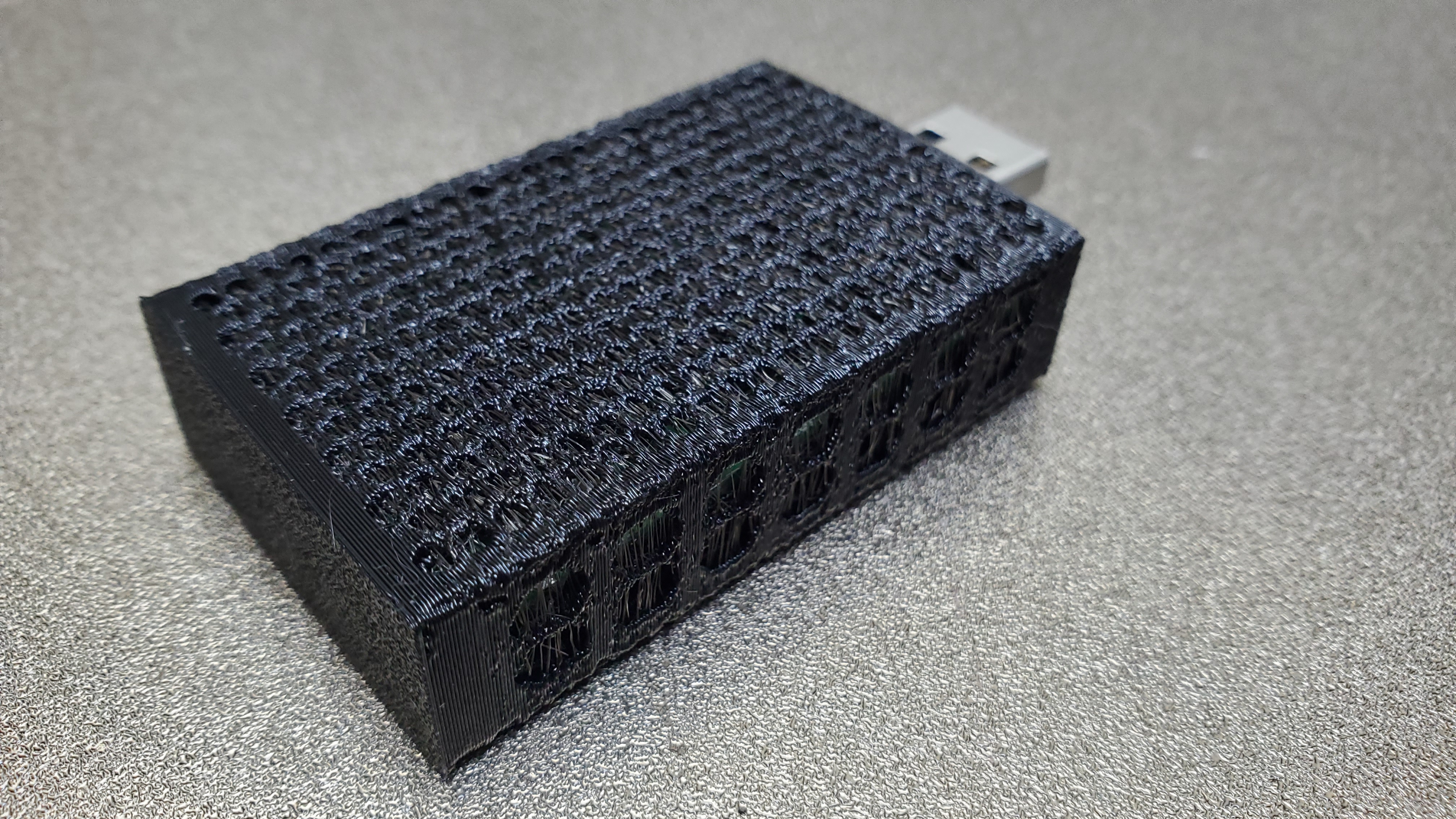

I spent a few hours in blender, here's a rough draft. I can add Unraid text pretty easily, but I just wanted to get a proof of concept going. It's a very tight fit, Printed in PETG, so stringing galore across all the tiny holes. First draft was no ventilation, just the two shells, which printed perfect in PETG, but I wanted airflow possibilities.
Have you checked temps after prolonged running yet?
