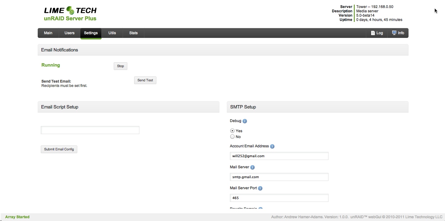

I seem to have broken email notifications, the email script settings are not there.Has anyone seen this before?

Question...when using the email notification...is there any way to not have the script send your email password to the syslog?  Just started using this so I probably overlooked a configuration variable.
Line 178: 2012-06-05 02:34:17 info 192.168.1.108 mail sSMTP Set AuthPass="Hi"
Make sure you're using a hashed (MD5) password if your provider supports it.
disable "debug mode" once you have things working.
Oh yeah, and that! Ha, thanks Joe  ;)

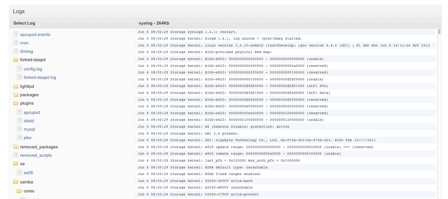

Getting some good progress on the log viewer...  Working on a way to clear/save a log. Logs update in real time, and I'll be scanning and showing errors. Will also have a way to filter the log entries as well.
Any suggestions/comments so far?
Looking great! If you are going to be scanning and filtering out errors do you have a plan for how these will be displayed? It would be good if any "bad" lines were highlighted in red and any "warning/unknown" lines highlighted in yellow (or similar). You would probably also need to work out a way to keep any errors from becoming buried in the history - perhaps have the highlighted lines written to a seperate log file that could be accessible even after a serious crash. One of the biggest issues I find with the default logging in unRAID is that by the time you realise you need a syslog it's too late :(

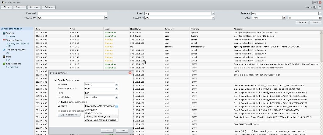

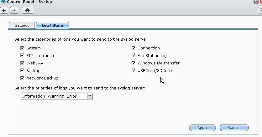

Nice work.  I've attached two screenshots of Synology's syslog server/client for reference.  Looks similar! :-)
Maybe have a configurable email notification based on the event level?
Filtering based on event level and category would cover the request by chickensoup to have a separate log for errors.

For the meantime it will be just a log viewer. Eventually once the email notifications script gets re-written, we can start integrating it with logging and so on. I alone won't be able to code such a log viewer like Synology's, considering they have professional paid developers to do that sort of work. It's also possible for them as they custom built a lot of the plugins, therefore have much more control over how the logs display. We don't have the luxury here, anything goes with logs!!
I'll do my best though  ;)  Might be able to work out a solution to provide an "All Logs" log, with the ability to show just errors.
It will be word filtering, along with checkbox filters for warning & errors. These will show as yellow/red highlights. May be able to work out a solution for doing this with all logs combined.
