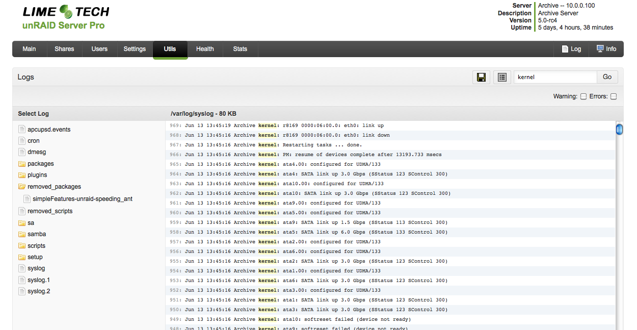

Please test a new plugin! The log viewer is now ready to download: http://unraid-simplefeatures.googlecode.com/files/simpleFeatures-v1.0rc3-log-viewer-addon.tgz
This is working fine for me. Very nifty feature :)
Filtering seems to work fine too, though I don't have any errors logged on my system.
Some observations:
- On my system the displayed font for the log content is rather small with more white space. Can the font become bigger with less white space instead?
- Nice addition would be to allow sorting on either oldest or newest entries (similar to the notifications add on)
- Perhaps a (popup) legenda explaining the color codes may help users to understand better their meaning.
- Saving a file - I guess - is still work in progress
Thank you for offering this excellent addition.
Hi All,
Some observations:
Can increase font size :) No problems there. Can also sort, and add a legend for warning/errors.
What issues are you having with saving the log file?
Hi
The new Log feature looks nice! Some small points from me too:
1) I agree that the font used for the log is very small and with quite much whitespace. Must a "courier" type font be used? Could you use a sans-serif font instead?
2) I also agree that I would like to see an option to sort both ways
3) If you search for something with the search box, the only way to reset it is to clear the text in the box and "go" again. Maybe a clear icon?
4) Maybe an option to filter only Info messages as well?
5) What about an option to filter on process? Aka "show only emhttp" or "show only kernel"?
6) Is there a reason that the window is fixed in height and not using the whole screen?
Keep up the good work!
This sums up my feelings.
Limetech should officially support this plugin. It is a must-have, and really should be included with unRAID. I am so glad I stumbled upon it.
Two things I see happening (not major but can be addressed anyway):
1. When selecting a non-empty file it is copied (created) in the directory /usr/local/emhttp, and never removed. Better create temporary files in "/tmp" or "/var/tmp" and delete them once not needed anymore.
2. When selecting an empty file, it will open a blank screen in the browser. Better check the existence of the file before the copy process starts.
Oops, cool both are bugs then. It should be checking before creating an archive, and the code should be there to delete it  :)
