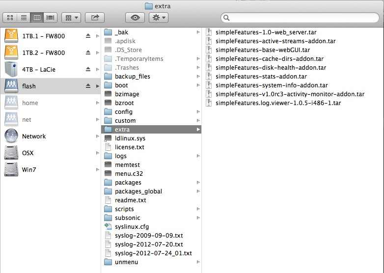

well, you're right in pointing out that the /boot/extra refers to an "extra" folder created in the *root* of the boot flash drive (which is called "flash" in my case), because i did in fact initially create the "extra" folder *inside* the boot folder.
but even after moving it into the root of my flash drive (see attached image) and rebooting, i still get the regular unRaid web GUI.
i know i'm just missing something totally obvious (to others), but i'm still not getting it...does my "flash" drive need to be renamed to "boot" or something like that?
The contents of your extra folder contains tar files, should be tgz files :)
Copy in the packages (must have .tgz extension) you wish to have installed on Boot.
silly me...i knew it had to be something as "obvious" as that! but why did those files all end up as tar files after downloading them to my computer, when i used Safari to get them straight from the google code site (wher they are listed as tgz files)? can i just rename the extensions, or do i need to use some other means of downloading them as tgz's?
I use 7-Zip (Windows) to extract the tgz files. Believe Apple has their own set of utilities to extract the files...
It sounds like safari may have un-gzipped them to give you the tar file.  A tgz file is a tar file that's been gzipped.  To ensure you're getting the correct file you can copy the link to the file, and then open terminal, navigate to the directory you want to download the file to, and type:

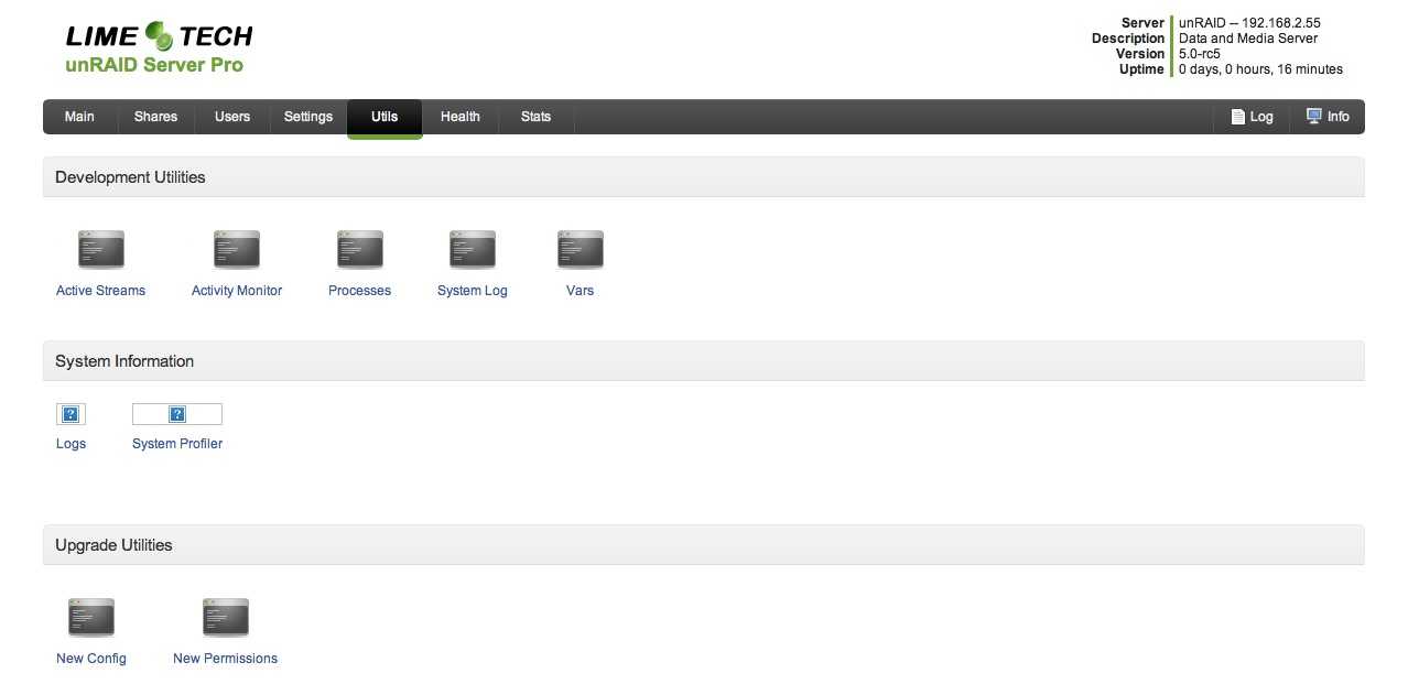

Update 1:45pm: just no success with wget...if i copy the URL from the google code page via right-click and "Copy Link", then paste it into my terminal window after wget (i.e. "wget http://code.google.com/p/unraid-simplefeatures/downloads/detail?name=simpleFeatures-v1.0rc2-base-webGUI.tgz&can=2&q=), i end up with a 10kb file in ever case, no matter what the link is...so i ended up going into Firefox, and found that Firefox allows me to download the files with their tgz extension intact...after i re-downloaded them all, deleted the previously downloaded versions from the extra folder on my boot flash, and replaced them with these newly downloaded versions and rebooting, i get the same "Package was not created with 'makepkg' warnings i got before...but they do install and seem to work exactly as my previous attempt...i am still missing the icon for "Logs" in the Utils section, and just found that the "System Profiler" icon also just went missing...it was there initially ("Logs" was not)...is there any way for me to fix that, or is that an error in the install package? (see attached screen shot)
hmmm...the System Profiler icon just came back, and as for the Logs icon, i saw that a bug report has already been posted to the google code site...so just ignore me...staying put.

Simply download using Firefox, or untick the "Open safe files after download" checkbox in the Safari preferences pane. If the files are STILL being uncompressed, chances are they're in your Trash.
If you still cannot manage it, just telnet into the unRAID box, and wget the files from there. Wget is included with unRAID box.
Repeat, there is no need to do anything to the packages. If you're repackaging things you've gone too far!!!!

yes, i did end up being able to download the files properly with Firefox and install them successfully...not sure why i wasn't able to make wget work properly for me on my Mac (it kept downloading small 10kb files, rather than the actual files), but next time around i'll try it from the unRaid box via terminal...i really am pretty useless in terminal, so i am sorry if i sounded and acted like a total newb...trying to "tar and shizzle" definitely felt like i had overshot the goal, but i guess that's how we learn...i was able to accomplish the task at hand shortly after with solutions similar to the ones you suggested...
