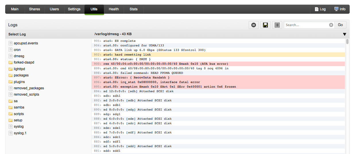

Loving this enhancement thus far only complaint / suggestion is lack for pretty colours in the syslog so a nub like me can easily spot errors and things of not in the logs  ;D
Like this?
Your the man!  ;D
yeah lol where be that part lol I really should explore more before I post and make myself look like a fool  ;D
