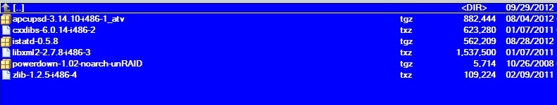

Also, while trying to clean things up a bit (see the plugins I'm using in my Sig), I noticed the following in my /boot/packages/  folder (see attached picture)
Given I do run the APC and iStat plugins, I assume the plugin files are downloading the other stuff into my packages folder, like Powerdown, zlib, and cxxlibs.  Or, those could be left over from my old setup (which my friend helped me setup).  Bottom line, is any of that stuff old and can be safely deleted?
The folder "/boot/config/email/" can be safely removed, it is not used anymore in SF-1.0.5
SF-1.0.5 does not install anything in "/boot/packages". Unused files in this folder you can remove too.
