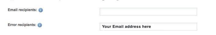

With the email plugin i now get spammed every hour with "unraid is Ok".
Is is possible to change this behavior to just send hourly mails when there is an error of some sort?
I'm actually only interested when something goes wrong.
Haven't found it if it was possible.
To lengthen the interval, change the value of 'Email Frequency' (unit is minutes) on the EmailNotifications page.
Sorry, I haven't found a way to have it only send e-mail when something goes wrong.  (Luckily, I am not even sure if it does send an e-mail on an error condition.  ::)  )
See screenshot attached - this is how you make it send only errors.

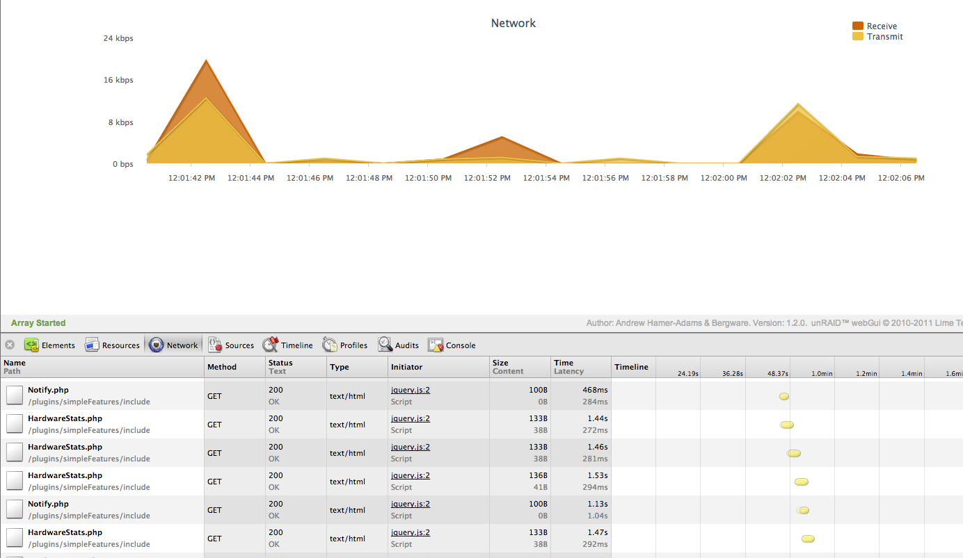

Does anyone get anything in the graphs when using the real time option in the system stats? All my graphs remain empty.
Yes  8)
What browser are you using?
Chrome.
Here is a screenshot:
OK - if you open that page, right click and select "Inspect Element". Click on the network tab, and see if you're getting any responses for HardwareStats.php. If you are, click on one of them and see what result you get. Screenshot included.
