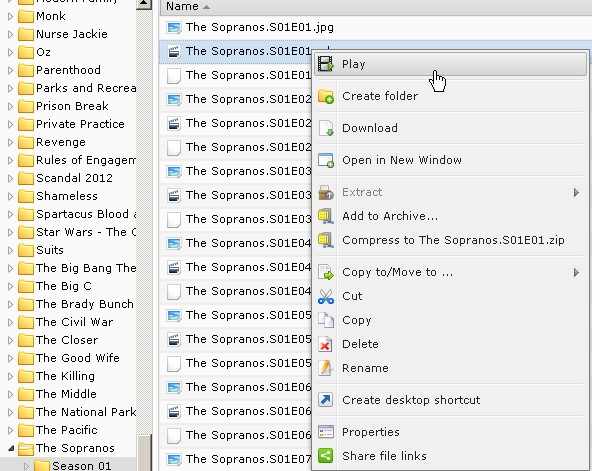

.....I start to wonder when is too much? A lot of unraid systems run on minimal hardware and having so much stuff running may not give unraid to perform its best. The only thing that started to make me think of this was is I saw the poll at the top of the page and what is popular now is a music/movie indexer manager? NO NO NO, we don't want to take Simple Features into that direction. .
Separate package as mentioned.  Regardless, a file manager would use very little CPU/memory. The movie "viewer" I'd guess is secondary; yet again optional to use, and relatively light on resources.
I have only used it once or twice, but Synology has an option to "playback" a movie from the file manager.  It basically opens up vlc in a browser on the client..no transcoding involved, which reduces the CPU requirement.
