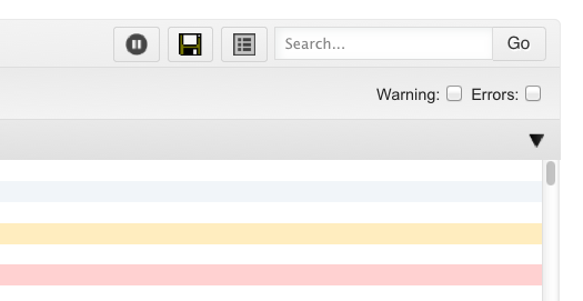

The new Log feature looks nice! Some small points from me too:
1) I agree that the font used for the log is very small and with quite much whitespace. Must a "courier" type font be used? Could you use a sans-serif font instead?
2) I also agree that I would like to see an option to sort both ways
3) If you search for something with the search box, the only way to reset it is to clear the text in the box and "go" again. Maybe a clear icon?
4) Maybe an option to filter only Info messages as well?
5) What about an option to filter on process? Aka "show only emhttp" or "show only kernel"?
6) Is there a reason that the window is fixed in height and not using the whole screen?
Keep up the good work!
New version will have decreased the size of the padding, and increased font size. I'm using the <pre> tag, which means that each character is a set width. I have no control over the font used, but presume that log integrity and visibility is more important than a nicer looking font?
I'll look into dynamic window heights and additional filters at a later stage  :)

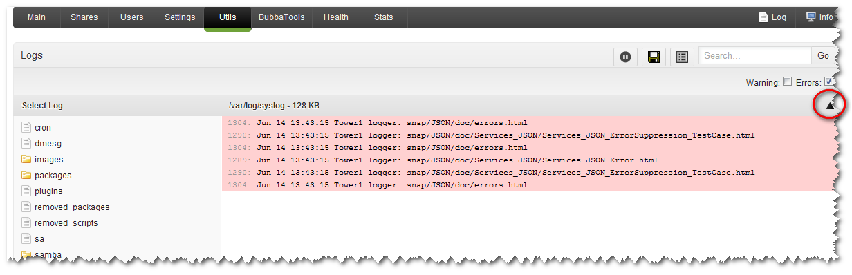

When I test this now and click the sort arrow, it lists entries more than once - see attachment

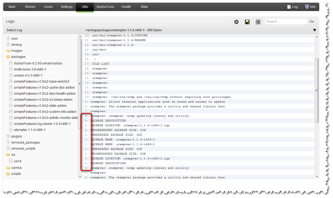

And here is some more strange listings. I clicked to open the Logviewer, then clicked to view a logfile and see, its listed from last line down to one and then back up again. (See image)

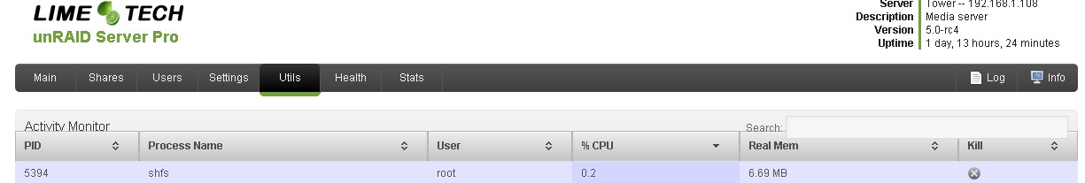

Minor Format Bug: Overlay of the Activity Monitor Columns. See attached.
