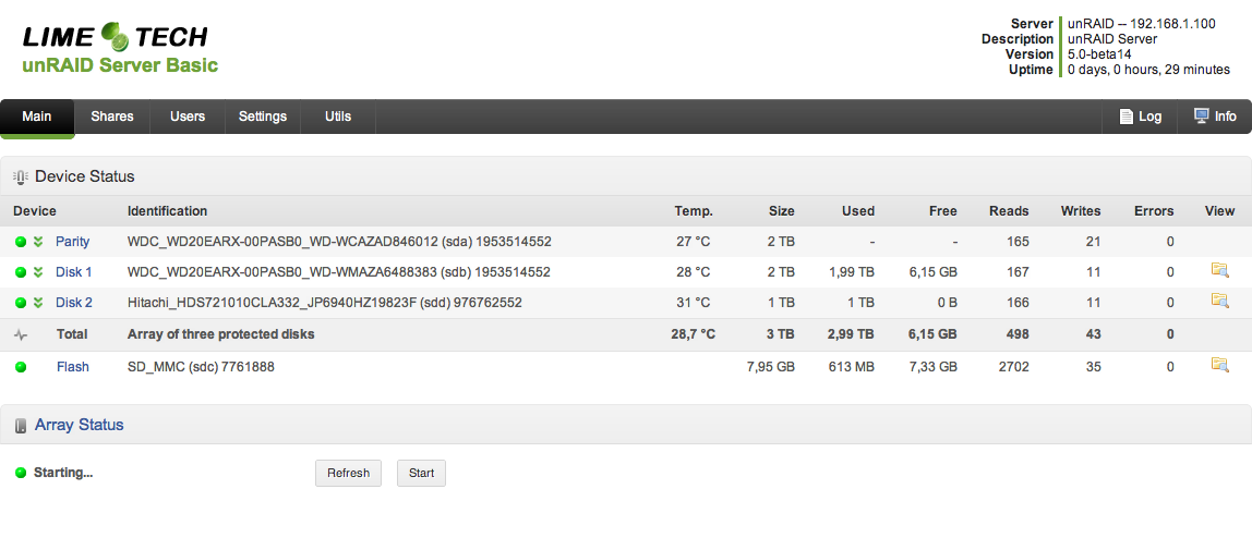

Ive just noticed a little bug, its nothing major and has probably been brought to up but i thought i would just put it forward.
Issue:
When starting the array only the refresh button is visible and not start, which is correct. However if you hit info or the logs button which then provides a pop up. Once you have closed it the Start button suddenly becomes visible as if you could hit it again, to start and already starting array.
Screenshot attached
