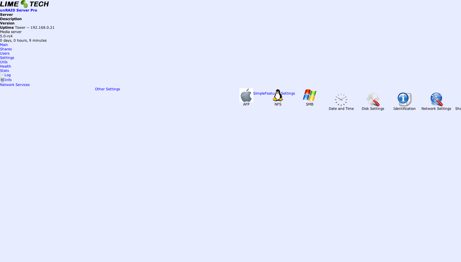

Just loaded again as something was locking up webgui. When I pull it up in chrome on mac I get a weird unformatted gui. Works fine with firefox and safari and IE on a pc.
See photo
Reset cache in Chrome, or refresh the page a few times.
