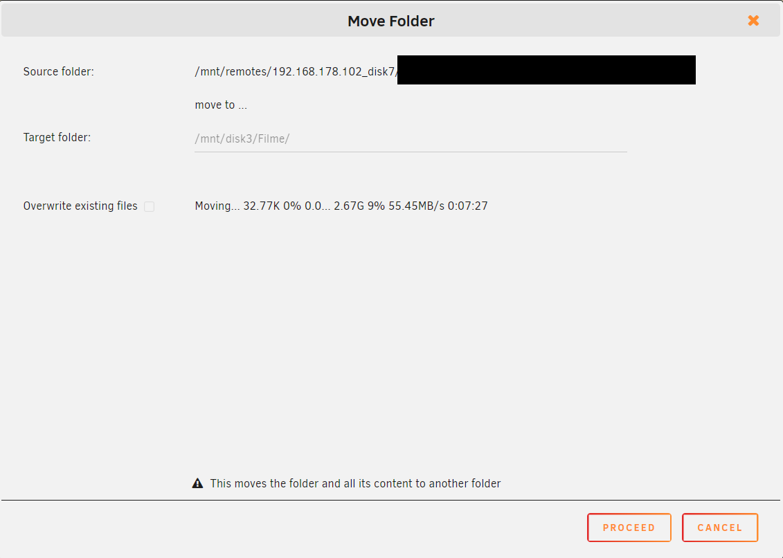

Hmm, is this working as designed? The "Proceed" button is still available during a running "Move"?
And one more stupid question: What happens if I close the dialog during a running job?
Thanks for your support.
Yes, the "Proceed" button is still visible but disabled. Nothing will happen when you press it again.
Clicking on 'X' closes the dialog and allows the user to navigate in the GUI as normal, the running operation continues in the background (even when the browser is closed).
When the user revisits the File Manager it will re-open the dialog with the current status. This even works when the File Manager is opened on a different PC/browser.
Clicking on 'Cancel' terminates the running operation, keep in mind that this may leave an incomplete operation. E.g. canceling a move operation half way will result in some files being moved but not all.

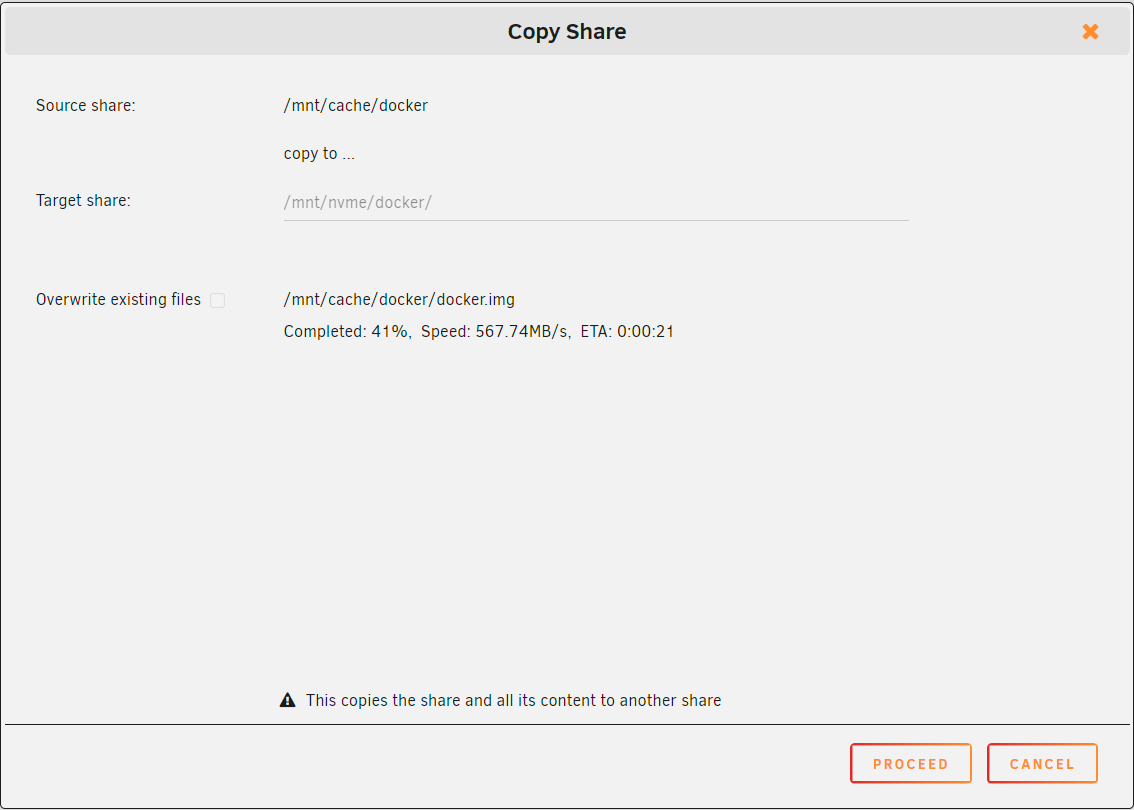

When a long Move or Copy operation is in progress, it should display the name of the files on the first line and the progress on the second line. Like this:
Are you using the latest version 2022.03.19g?
Nevermind - I see this is a bug in the Move operation. Need to make a correction.
Made a correction for the progress indicator when using Move operations. Version 2022.03.21 is now available.
