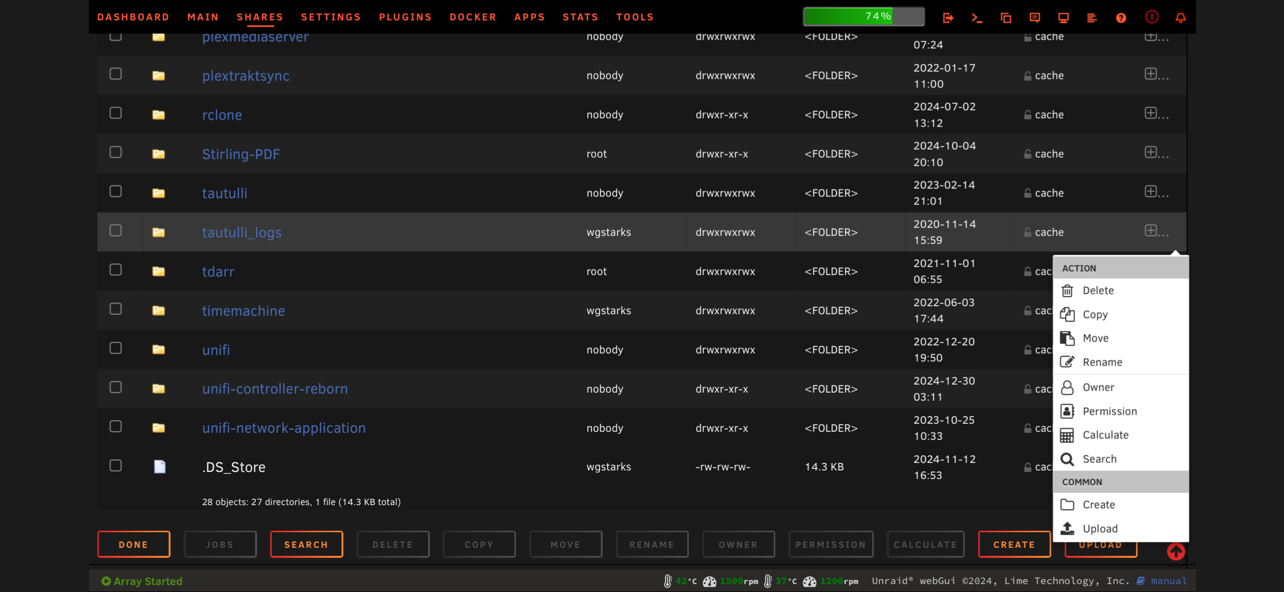

8 minutes ago, Mark Snop said:
I just installed UnRaid so complete newbie. I installed the File Manager but I dont see how to access it?
The bulk actions menu on the bottom as well as the actions menu on the right (click the + sign).

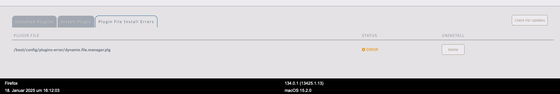

Hi, how about an update of the plugin for version 7.x, unfortunately it does not work with unraid version 7:
V7 doesn't need the plugin, it is built-in. You should just remove the plugin.
