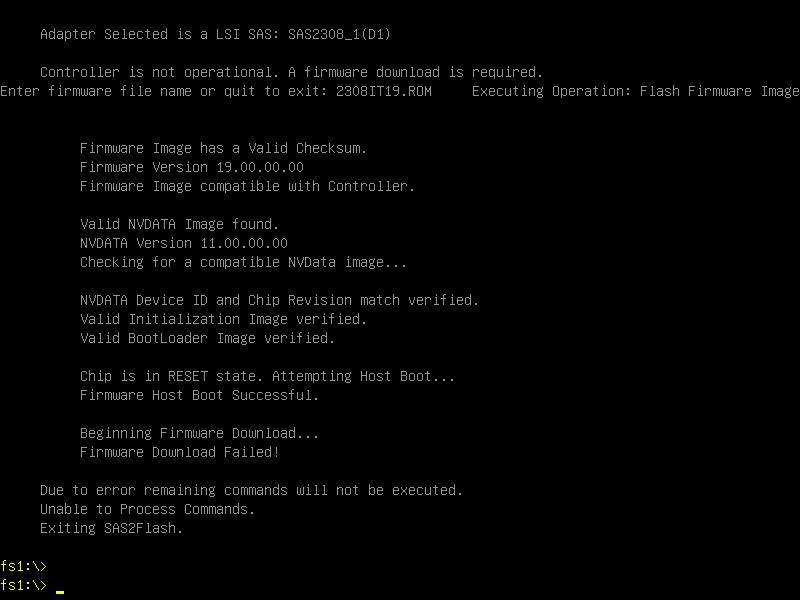

I have a SuperMicro X10SL7-F with an onboard LSI 2308 that I can't get operational. I think it may have been defective since I purchased board over 12 months ago, but I just attempted to expand array and can't seem to get any of the onboard ports for this controller to work.
I've been at it off and on for a couple weeks and I think I've been doing everything correctly. I've followed all instructions to flash it w/ the v19 firmware into IT mode but this is the error I keep getting.
Any thoughts would be appreciated.
Try these...
- flash on another mainboard
- flash P11 first (with p11 flash command!), then, eventually, go with P19/20...
It could be bad anyway...  :(
If I understand correctly, he is talking about an onboard controller!
It will be quite a challenge to plug it into another board... ;D
