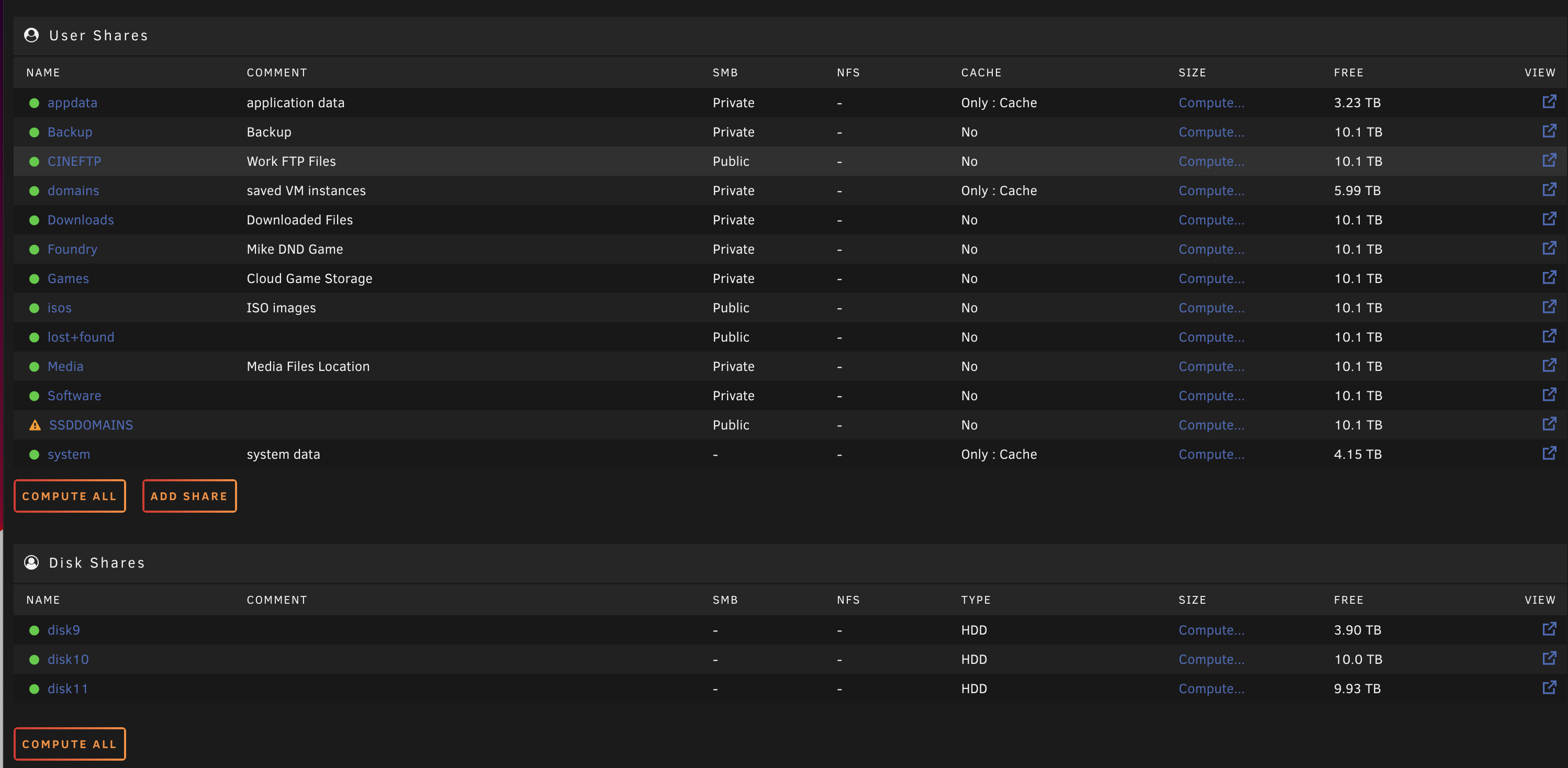

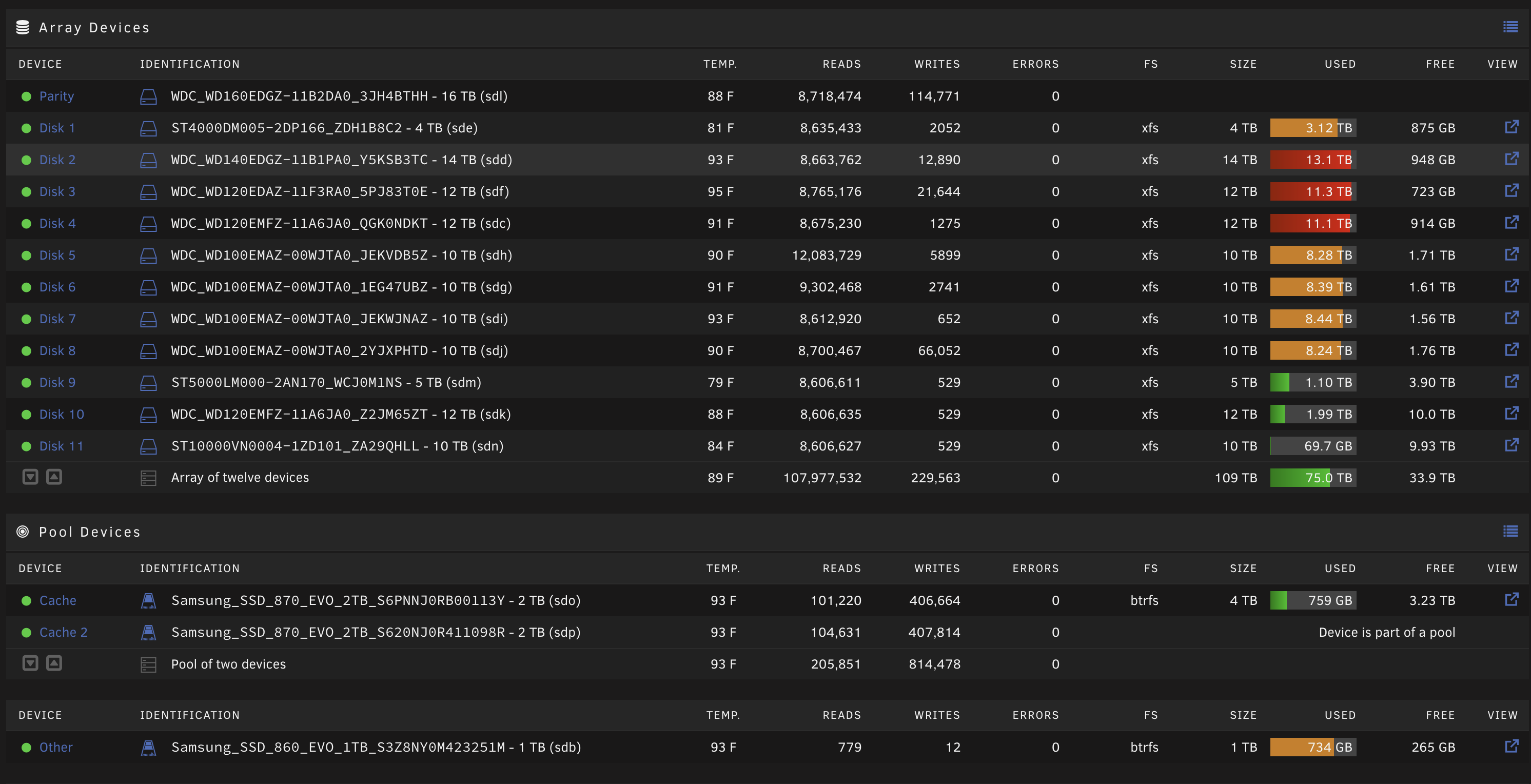

I am in some need of help from my logs i am not seeing any issues but i am having a issue with unraid and docker it will stop working and the fix common problems will tell me it is Read Only but my drives are not Full.
I have deleted my Docker Image
I have verify all the shares are set to high water
i am adding two diag and a few photo of the disk and shares showing free space

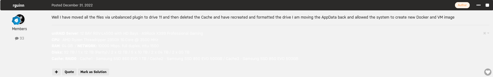

Well I have moved all the files via unbalanced plugin to drive 11 and then deleted the Cache and have recreated and formatted the drive I am moving the AppData back and allowed the system to create new Docker and VM image
