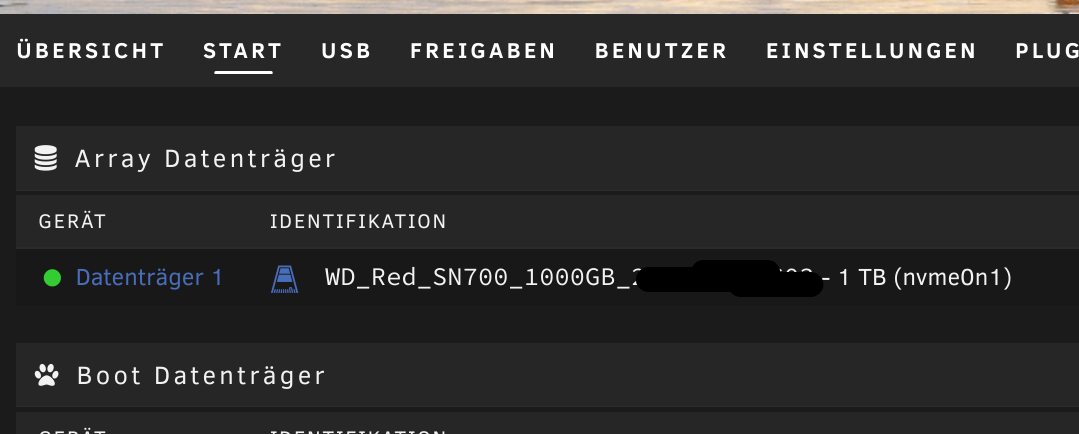

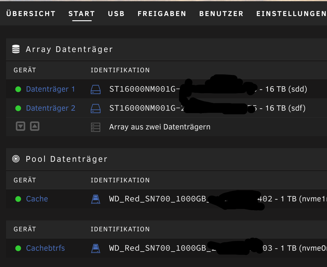

Not Working:
Working:
21 minutes ago, Frank1940 said:
You have not put this server into a Active Directory setup?
No, Default Workgroup Mode.
Looking at the screen captures, it appears that there are two servers. SMB works on second server and SMB does not work on the first server.  Is this correct?  Or you you just changing the configuration of the installed hardware on a single box and using the same Unraid boot drive?
Yes, its the same Server with the same Boot Drive. I used the New Configuration Tool under Tools for the Change.
Yes, SMB.... Works on My Backup Server. But there is not on the Screenshots....

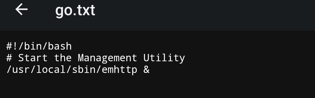

Are you running any scripts in the go file?  (Found in the    /config    directory of the flash Drive.)
27 minutes ago, Frank1940 said:
I would also suggest that you go to   Settings    >>>>  Docker   and set  'Enable Docker:' to "No".  Then reboot again to the Safe Mode.
Yes, Docker and VM are deactivated before Boot in Safe Mode.
No, I don't entry there.Screenshot_20230303-232001_HTML-Anzeige.thumb.png.f16d0c5d7a5d86806c45fa3f526231f7.png
