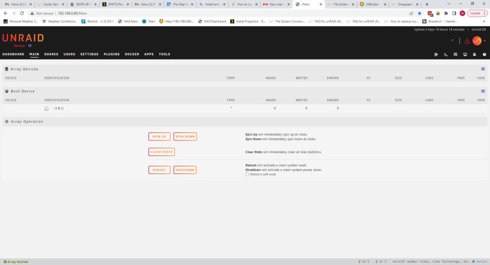

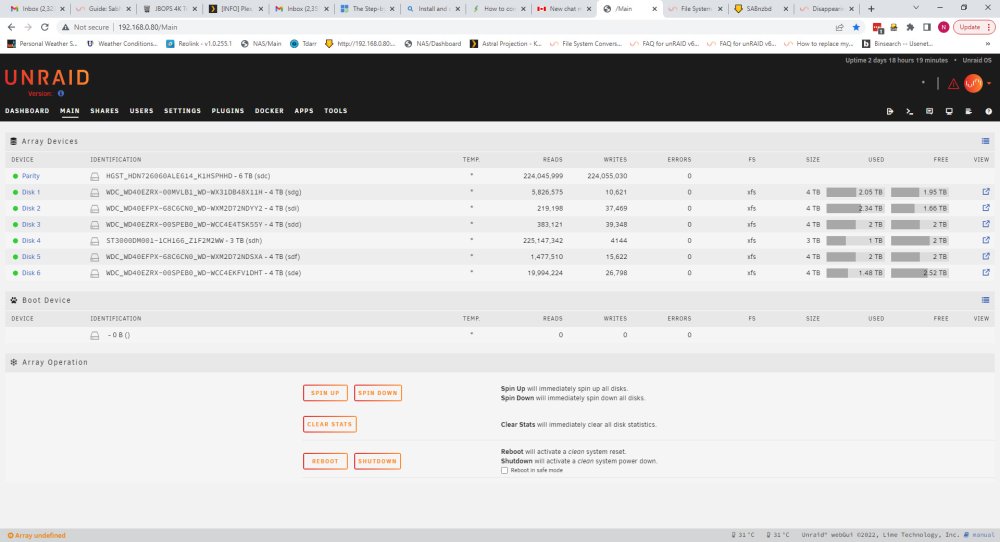

Hi everyone,
Little nervous given the topics of the forums that I've found from searching, especially the one starting with "TL;DR  If you're seeing constant logs from avahi-daemon, beware, you probably got hacked."

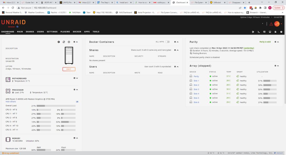

What has happened recently:
  • For the past few months I've had random crashes where unraidos would freeze up, I thought it was because of my build as well as docker containers, etc but none of it has stopped it. I've disabled C-States, locked docker containers to the core, altered the power idling, and I still have random crashes ranging from 1 day to 3 months (increasing more recently)
  • Starting today I've had logs spamming my syslog from avahi-daemon and that lead me on a search to the attached forum posts
  • I checked my ifconfig and I've found a bunch of Network Interfaces I've never seen before (I'm used to eth0, lo, wgo, and br0. I had a bond0, and multiple br-XXXXXXX
  • I've had issues connecting to my server VIA WireGuard and Tailscale. I was able to a few weeks ago but I tried this morning and no connection.
  • I was unable to ping anything, hostnames (google.com) or numerical lookup of google (142.250.68.110)
  • Docker Community Apps throws an error saying it can't retrieve a feed
  • Common Fix and Problems reports that it can't connect to github.com
  • Recently got alerts from my "Deco" app, which notifies my whenever a new device joins the network and I've been getting a few "UNKNOWN DEVICE HAS JOINED THE NETWORK". This pops up from time to time so never thought about it till now.
Exposure of UnraidOS server (192.168.68.114):
  • Port Forwardings
    • 192.168.68.114 (UnraidOS Server) Internal: 6881 External: 6881 (nothing running on that port)
    • 192.168.68.114 (UnraidOS Server) Internal: 51820 External: 51820 (Wireguard VPN Service)
    • 192.168.68.48 (Nginx) Internal: 8080 External: 80 (Nginx Proxy Manager)
    • 192.168.68.48 (Nginx) Internal: 4443 External: 443(Nginx Proxy Manager)
  • Nginx Proxy Manager
    • All of my docker containers are on br0 and all have static IPs assigned to them, and then I do routing of services I want to expose outside (like Jellyfin, or Gitea, etc) of my network. All have SSL certs
  • I have numerous shares on my network and they all require a username and password to access
Only recently starting working on my UnraidOS instance again last couple days. For the most part I leave it alone, but one of the things I wanted to do was create VLANs either at the Router level, Unraid Level, or Software level so I enabled Virtual Machines and installed the stock CentOS iso to play around with. I've made some VLANs VIA Unraid and also tried to do some VIA my router but none of it has worked so I've kind of reversed whatever I did.
Please any advice would be appreciated, my server crashed at 3AM this morning so I had to do an unclean shutdown so my parity is currently rebuilding.

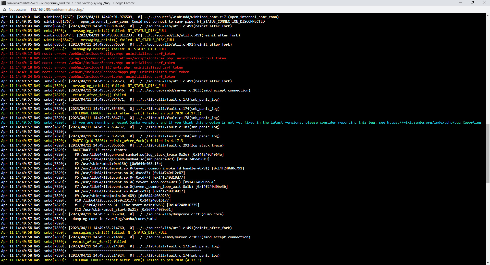

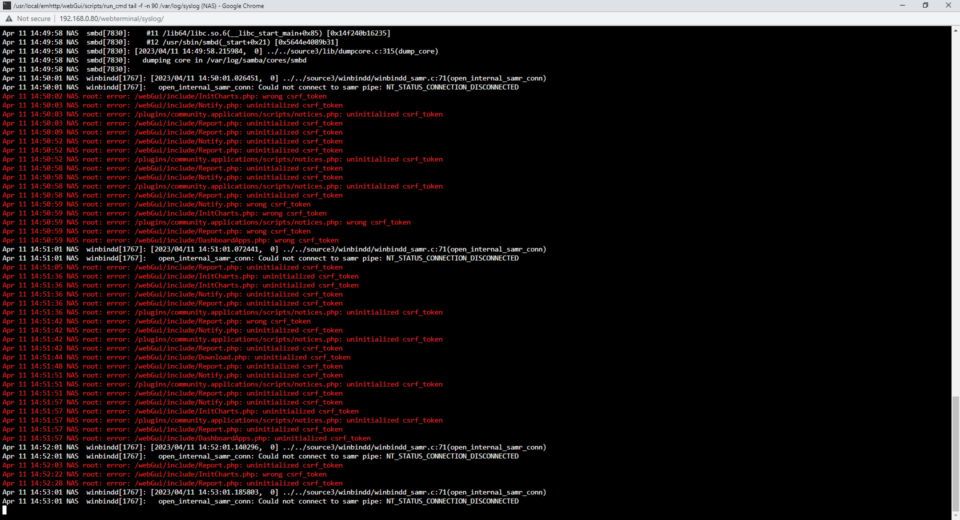

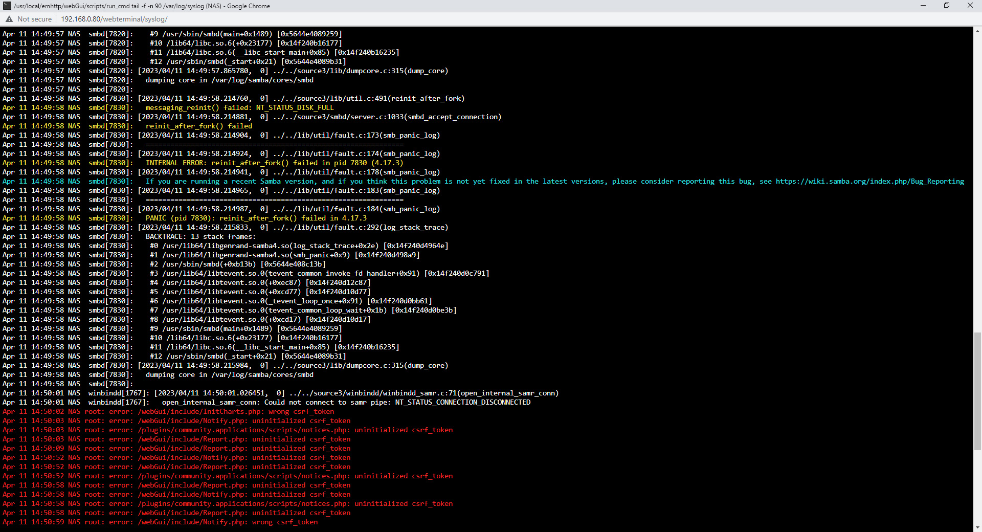

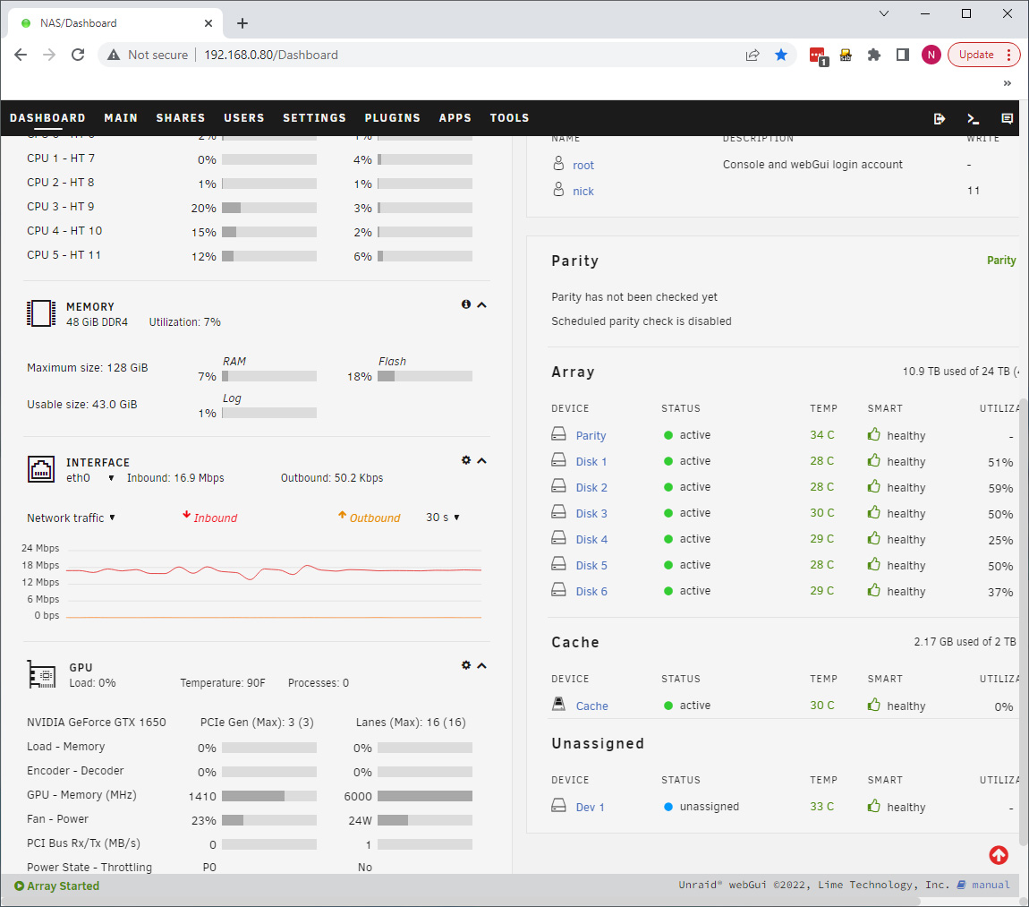

My logs are having this problem. Found my memory use at 70% (it usually rides around 20%).

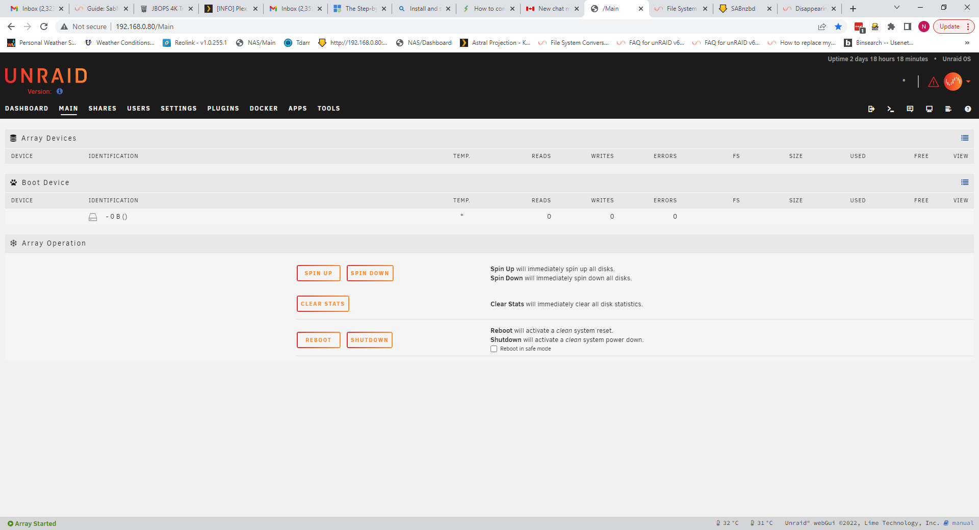

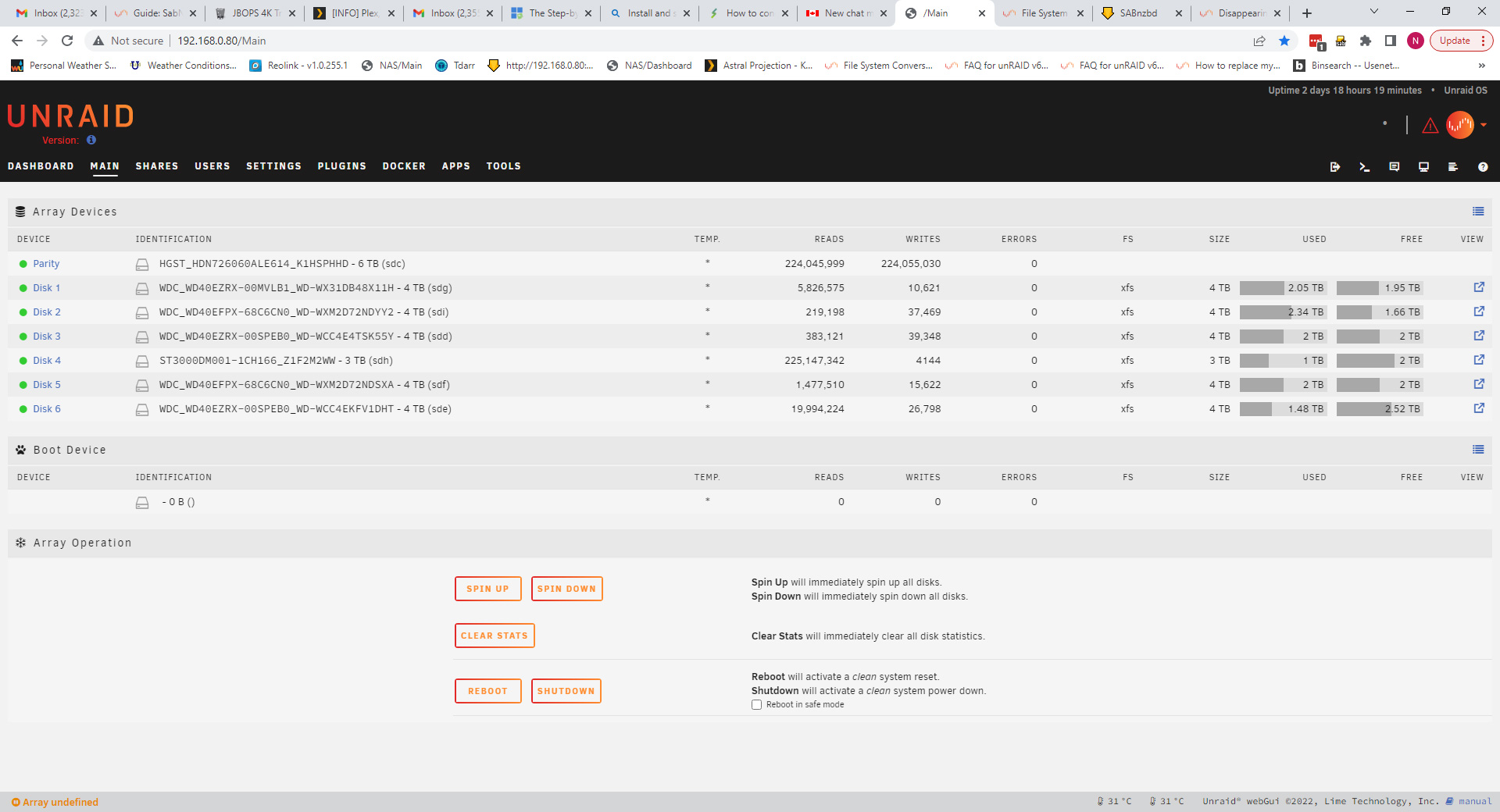

Also today I observed the webgui flying through screens in main and dashboard that showed the array, then it would flip to zero drives, then some drives unmounted, then no drives, then the network name changed and the system log just kept filling up with the avahi-daemon.
Ended up unplugging the network cable while I plan my next steps.

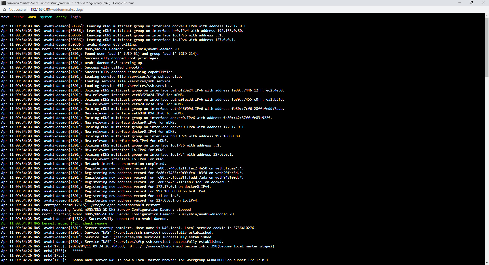

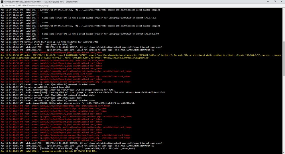

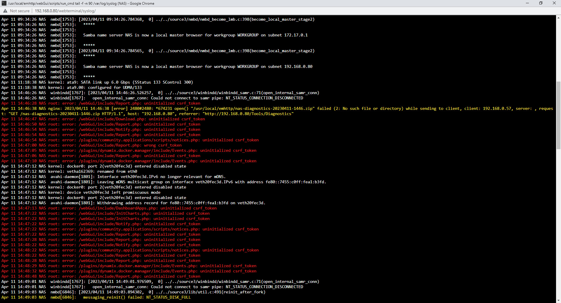

Reading the system log shows the avahi-daemon starts ssh, ftp and samba, puts fix common problems on hold for 10 minutes and then sets up it's eth0 bridges across docker's and then goes to work silently doing whatever it wants.
It creates a user0 share with access to all my internal shares.
What have I done lately? I installed Plex media server - totally scanned all my media and no problems there.
Installed tdarr and it's node and no issues there.
Installed radarr and didn't complete setup. Since these issues started i have since deleted Radarr.
Installed sabnzbd and it ran fine, but it needed permissions for docker to be reset, which I did.
I noticed today I could only get 5mb/s down instead of the usual 200mb/s.
That's when I saw the memory usage high and the syslog issues.
I went into global settings and disabled ssh and ftp and that stopped the script momentarily. There was a temp account in my user account fields that I deleted, but after reboot it was back.

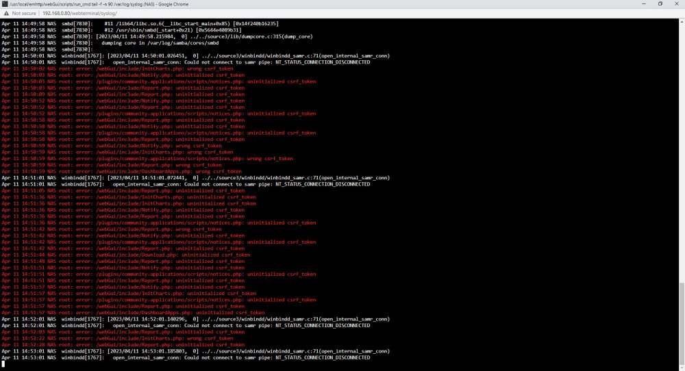

I've got full system logs and screen caps of the weird browser functionality.
As of right now, the machine is off, pulled the network cable and unplugged the USB boot drive. I looked in diagnostic logs from Feb 20 and it has the avahi-daemon there but not nearly as much activity as today. 🤔

If you would like help from the community we will need to see logs and settings. The next time you boot the system, wait for the problems to happen then generate a diagnostics.zip file (from Tools -> Diagnostics or by typing "diagnostics" via SSH) and upload the zip file here.
The diagnostics does not include your list of users, so go ahead and post /etc/passwd as well so we can look for anything out of the ordinary.
When it last happened I couldn't create a diagnostics.zip file. The system wouldn't let me. It all wigged out with the webpage being unavailable. Examples below. At the same time the syslog filled up with errors. Also attached below. The copy of the system log that I included pictures for is included as a text file called "nas hacked.txt".
Eventually, after the system became stable again, I was able to pull the diagnostic file.
I only later saw the added logins/passwords after the fact when I had pulled internet from the unraid box. I'll have to copy those off another computer as they're not on here.
Interested on your thoughts about what I experienced. Thank you for the help.
nas-diagnostics-20230411-1513.zip nas hacked.txt
Edited by xjumper84
added one more screen cap

What do you make of the drives/array disappearing? I wasn't doing anything with the machine to warrant such a display of action.
Or samba going up and down with network configs changing constantly.
It all seems weird and not normal. I've been an Unraid user for more than a decade and have NEVER seen Unraid act this way. Just because I don't post in the forums doesn't make me a noob to the software.
The screenshots show a line that says:
nmbd: messaging_reinit() failed: NT_STATUS_DISK_FULL
A full root filesystem can mess up all kinds of things. I would guess that whatever caused that is the source of the weirdness you were seeing. Unfortunately I don't see anything here that can tell us why it got full.

So the weird continues... ssh and sftp are disabled. as are dockers and vm's
For the life of me I can't get Community Apps to load as it says there is no internet on the machine. But when I go into terminal I can ping github.com, google and everything responds as normal.
While on the dashboard it shows my network traffic to the machine is a consistent 17.4mbps, netstat doesn't provide any helpful data (it only lists my desktop as being connected to it), the network traffic on my windows 10 desktop is nothing and its definitely not sending it any data.
I added unassigned.devices to clear the nvme drive earlier. Now it says its mounting remote shares, but in the webgui i see nothing.
Lastly, the time on the machine is fine, it shows correctly in the bios. Any help would be good.
This is the latest system log:
Apr 25 16:18:56 NAS  avahi-dnsconfd[4059]: Successfully connected to Avahi daemon.
Apr 25 16:18:56 NAS  emhttpd: nothing to sync
Apr 25 16:18:56 NAS unassigned.devices: Mounting 'Auto Mount' Remote Shares...
Apr 25 16:18:57 NAS  avahi-daemon[4050]: Server startup complete. Host name is NAS.local. Local service cookie is 2735995368.
Apr 25 16:18:58 NAS  avahi-daemon[4050]: Service "NAS" (/services/ssh.service) successfully established.
Apr 25 16:18:58 NAS  avahi-daemon[4050]: Service "NAS" (/services/smb.service) successfully established.
Apr 25 16:18:58 NAS  avahi-daemon[4050]: Service "NAS" (/services/sftp-ssh.service) successfully established.
Apr 25 16:19:01 NAS unassigned.devices: Using Gateway '192.168.0.1' to Ping Remote Shares.
Apr 25 16:21:48 NAS nginx: 2023/04/25 16:21:48 [error] 3540#3540: nchan: A message from the past has just been published. Unless the system time has been adjusted, this should never happen.
Apr 25 16:24:18 NAS kernel: kvm_arch_init: 2 callbacks suppressed
Apr 25 16:24:18 NAS kernel: kvm: support for 'kvm_amd' disabled by bios
Apr 25 16:27:42 NAS  ntpd[1396]: kernel reports TIME_ERROR: 0x41: Clock Unsynchronized
Apr 25 16:28:00 NAS root: Fix Common Problems Version 2023.03.22
Apr 25 16:30:00 NAS root: Fix Common Problems: Error: Unable to communicate with GitHub.com
Apr 25 16:30:00 NAS root: Fix Common Problems: Other Warning: Could not check for blacklisted plugins
Apr 25 16:30:02 NAS root: Fix Common Problems: Other Warning: Could not perform unknown plugins installed checks
nas-diagnostics-20230425-1626.zip
