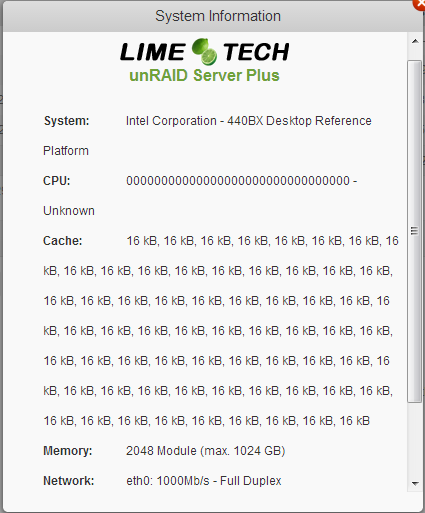

I don't know if this has been mentioned before, i can't fin it anywhere on the forum.
Anyway, when using the new unraid GUI (or simplefeatures before) the system information screen shows some weird results.
I have added a screenshot to clarify.
My other vm's containing windows for example do a good job of getting the correct info through from ESXi.
Is there a solution so this become's a bit more tidy?
Also lm-sensors does not find any sensors, can this be worked around too?
*edit: forgot attachment :)
