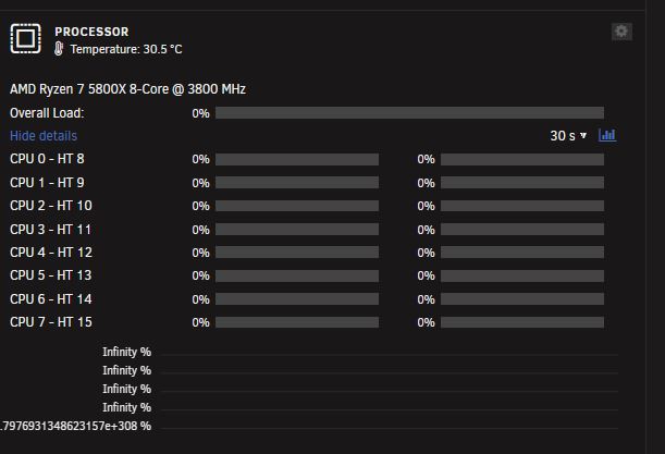

why does unraid hang at udev boot and so slow and then cpu infinity
so id like to know why unraid is super slow when boots up.. it hangs at a udev  part and another part  i couldnt take a pic of it
also  cpu usage is infinity...  is there anything in logs showing why its hanging  so much and why i get this infinity

and does the inifninty  mean it cant read the cpu?
as i know it can read my 3700x  as it doesnt have this issue

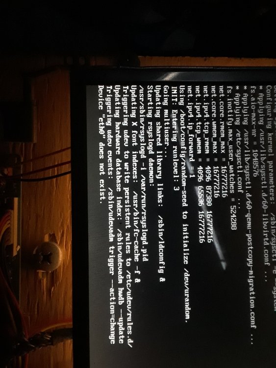

booted up...  i forgot to plug in keyboard so i didnt do the gui

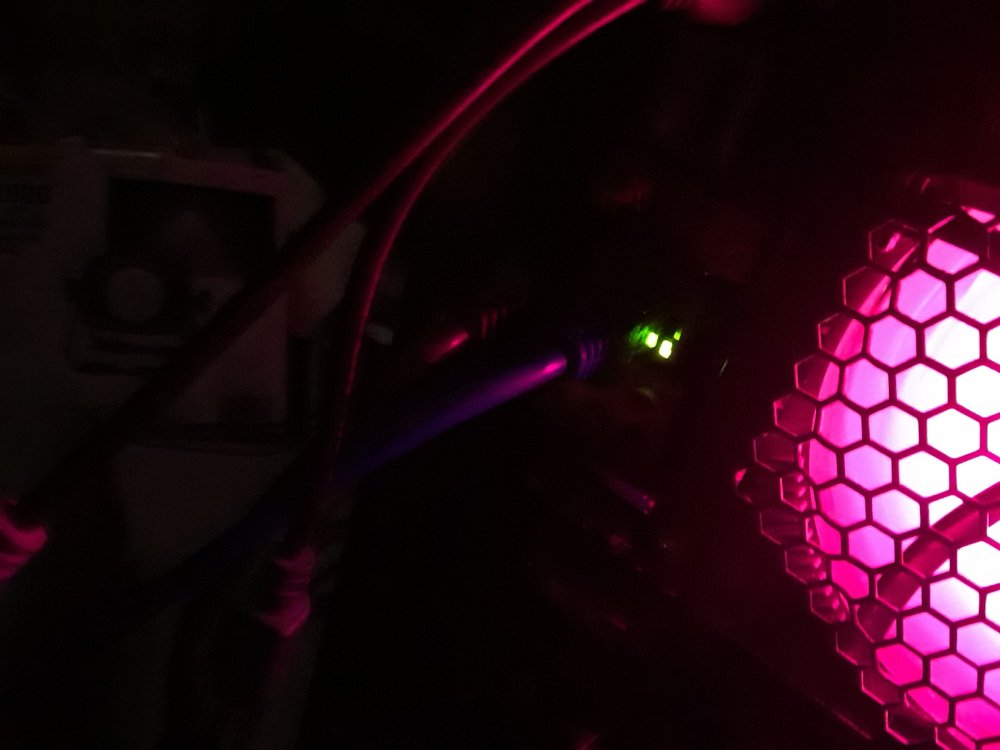

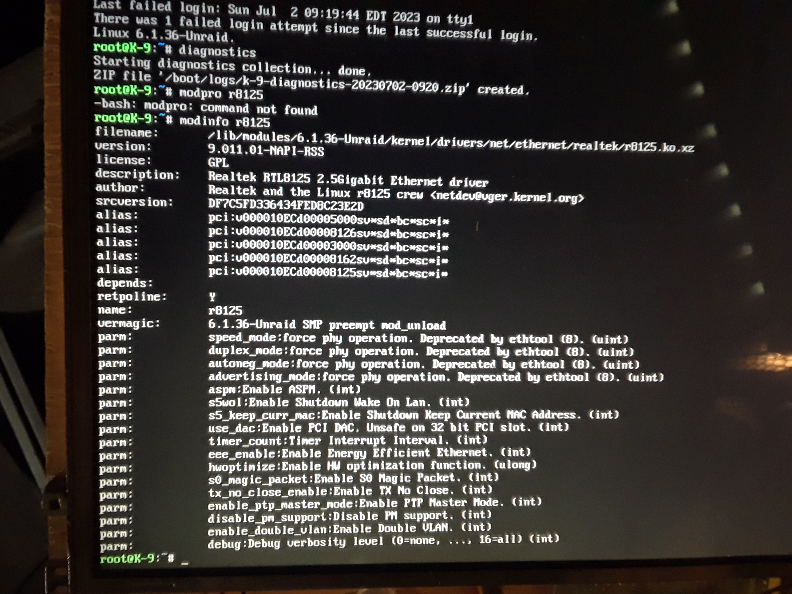

but i did log in did a diganostics and i did a couple screen shots... and the network card did work before as i never upluged it and the lights are flickering once power comes on

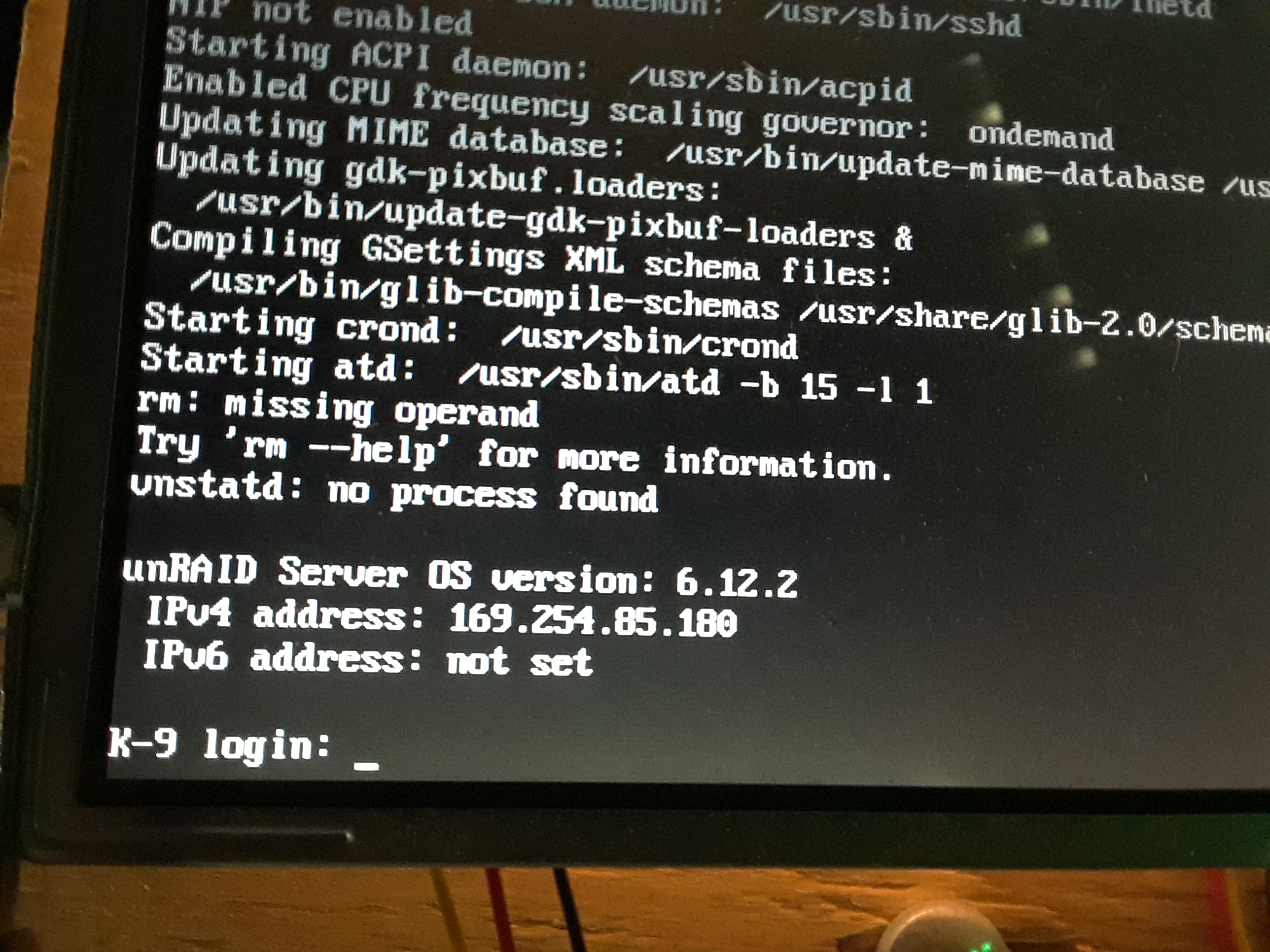

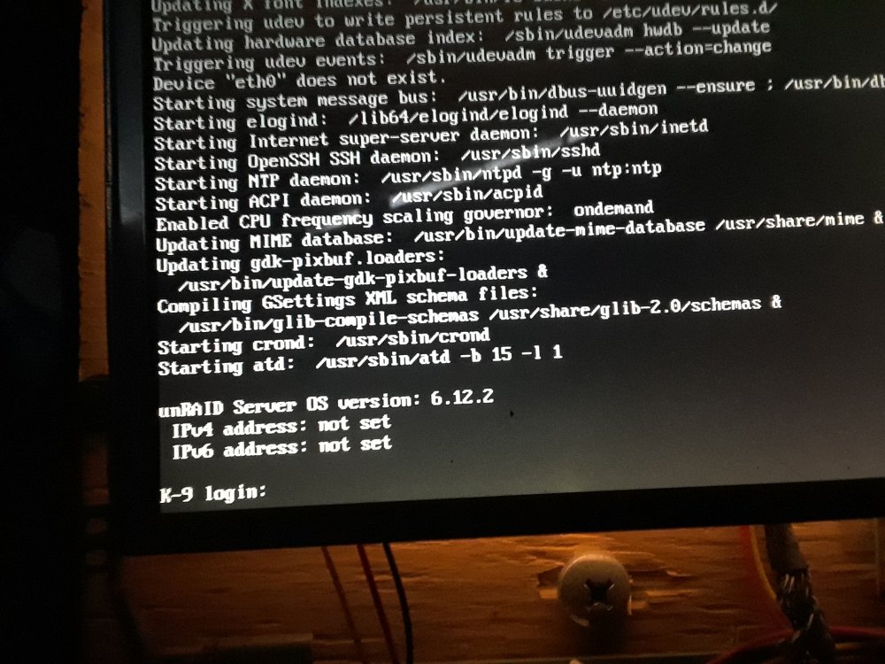

but here i did cell phone capture of the screen hope its good enough

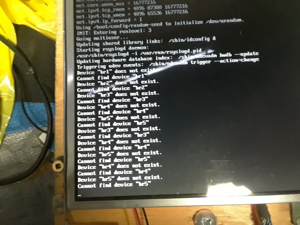

and on this sever it hangs on the "RM" command whatever it does    but it booted up ok..
if you need me to go back into the gui mode one i will.. i just didnt when i did all these tests
just the orginal boot
and i dont have the vid card back in main server to test.. but i do know it hangs at the "MV" command and "udev"  command    sits like 5 min it seems and i not sure if those releated to the network card?    i dunno if that shows those errors in the diganostics  i only seen it on the screen
but hope these screen shots help  if you need me to go into the gui i can

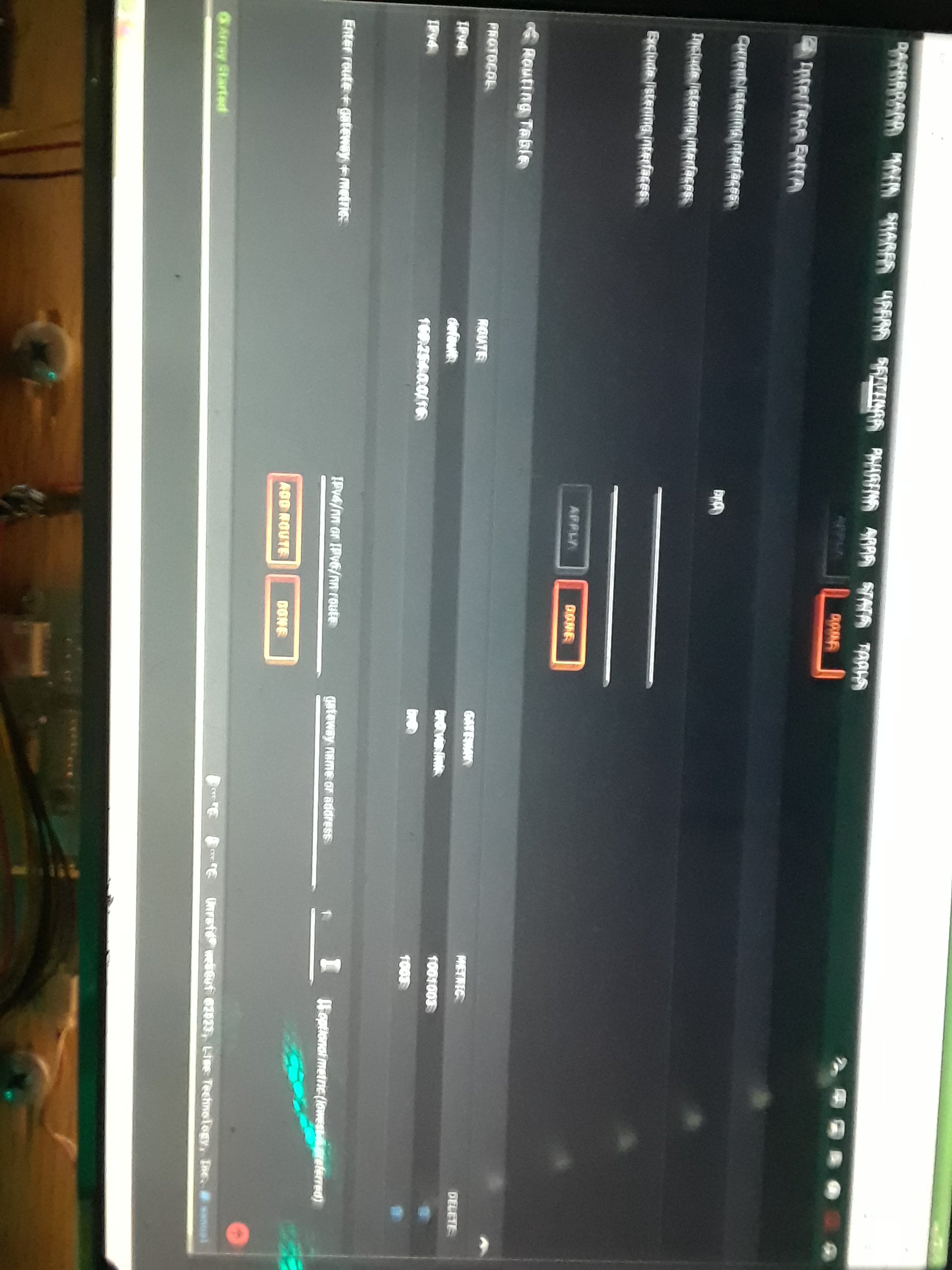

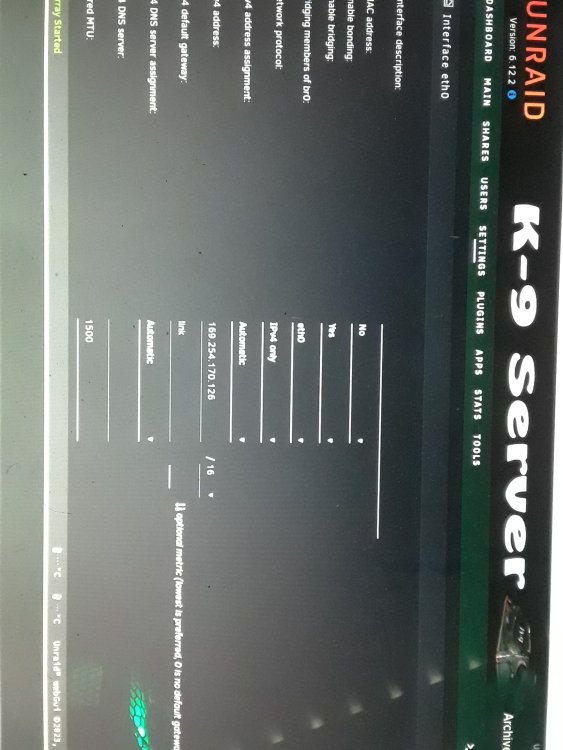

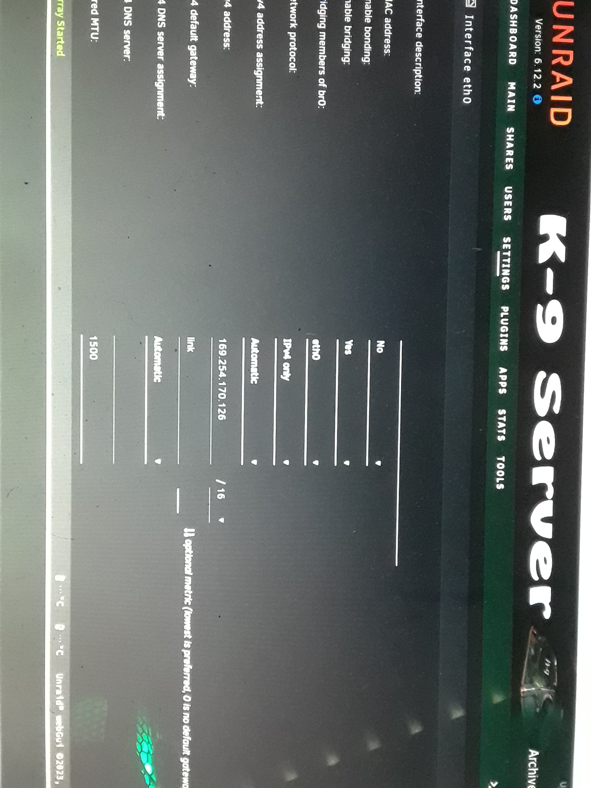

ill reboot and check  if the network card is there i re read what you wrote.. damn disylexia...   ill check if the network card is there
update:
sorry about that  i miss read so i went and did what you said and went to settings.. i guess the network card is gone
dont know why these photos side ways
Edited by comet424

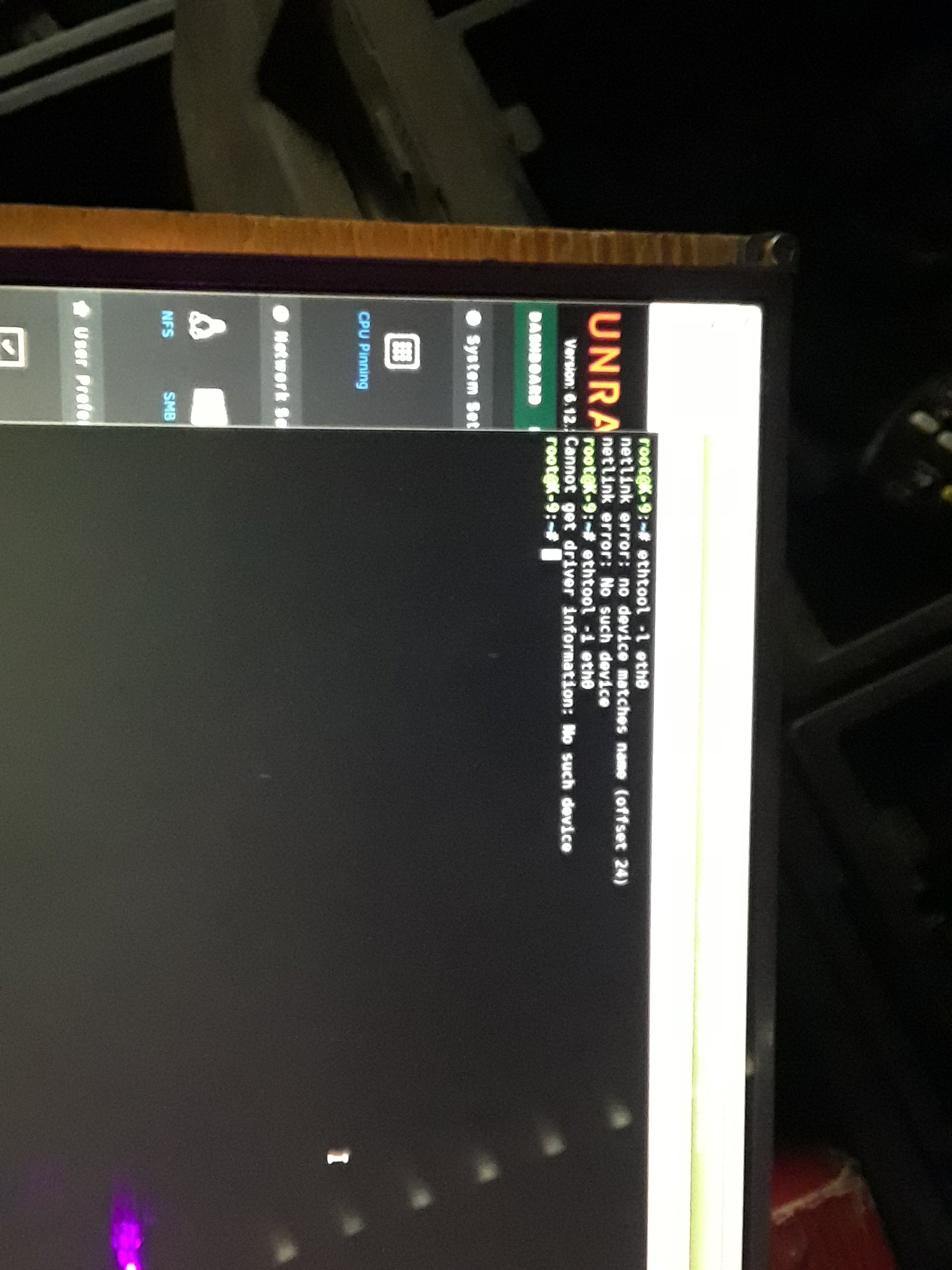

@comet424 It looks like the driver is running since there is information in "modinfo r8125".

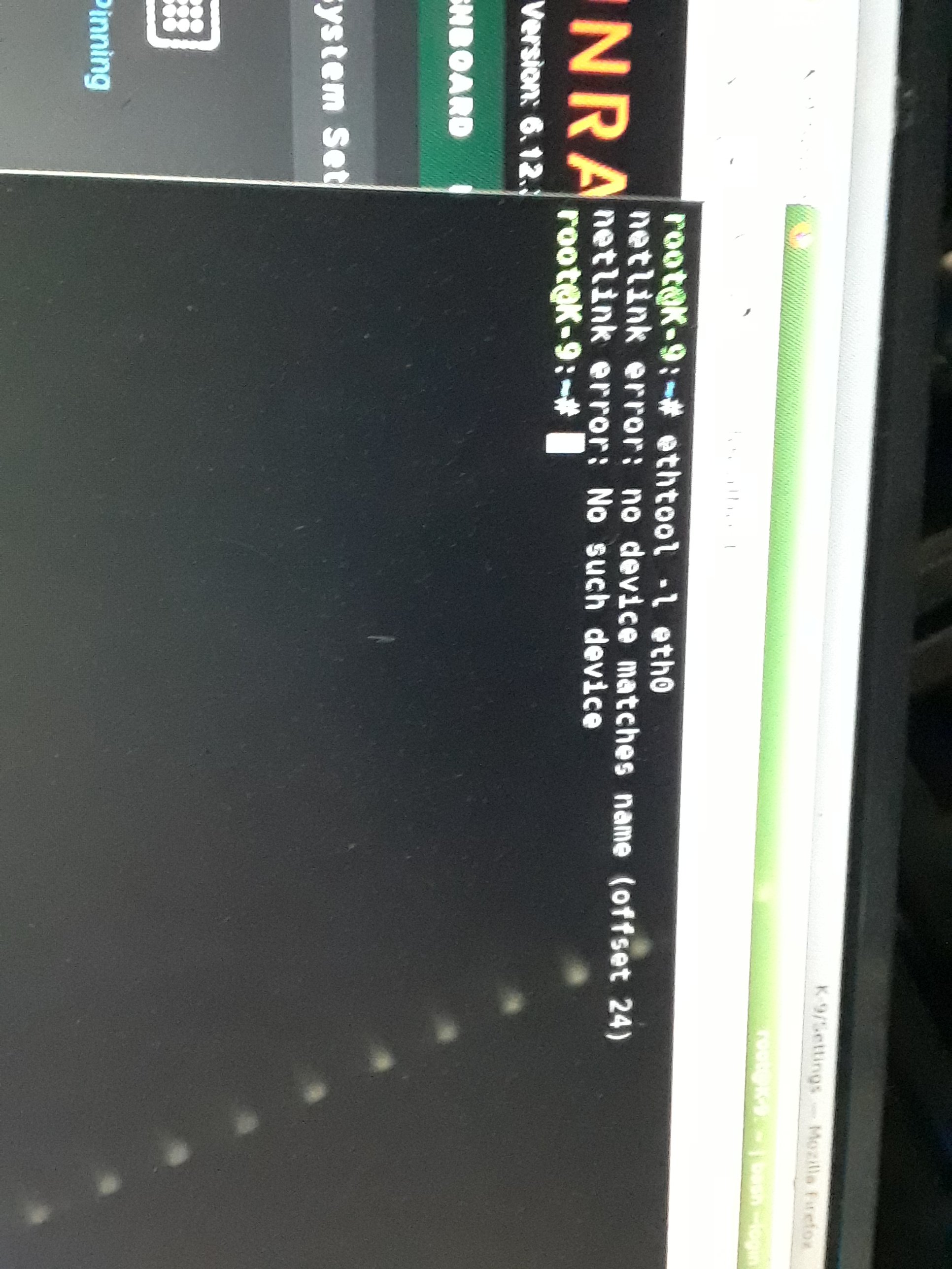

Do you have only 1 ethernet port? The eth0 seems don't have the MAC address. It is strange. Is it the r8125 chip ethenet port? Could you please try command "ethtool -i eth0" to see whether the driver is working?
@jinlife

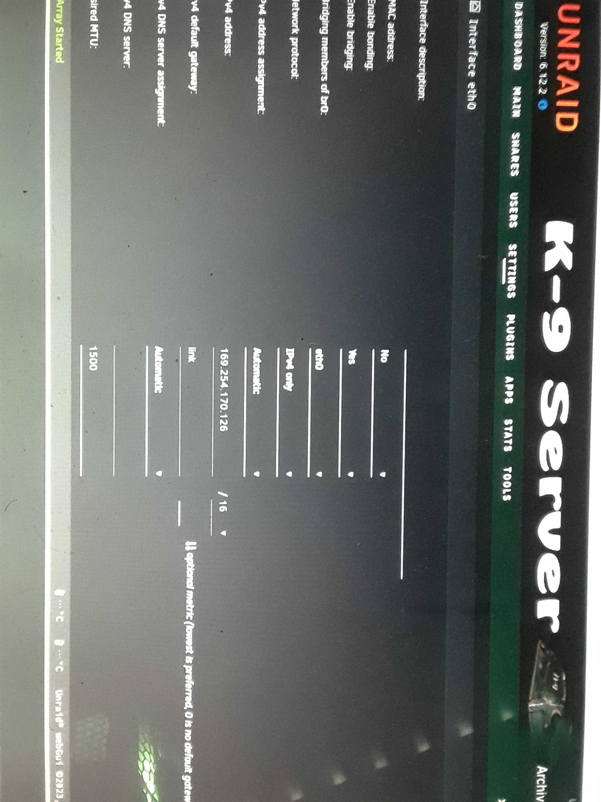

and looks like the ethernet port is gone...  but it still lit up on the back of the comp
i re did it i thought it was L  not an I  for the attributes
here is another screen shot
Edited by comet424
It seems your network card chip in k9 is RTL8168h/8111h, it should be drive properly by R8169 driver.
R8125 plugin is unnessesary, I guess there is something else wrong in the system.
