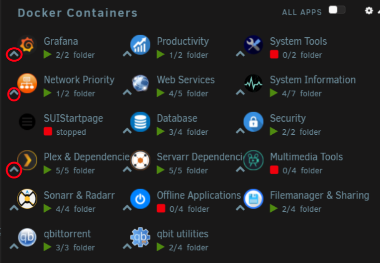

Is it possible to have these in Folder View?
@ProphetSe7en You can use CSS to do things like this:
Reading your post again, I think what you want is the little chevron icons on the Docker tab?

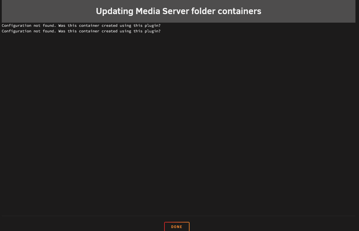

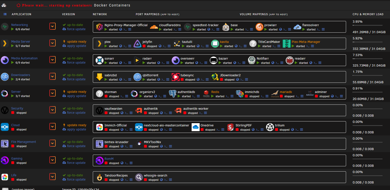

I've just woken up and seen an issue with my docker and I think its related to folder view??
Nearly all of my containers name have gone white and unclickable. And if I try to update through folder, I get that error in the 2nd photo.
Am unable to update containers at all
Any experience with something like this? My containers are still running fine.

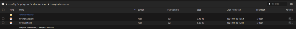

It's not issue with Folder View, you should check your flash drive for config/plugins/dockerMan/templates-user where container template xml files

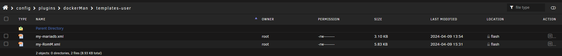

image.thumb.png.fd163b6832f975de3ace86a68c4643c1.pngThese need to be deleted?
Or you mean they are based off that and now all my templates have been somehow deleted?
Edited by Sebby
Fixed it. Just had to restore templates from my backups. Thanks for the help
Yes, there are all your xml templates, if they deleted you can't get to container templates.
Sorry not mentioned that seems they deleted.

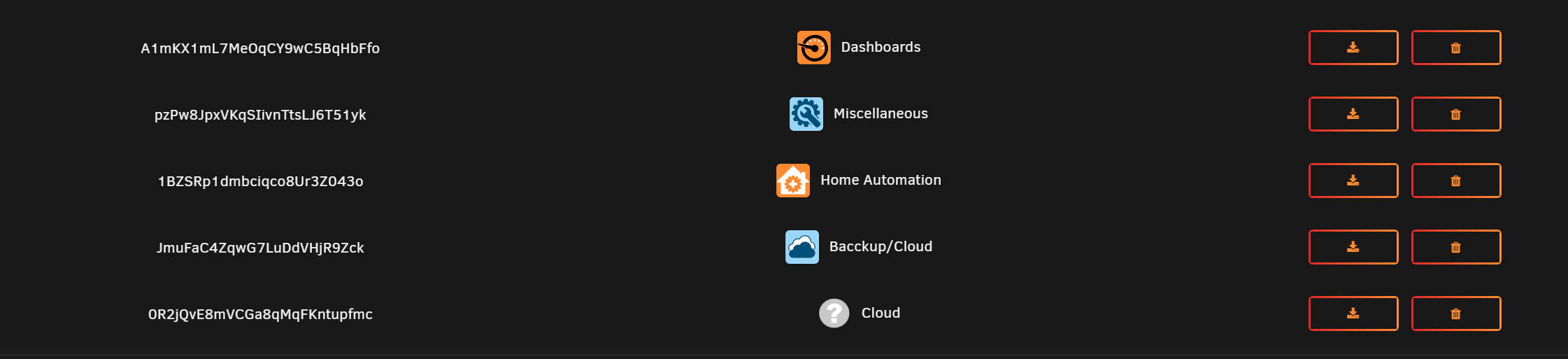

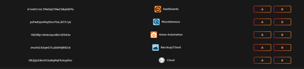

Having an issue where It won't let me create new folders. Every time I add it, it appears in the settings
image.thumb.png.93b1aaf6fbdefffe883f79cbbb37fba6.pngdocker (2).jsonBut not on the Docker Tab. I also can't see the Backup/Cloud one either. It started happening when installing the Nextcloud-AIO-Mastercontainer and used a regex to add all of them. I'm attaching my docker json
Edited by Exes
I want the option to expand folders in the dashboard with a singel click. That`s what the smal arrows next to the folder used to do.
Gotcha. I'm pretty sure we've discussed this before when a user was trying to eliminate some clicks when opening the folders on the Dashboard. The pop-up menu is just the default unRAID interface's way of doing it. I would think some custom javascript, with some CSS sprinkled in to add in the arrow, could perhaps trigger the expand functionality without the pop-up menu.
Since @scolcipitato has given us the ability to add custom javascript and CSS, this is probably not something that will be baked into the FolderView plugin.
I'm pretty swamped at the moment or I'd give it a go. Maybe one of the smarties here can whip something up. 🙂
