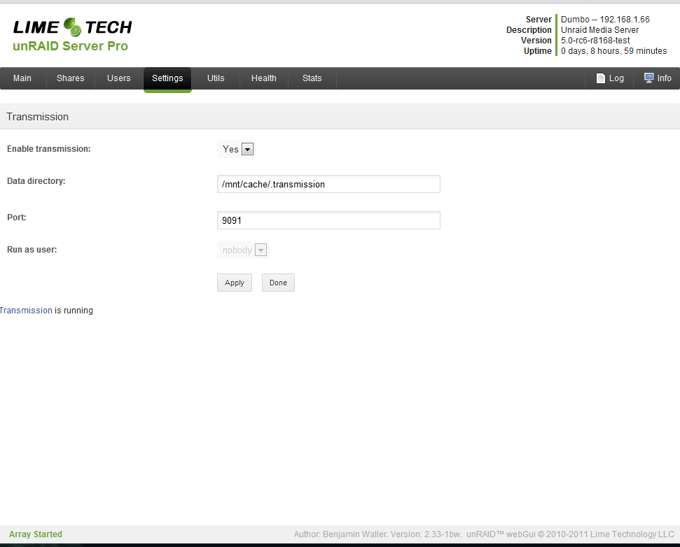

I've got this PLG, the unRaid 5.0-rc5, SimpleFeatures GUI, and Influencers plugins sickbeard, sabnzbd, and couchpotato v2. I also have Plex installed and working.
When I go to spin down my array, it always hangs on transmission and I have to kill-9 the PID to get it to continue stopping the array.
The file name is: "transmission-2.52p-i486-2-logs-redirected.plg"
but when I look in the PLG file name, it says the filename is "Transmission-2.33-i468-2bw.plg"
Where should I start in solving this issue?
thanks!

While I don't run Plex, I am running unRaid 5.0-rc6-r8168-test,  along with Influencers plugins (Sickbeard, Sabnzbd+ and CouchPotato v2).
The "Filename:" portion of the plugin could say "Filename: Applesauce" and have no bearing on the functionality of the plugin, so don't worry about that (I'll update it soonish if it's requested).
before I run the rc script, ps -ef | grep trans reveals there are two transmission processes running.
nobody   15863     1  0 Sep07 ?        00:01:20 /usr/bin/transmission-daemon -g /mnt/cache/.transmission/conf --pid-file /var/run/transmission/transmission-daemon.pid
nobody   25022     1  3 08:32 ?        00:00:01 transmission-daemon --logfile /var/log/transmission.log --port 9091 --config-dir /mnt/cache/.transmission --pid-file /var/run/transmission/transmission.pid
running /etc/rc.d/rc.transmission stop, successfully kills returns "Stopping transmission..." then kicks to command prompt.
a ps -ef after running the rc script shows:
So it appears that I have a transmission-daemon that is messing with me. Any ideas? Did I forget to uninstall something?
