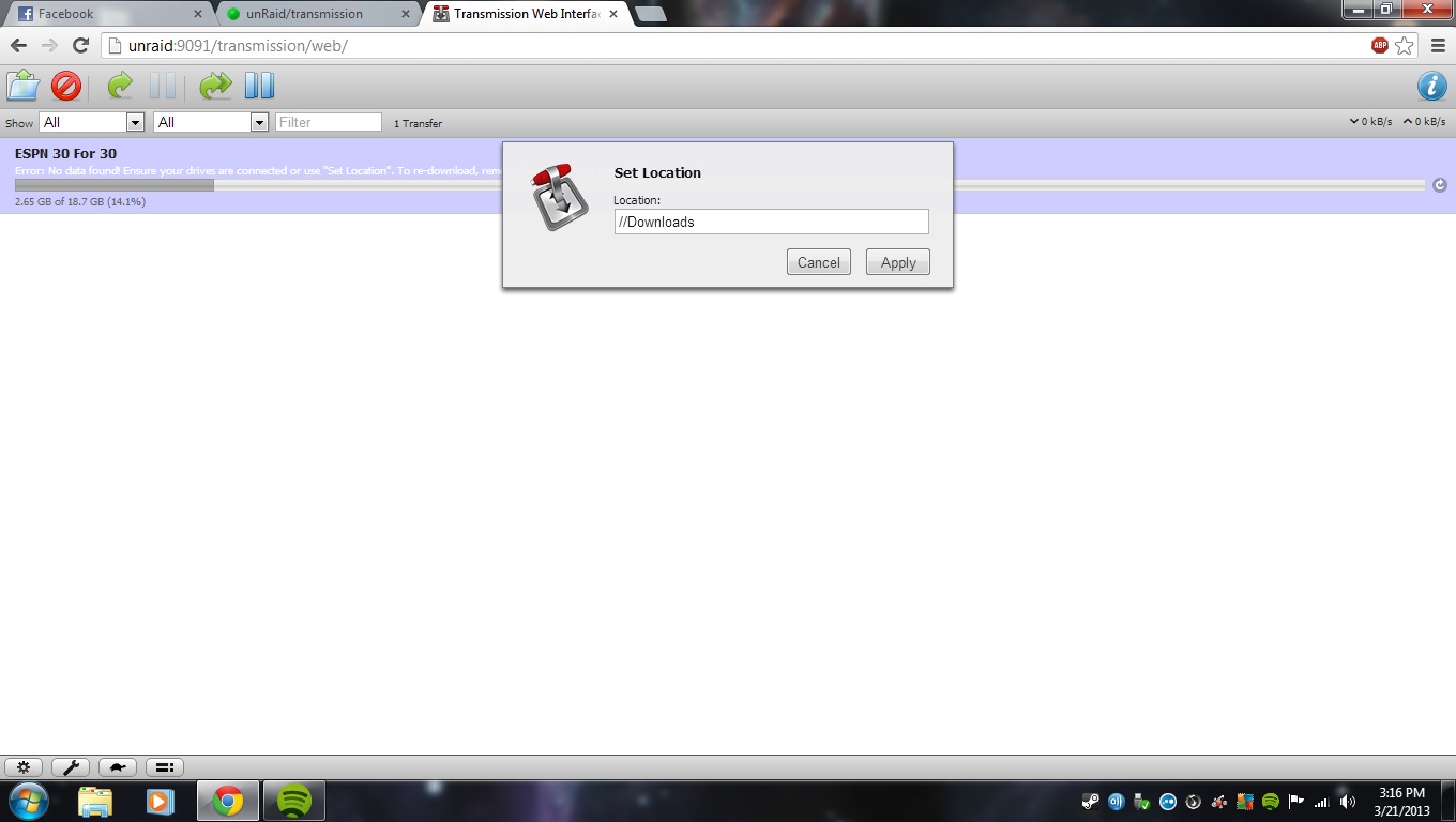

Transmission is starting fine, and I seem to have it installed properly but since I started the download I ran into this problem (see image below)
It seems to be removing the first 2 folders of the filepath and even if I add them manually it does not work.  I tried checking the 'download' folder for the actual application and that one appears to be fine.  I've rebooted the server several times, etc... no luck.
Help ?
