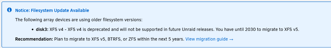

September 20, 20251 yr Question about "old XFS version"How can i see, if the used XFS is "old" or an old version?And is it possible to move all the data to an unasigned device if needed to convert the arry disk to a "new" XFS version?Thanks for your help
September 20, 20251 yr 3 minutes ago, Zonediver said:How can i see, if the used XFS is "old" or an old version?With -beta.3 or newer, it will show in the GUI, e.g.:With previous releases, you can check the log after mounting filesystem:Aug 11 11:05:03 Tower7 kernel: XFS (sda1): Mounting V5 Filesystem ca49c894-b011-4d91-9cf1-63304abf8374 Aug 11 11:05:03 Tower7 kernel: XFS (sda1): Ending clean mountV5 is the new one, if it shows V4, it's the old one.7 minutes ago, Zonediver said:And is it possible to move all the data to an unasigned device if needed to convert the arry disk to a "new" XFS version?Yes, disk needs to be reformatted to XFS again, and it will use v5.P.S.: only XFS filesystems formatted before Unraid 6.0.0 stable , that is, all v6.0.0 betas and possibly also the release candidates, will use XFS V4, any disk formatted with 6.0.0 stable (released June 16, 2015) or newer should be on V5.
September 20, 20251 yr 22 minutes ago, JorgeB said:V5 is the new one, if it shows V4, it's the old one.Thanks for your help JorgeB - its already v5 - Lucky 😅

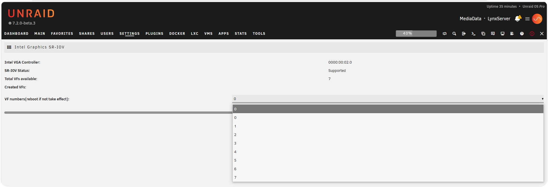

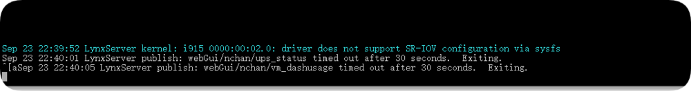

September 26, 20251 yr Hello, I would like to report an issue. After upgrading from 7.1.4 to 7.2.0 beta3, the intel-i915-sriov feature has become non-functional, as shown in the image. Thank you for your efforts.
September 27, 20251 yr 18 hours ago, HDLynx said:Hello, I would like to report an issue. After upgrading from 7.1.4 to 7.2.0 beta3, the intel-i915-sriov feature has become non-functional, as shown in the image.It would be helpful if you could create a bug report with this information and your diagnostics.https://forums.unraid.net/bug-reports/prereleases/
September 27, 20251 yr 36 minutes ago, ChatNoir said:如果可以使用此信息和诊断创建错误报告,将会很有帮助。https://forums.unraid.net/bug-reports/prereleases/Ok, thanks. I have created a bug report with diagnostic information
