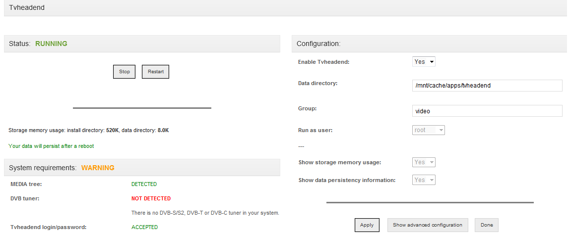

First of, I had only downloaded the latest pkg from piotr, from a couple days ago.  I tried 3 different locations, all seemed to show that the TXZ package was installed, but like we discussed, nothing in my syslog.  Finally I went back and added WW's PLG and I finally had success in seeing TVHeadend at my settings page.  (I guess being the Linux n00b I didn't/don't understand the difference in the PLG and TXZ files).
Secondly, I had already updated the bzroot and bzimage files (I'm running rc8a) using the files that piotr posted on 9/25/12.  So when I go to settings page, it shows:
System Requirements: WARNING
MEDIA Tree: Detected
DVB Tuner: NOT DETECTED
TVHeadend login/password: Accepted
So, I believe that my system does not have the HDHomerun files necessary, as I followed other posts, my lsmod listing does not show anything for HDHomerun.  What step(s) am I missing? Do the HDHomerun files come as part of the bzroot and bzimage files or what?  (Again, sorry for the Linux n00b issues, and thanks for helping!).
Finally, possibly a persmissions issue, but the tvheadend site on my server seems to be up on port 9981, but it asks for user/pass.  I tried my normal root for the server, but no luck.  Am I missing something?

I don't think that the bzimage/bzroot that piotr posted has the hdhomerun drivers in it, which is why I had to compile those in myself and is why this isn't working for you. I described the steps to do so a few pages back and while it was a good learning experience, it's also a bit daunting if you have zero Linux experience.
Anyways, I can post the bzimage and bzroot I am using later tonight when I am at my computer and hopefully using those will get things working for you.
Yeep my image dont have support for hdhomerun (only that why beacuse i dont have any device for test)
