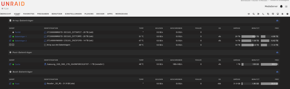

I installed it on my test server, migrated the license to TPM and migrated to internal boot. Feedback:
  • The "Internal Boot FAQ (7.3+)" does not explicity explain, that this is only possible with a pool device and not with an array device. This was only mentioned in the videos
  • The wizard does not explain, that it automatically copies the files of the usb flash drive, it should explain this and list the specific folders, which will be synced. I was happy, that it automatically synced /logs and /extra, but getting a visual confirmation about this copy process would be really nice.
  • The wizard should be moved to Tools I think
  • The wizard should not ask for already existing settings like language, timezone, design, default applications, etc., instead it should help only through the migration steps
  • The wizard should rename the volume name of the flash drive after migration to "UNRAID_OLD" or similar, so it can be mounted through unassigned devices without additional steps (the UD pluging returns only an error, that it is not possible to mount (the reason was the volume label)
  • Is there specific reason why only ZFS is supported? I'm absolutely not a fan of loosing 1 GiB of RAM only because of the boot partition:
  • I think the reboot time is slower now, but I forgot to do multiple reboot benchmarks before migrating to internal boot
  • The file manager links shouldn't be next to each other. Instead they should be next to the partition:
  • Any reason to keep the boot devices section?
  • The backup FAQ needs infos regarding internal boot:
    https://docs.unraid.net/unraid-connect/automated-flash-backup/#restoring-a-flash-backup
    Currently I would say it is needed to stop the array and overwrite all files in /boot?!
