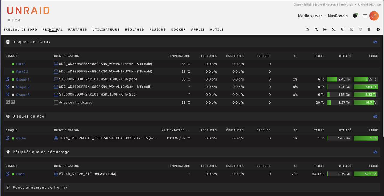

Hi, quick question: is it possible to migrate the bootloader from my USB drive to the internal SSD (presently used for cache and thus redundant) without having to perform a full reinstallation?

My pool is only the internal NVME, as a cache, and i don't use it. It is possible to use Unraid without cache ?
I have 5 disk in the Array (2 for parity and 3 for data), 1 Nvme internal , and usb stick for the boot.. If i need a cache, it will stay like this i suppose.. I will watch closely the video, thanks !
It's not required; it's up to you if you want/need one.
If you want to boost your uploads, you want to keep the cache pool. And if you (want to) use docker or vms, you don't want to avoid a cache (appdata) pool at all as those would be slow and power inefficient on an array disk.
Installing unraid on the nvme for internal booting will only reserve 16GB. The rest of the NVMe is still usable as cache pool.
