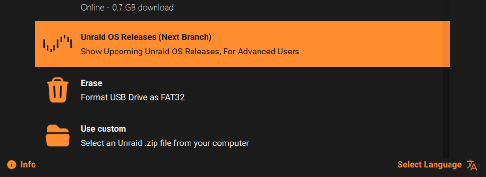

Are there no 7.3 installer yet? I want to do a fresh install.
Need to select next branch in the creator.

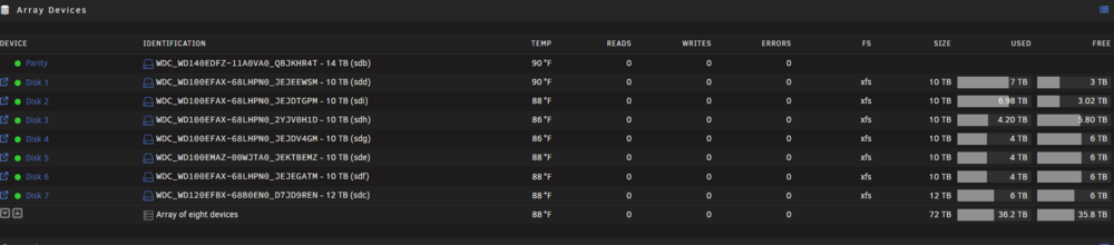

Think 1 bug is my unraid working fine but there is no data read or write statistics being updated.
Edited by alex036
Yep, that's a bug with the array only, speeds show, but not read/writes. Thanks for the report.
