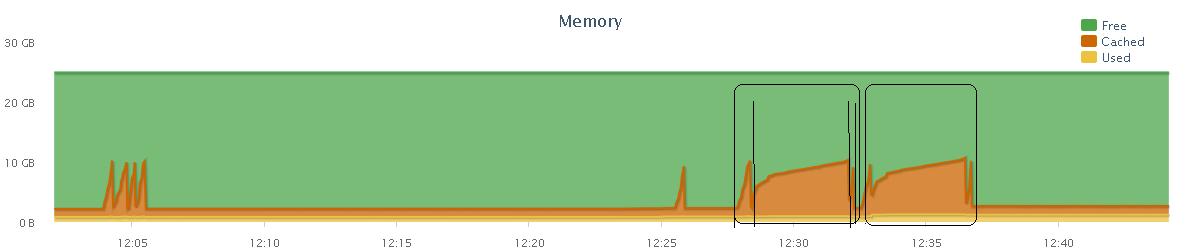

I have a Gigabyte Z77-DS3H with 24GB of RAM (ridiculous I know), 3 data drives, parity drive, and ssd cache drive connected to an m1015 (parity may be connected to mobo), and another non-array drive connected to the mobo.  I had severely slow write speeds on all drives.
I found that putting vm.highmem_is_dirtyable=1 solved my problem (speeds jumped from 1MB/S to 250+MB/s).
I have now done some more tests...
3 write tests to 3 different drives, with dirtyable=1.  The first drive is the ssd cache drive, second is data disk and third is non-array drive (this third drive is SATA I -- the others are all SATA III).  Each test is writing an 8GB file from the console.  The cache and non-array drives were screaming.  The parity protected disk1 was slower (but not as dismal as I had seen before):
dirtyable=1; cache    ; 8GB; speed=202MB/s
dirtyable=1; disk1    ; 8GB; speed=29.8MB/s
dirtyable=1; non-array; 8GB; speed=303MB/s
I tried this twice and got similar results.  What was interesting (to me) was that by watching the memory monitor, it looks like the (slower) disk1 write was fast at first, then slowed fairly soon after the operation started.  The attached graph shows the cache memory growing fairly quick for about the first 1/3 of the operation, then very slowly thereafter.  I am not sure if this is related to parity or not, but that doesn't feel like it should matter to me.
Then I set dirtyable=0 and tried again.  In this case, all writes took ages, and the cache memory growth was uniformly slow growing.
dirtyable=1; cache    ; 8GB; speed=19.9MB/s
dirtyable=1; disk1    ; 8GB; speed=35.8MB/s
dirtyable=1; non-array; 8GB; speed=27.1MB/s
In this case, I was surprised to see that these were significantly better than the 1MB/s I had seen before.  In fact, the disk1 parity protected write was even better than with dirtyable=1.  The graph shows that the cache memory consumption growth was uniform and stable (mem2.jpg attached).
Then... I realized that my test was deleting each test file as soon as it was created.  I moved the deletions to the end of my script, and (duh) the cache buffer filled more.  My deletions were freeing the associated cache buffer memory.  After moving the 3 deletions to the end ofo the script, the speed of writing and memory growth was still fast, then slow, then fast again (see mem3), with cache consumption peaking over 20GB.  This confirms that the actual disk writes underneath the cache were still going along slowly.  At least I know that having lots of memory will distance me from the problem in most operations.

This is actually the best performance I've ever measured.  Hmm...
Couple other tweaks that may (in general) speed things up is to disable remote differential compression and disable TCP window auto tuning Link.  Also if one is using maps to unRaid shares and using anti-virus, excluding those network maps from the anti-virus program could speed things up depending on the Win 7 system hardware.
