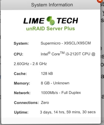

I'm also running a x9scm-f with 8gb of ram.
I don't seem to be having any issues it seems.
My server is running since a vouple of months now. It has been running since rc8.
I'm not running it virtualized.
I'll post the complete specs tonight with some speed figures.
Normally read speed is about 120+Mb/s and write is above 50 with cache.
