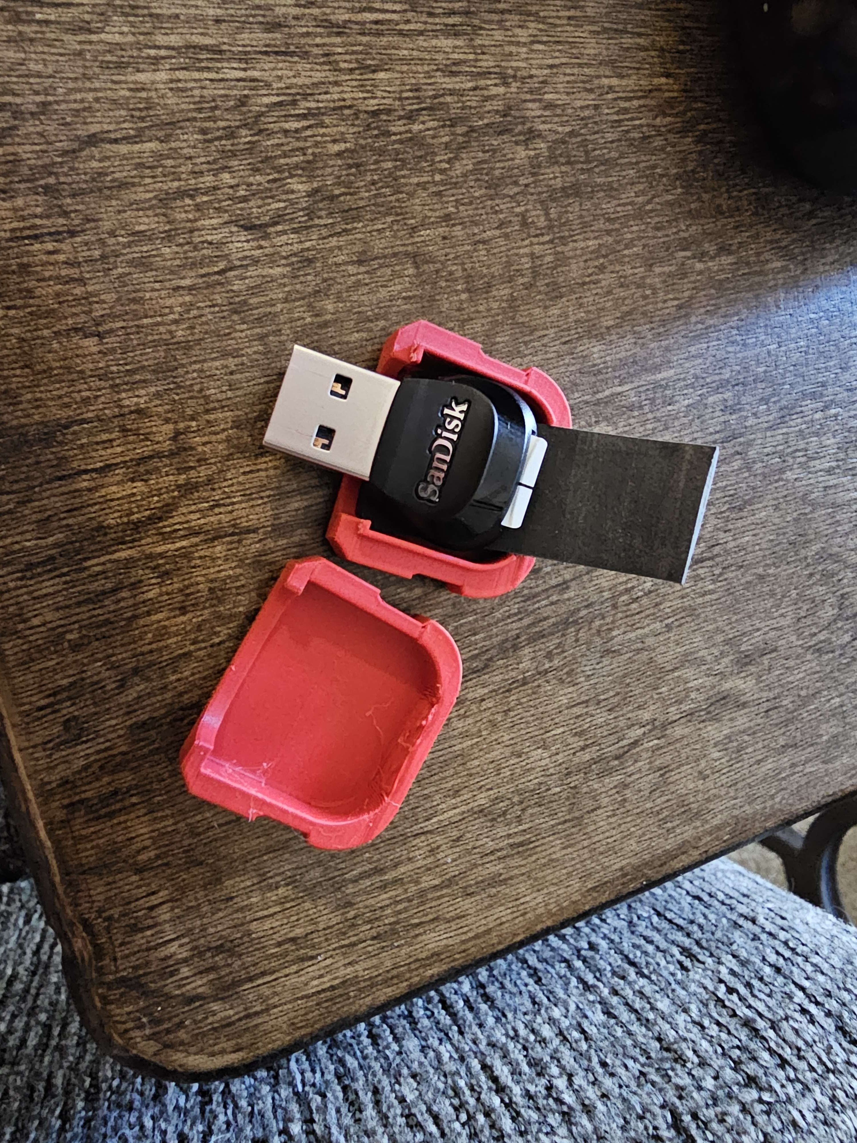

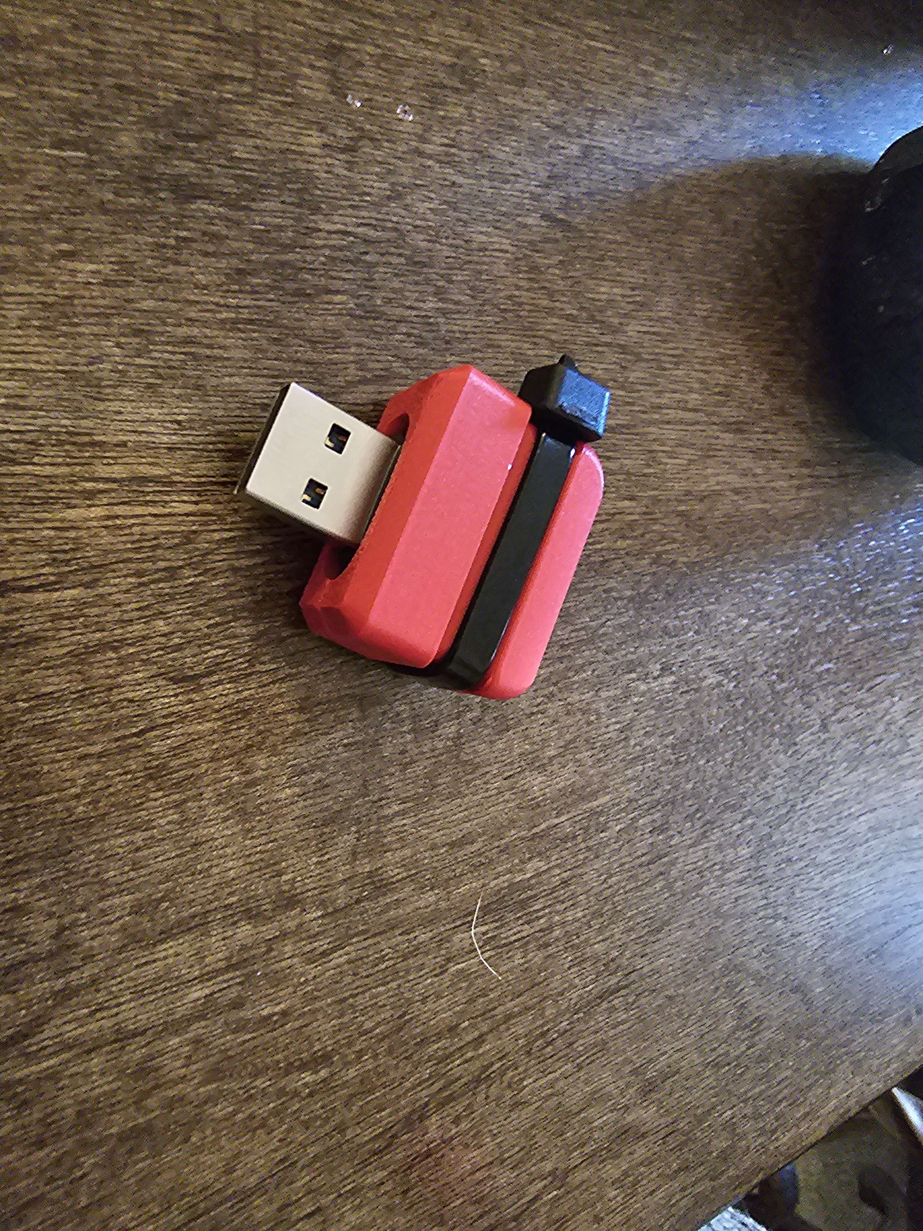

Just got this reader and card and it is working perfectly.  I already tried switching between two cards by running the usb creator and then copying all the files from a previous card and it works.  Very easy.
https://www.amazon.com/gp/product/B07G5JV2B5?ref=ppx_pt2_dt_b_prod_image
https://www.amazon.com/gp/product/B07CV344WJ/ref=ppx_yo_dt_b_asin_title_o00_s00?ie=UTF8&psc=1
I was a little worried about the card just being open to the back, so I cam eup with a 3d printed enclosure for the reader with the card.  Basically turns it into a full usb drive that I can but the zip tie and swap the card out easily enough.  I'm just using some rubber sstrips right now to secure it inside the enclosure but at some point I will use something like Sugru to perfectly mold the inside of the enclosure to the reader with card.
Can you figure out a way to take the temperature inside the enclosure? I'd be afraid of cooking it.
Hmm,  Hadn't thought too much about it.  I can do a test using a temp probe.  I'll put a small hole just big enough for the probe and see what temps I end up getting.  The Sandisk industrial card is rated up to 85C and 190TB lifetime.  I think it should be fine.  Worst case I will design the enclosure with holes in the top and bottom so it has more of a bumper appearance but lets the actual top and bottom of the reader breathe.  I'll report back once I get this data!
What about the reader? Same?
I found one place that says it is rated to 60C, but I have no idea if that is reliable since it isn't listed on any spec sheet.  I have a second reader and card coming this weekend.  I will do a test using my enclosure do a sustained write sequence to the card to reay heat it up and stress test it and report back the temps it hits inside the enclosure right against the reader.
I did a few tests writing to an sd card constantly for 30 minutes and inside the enclosure never hit above 50C.  Obviously not a fully scientific test, but encouraging at least.  I would be surprised if modern hardware like a card reader can't be good to at least 60C for extended periods.
And this should only happen with the Unraid flash USB if the syslog is set to mirror to the flash drive.  Otherwise, the only writes should be an occassional configuration update.  Mostly, the Unraid flash gets read on boot and is not accessed a lot after that.
Been running it now for a week and everything seems to be going great!  I can get a couple extra of the sd cards to keep on hand in case one dies and no worries about needing to change keys!
