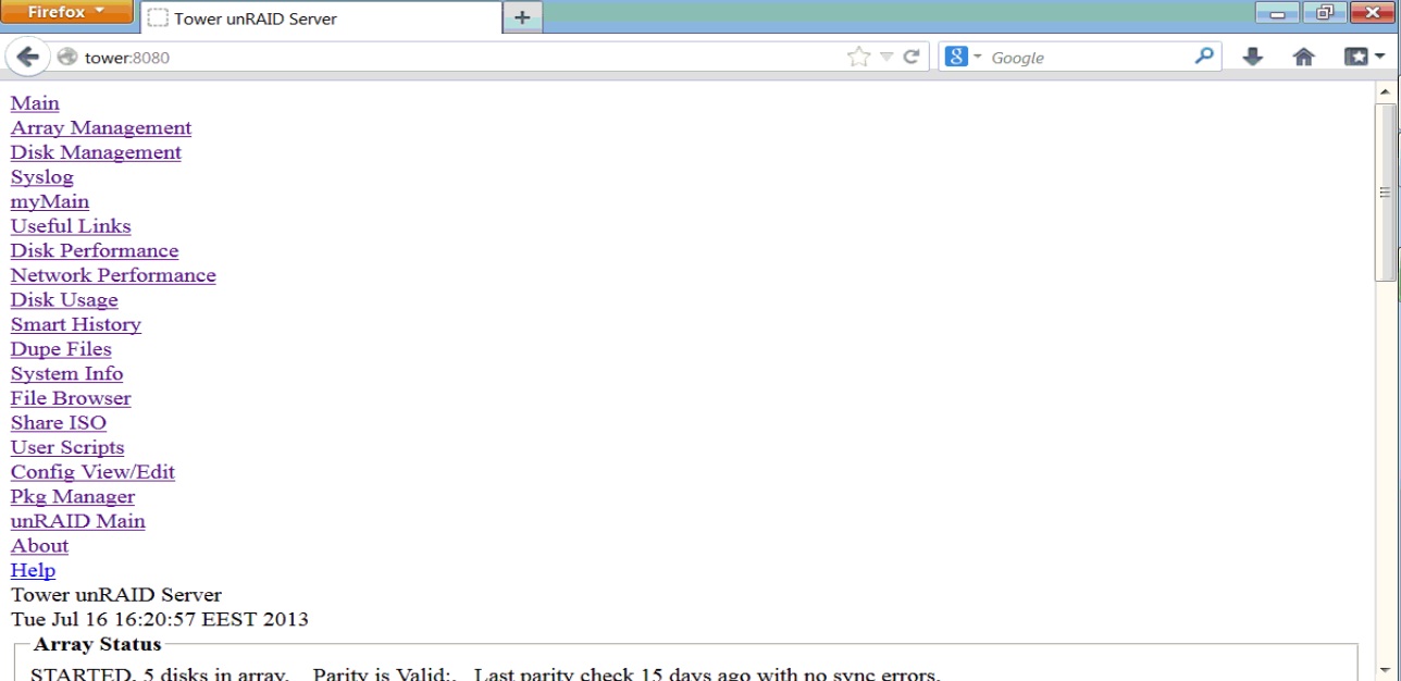

After messing up with some plugins and restarting my server unmenu's menu bar became text only and with the error below in syslog.
I remove some new installed plugins and restarted again but same again.
Any idea about the problem?
Tower unmenu[29135]: tail: option used in invalid context -- 0
Edit: and no files in Pkg Manager: No Packages defined in package configuration file(s)
Edit2: i update&restart unmenu from user scripts pkg manager and skin now seems ok.
