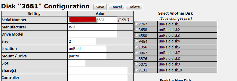

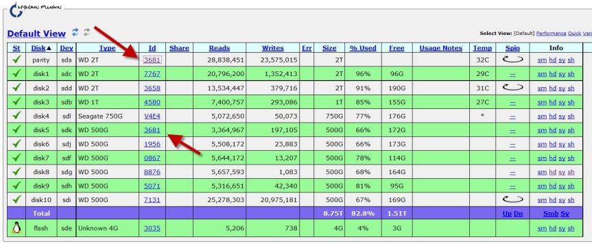

Joe L.,
I just happen to have two disks with the same last 4 digit serial numbers. My parity and disk5. What are the chances huh? (1 in 10,000 with WD I suppose)
This leads me to not be able to set any configuration data for Disk5 as it is seen as the same disk as my Parity and no new entry is made in myMain_local.conf.
Been aware of it for a while and and never thought it was big deal because that 500gb drive will be the first one I replace. However I started to wonder if it being misidentified could cause any issues in any other areas.
Joe L.,
I don't know of any issues it would cause...
You can edit
myMain_local.conf
and add a line like this:
SetConstant(IdLen,          6)        # number of digits for disk id (used in drive settings screen)
Odds are you'll see a unique serial number when 6 characters are visible.  (capitalization is important, so follow the example accurately)

Copied and pasted your line exactly then changed 6 to 5.
Shows everything with a 5 digit ID even the config page but when you save settings on the disk config page it saves them in myMain_local.conf with a 4 digit ID (ie SetDriveValue(3658)
Erased existing entry manually from myMain_local.conf, restarted unmenu and then tried saving a new entry but it again showed up as 5 digits everywhere but saved as 4 digits.
Went and manually put the extra digit in each entry in myMain_local.conf and that displayed everything as 5 digits. As soon as I changed a value and saved it changed every SetDriveValue line for that disk from 5 digits back to 4.
Like I said not a big deal for config info as I'll end up replacing that drive anyway. My main concern was if any smart data would get wrongly displayed in MyMain or something.
