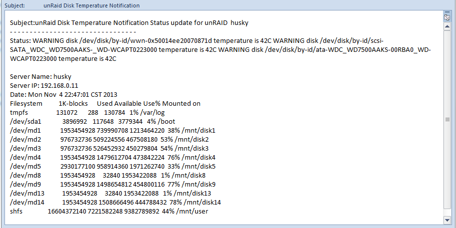

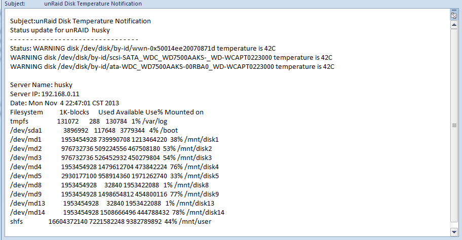

Fix output of the unraid status emails in Outlook:
Go to 'File > Options', then on the left side select 'Mail', scroll down to 'Message format'
Uncheck 'Remove extra line breaks in plain text messages'
Attached images below so you can see the difference. Main thing is the Status at the top.
