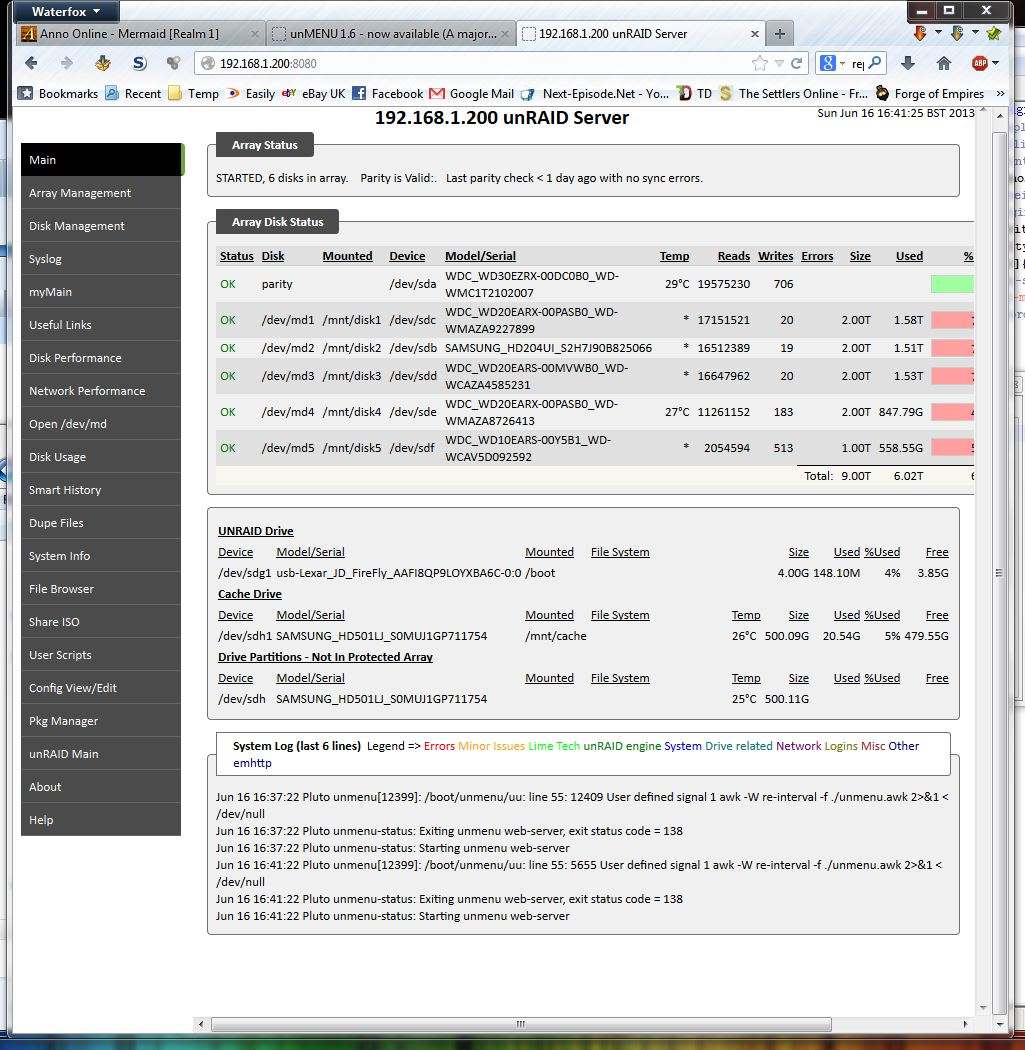

Hi
Loving the new unMENU but think I found a problem.
When i Switch to unMENU Vertical Skin appearance and use unMENU on something with a small screen I'm unable to scroll right to view all the stuff that's off screen there.
Hi
Well, don't do that... ;)
Since the .css is easily editable (if you know style sheet syntax) we'll have to wait on someone who is knowledgeable to create a "mobile-web" version that can scroll horizontally.
Glad you like the new look.
