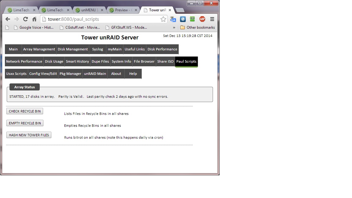

:D Thanks guys. As you said Joe - looking at the unMENU files , after getting enough bash scripting knowledge to be dangerous, I discovered that unMENU has excellent comments and is explicitly designed to allow anyone to add all sorts of top level tabs.
Excellent stuff!!
Took me a couple of minutes to copy / edit 50-unmenu-user_scripts.cgi in the /boot/unmenu folder and then point my edited 50-unmenu-paul_scripts.cgi to point to a different ScriptDirectory.
thanx - paul
Excellent stuff!!
thanx - paul
You are welcome.
Yes, it is VERY extensible.  I wanted to make it easy for non-developers to add "tabs" of their own and have unMENU automatically include them.  (I also comment my code far more than most developers.  It helps me to figure out what I'm doing years later.  ;))
Joe L.

I guess that this is a question for Joe:
What's the easiest way to make a plug-in page auto refresh? I looked at unmenu.awk and saw the MENU[2] test for main page refresh. Should I add a similar check for my page or is there a better way to do this?
cheers - paul
cheers - paul
Try adding
#ADD_ON_REFRESH=10
to the top of your plug-in page.  The "10" is the number of seconds between refresh.
That should (if I remember correctly) set the "refresh" in the HTML header for you based on these lines in unmenu.awk (around line 420)

Thanks Joe - unfortunately this didn't seem to work. As a test I modified the standard User Scripts plugin as you suggested
#ADD_ON_MENU User Scripts
#ADD_ON_URL user_scripts
#ADD_ON_REFRESH=10
#ADD_ON_VERSION.......
Restarted unMENU but the page never auto-refreshed. Tried this in Chrome & Firefox same results. Main auto-refreshes fine in both browsers. I'll continue to investigate.
cheers paul
#ADD_ON_REFRESH=10
cheers paul
Try adding:
#ADD_ON_HTTP_HEADER=YES
Try adding:
hi cassius - no that didn't work either.
cheers - paul
