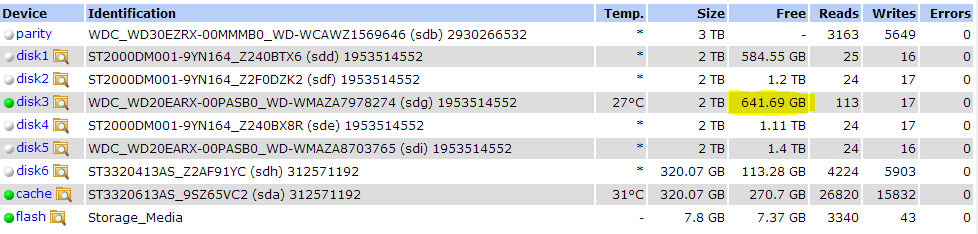

The disk has 641.69 GB free space, and the share I'm writing to only exists on that disk. The cache drive has 270.7 GB free as well.

whats the health status of your cache disk?

Currently I'm finishing a parity check. I figured with all the rebooting I've been doing lately, should probably run one. How do I check the health status? The only way I know is to use unmenu, but I'm in safe mode at the moment.
Apparently unmenu is still available when booted in safe mode. Smart attributes:

Which drives is this?

You have a relocated sector, you may want to keep an eye on that drive.
  5 Reallocated_Sector_Ct   0x0033   100   100   036    Pre-fail  Always       -       1
It's my cache drive.
I have a handful of spare drives laying around. I plan on replacing it when I get home.
