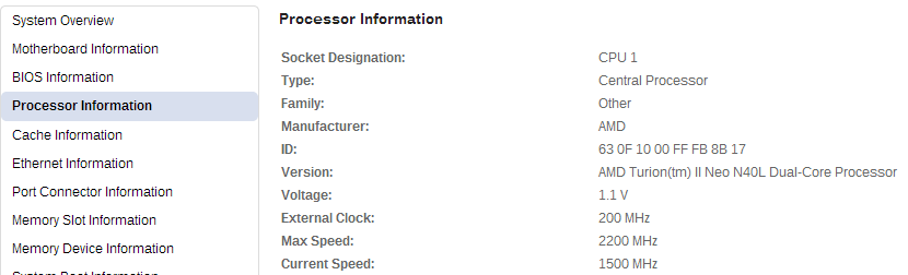

System Profiler/Info gives me the wrong CPU speed on my HP Microserver N40L. It think it is running at 1500MH instead of 800MHZ (and thinks the max speed is 2200MHz instead of 1500MHz). The info is correct if I telnet in and cat /proc/cpuinfo. This was a problem with simplefeatures as well, but now that there are fresh eyes on it, maybe we can find the issue.
Obviously, this is essentially just cosmetic, although I'm not sure where else it would get the CPU speed from.

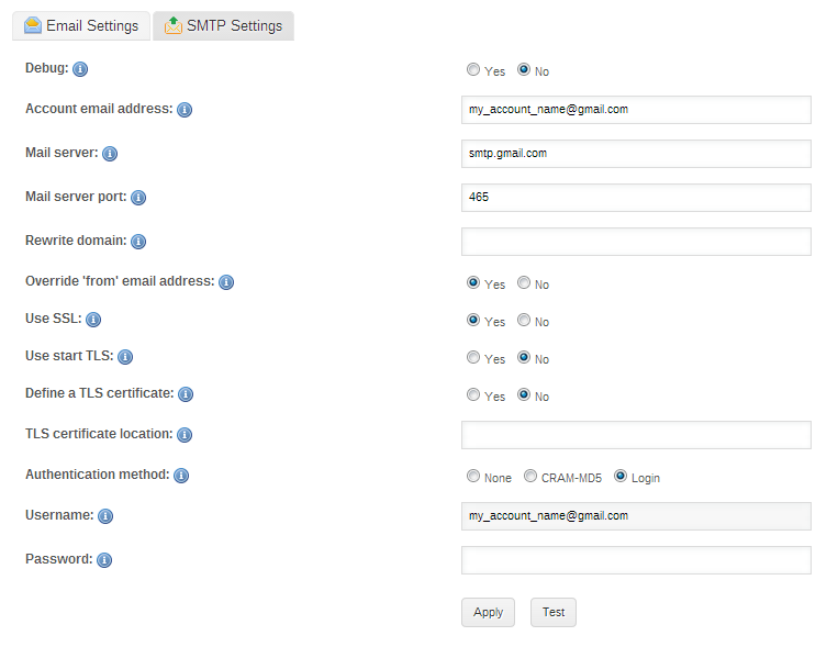

Has anyone using Email Notifications had luck setting it up with Google Apps (basically gmail) 2 Step verification.  I had SF working just fine using an application specific password but now Dynamix doesn't work and gives this error.
Jan 10 20:17:39 Tower sSMTP[14330]: Creating SSL connection to host
Jan 10 20:17:39 Tower sSMTP[14330]: SSL connection using RC4-SHA
Jan 10 20:17:40 Tower sSMTP[14330]: Authorization failed (535 5.7.8 http://support.google.com/mail/bin/answer.py?answer=14257 gv10sm21179820pbd.0 - gsmtp)
The link talks about word verification being the issue but I already tried clearing that and the title to the page says "client" isn't accepting so I'm inclined to guess its something with sSMTP on my machine and not Google.
I am using a gmail account and have it working. Posted a screenshot of the settings below, you need to fill in your own gmail address of course !
It might be an SSL issue, are you using any other plugin with openSSL ?
All of the implementations make use of the utility called "dmidecode". So it seems this utility isn't reading the correct values, unfortunately there isn't any newer version available atm, but I can keep an eye on that.
