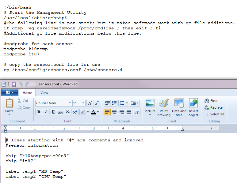

Here's my latest attempt.
The last prompt should be a NO. Although, I'm not sure what difference it makes.
Nothing against WP but you shout try notepad ++
Already in place. Wordpad to quickly view, Notepad++ to edit. :)
