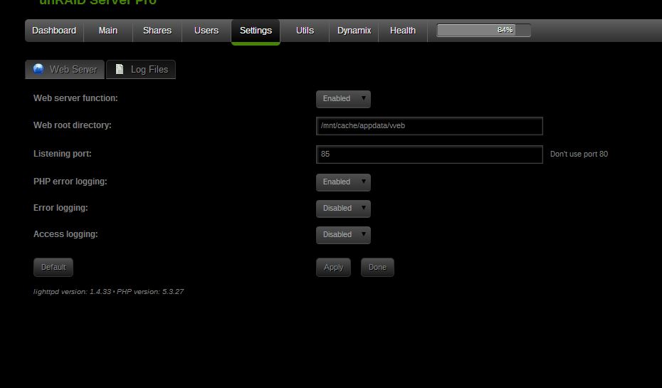

I've included a couple of screenshots of my config.  In short, I used the plugin manager to install the webserver and then rebooted.  I changed the install directory to my cache drive.  When I click on Apply, I see the php.ini error on my console.  I try to get to the webserver and cannot - tower:85  I also tried the IP address with port 85.
I guess I can try uninstalling and install again, after my parity check is done - about 24 hours from now.
Update:  I may have found out why it's not working.  I just realized that my edited version of the plugin wasn't copied over to my flash.  As per the first post, I edited the webserver plugin and used slackware version 14.00. However, it seems I accidentally copied the orginal, which has 13.37.  I'll have to wait for my parity check to complete and then I'm going to uninstall it and install it again with the updated plugin file.  I hope this is why it's not working.

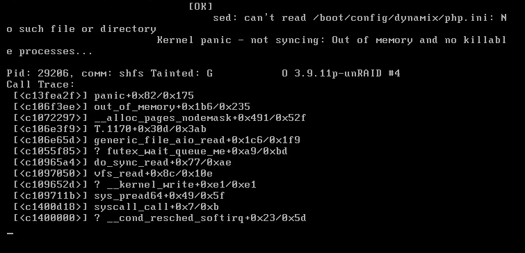

So everything "seems" to be installed and working "ok" other than the issue from my post above and the fact that the last few weeks I've had 2 crashes.
noticed this error also sed: can't read /boot/config/dynamix/php.ini : no such file or directory
Here is a screen shot (Attached) of when my system crashes.  I can't do anything when it crashes, no syslog, no nothing.  =\
any ideas?
good luck - I didn't get any help with this plugin and decided to uninstall it
any ideas?

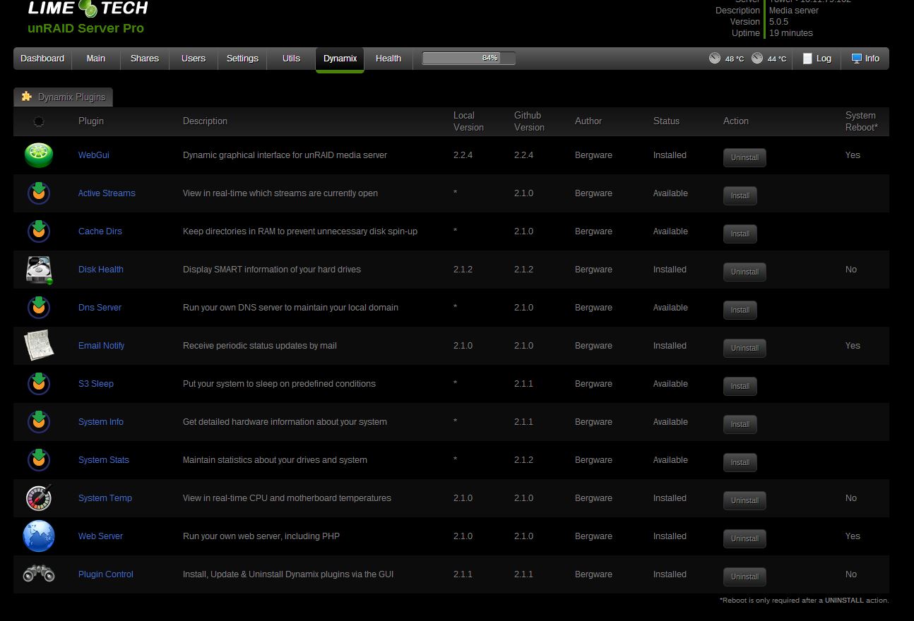

See here

There is a bug in version 2.1.0 of the Dynamix web server (pointing to the wrong PHP file location).
It will be corrected in the upcoming version.
