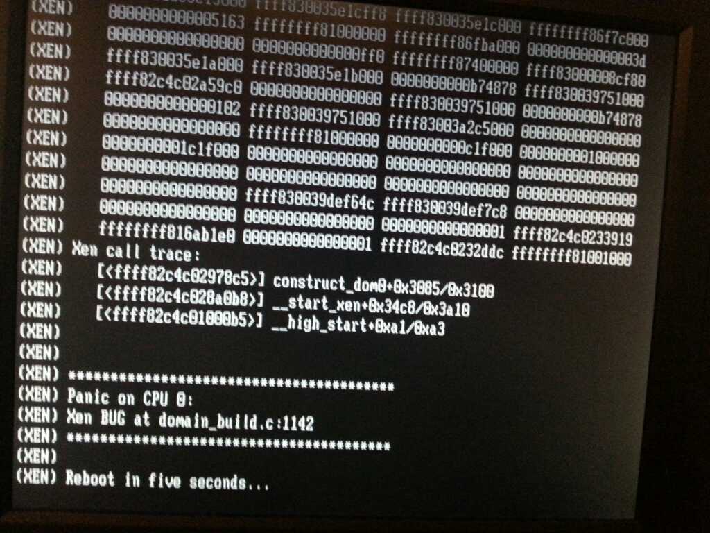

Running unRAID 6.0b3 on test server (ASUS A8V-Deluxe, AMD K8 CPU, 1GB RAM (2x512M), SIL3114 PCI 4-port SATA controller, ATI 9250 GPU, 1.5TB drive).  6.0b3 runs like a champ.  Tried to boot Xen for first time today.  Receiving CPU Panic during boot (after Xen, bzimage, bzroot loaded); reboots after 5 seconds.  I've only seen one reference to CPU Panic tied to 6.0.  Looking for any insights to work through problem.  Screenshot attached.
Kevin
Kevin
Can't tell you why you got a kernel panic, but the default settings in syslinux.cfg will not boot Xen on 1GB ram. Modify that file and change the dom0_mem to 'dom0_mem=512M' (for example) and see if it boots.
@sparkysplace,
That was the problem.  Had to allocate 768M to get it to boot.  Thanks!

'lsusb' does not appear to be implemented/available in 6.0beta3 (booting into Xen). Can it be added?
Reason;
I'm having trouble passing USB controllers to VMs. Where a USB controller shares an IRQ with other PCI devices, it can lead to VM crashes.
I want to try to pass specific USB devices through as described here;
http://wiki.xen.org/wiki/Xen_USB_Passthrough
But I need to issue 'lsusb' to enumerate the devices.
Thanks
