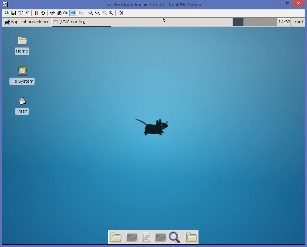

After typing this you should see your telnet window switch to being the console of the new VM (that's what the
 -c
option does).  You should see a "grub" boot menu displayed with a count down.  Just hit Enter to make it gittyup, upon which you'll see the Ubuntu linux booting.  When it's done you'll be left with a login prompt.
Now let's connect to the VM using vnc.  First thing to do is login to the Ubuntu console: username "root", password "password".  Now type this command:
vncserver :1
This starts a vnc server running on the Ubuntu VM.  The first time it starts it will ask you for a password to use on the vnc client.  Also you should look at the IP address assigned (via dhcp) using the 'ifconfig' command.
Now fire up your vnc client (I use tightvnc on windows).  Connect to the Ubuntu IP address and specify port 5901.  If all goes well it will prompt you to enter the password and then you should see the Ubuntu xfce desktop!

Can someone explain WHAT this is exactly?
Is this unraid running/hosting a vm where a linux distri is running in?
Or is this a server booting in Xen (?) and Xen is running/hosting 2 vm's, one with unraid and the other with a linux distri?
unRAID is the host OS and has Xen enabled.  In Tom's example, Xen is hosting an Ubuntu guest VM (which is shown in jevans04 post above).
