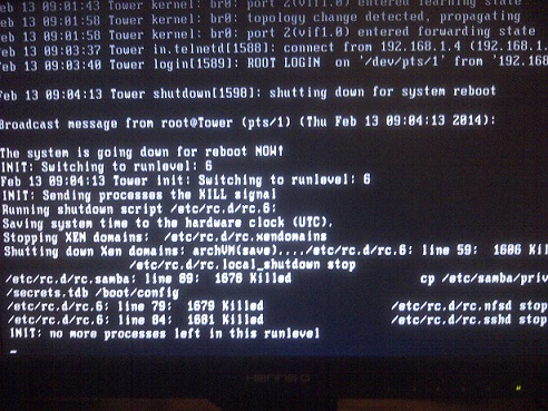

Tom,
I have found a hang up when shutting down unRAID for a reboot.
I have unRAID with Xen running and no plugins installed.  I have installed Ironicbadger's ArchVM and it is running.  It has some unRAID samba shares mounted and I have the Logitech Media Server running in the VM.
If I run a "shutdown -r now" command without shutting down the Arch VM, the system hangs after switching to runlevel 6.
The syslog before initiating a shutdown is attached.
The attached picture is what the console shows when shutting down and where it hangs.
If I shutdown the VM first, everything proceeds as normal.
Let me know if you need any further information.
syslog.txt

Tom,
Ok.  I'll investigate this at some point.
