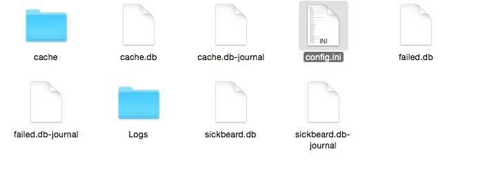

I have just installed the needo sickrage docker (second one I've tried). I can access the app and seems to be working fine. However, I cannot find the autoprocesstv files to change config of and map to from Sab.
All that is in my config folder is as attached.
Does anyone know how I find them?
Ta
Daniel

OK - interestingly it is there, its just not in the config folder.
I accessed the docker file system by using a dialogbox within sickrage intended to select a path for a different option and I navigated to /opt/sickrage and low and behold there it is.
Unless I have fundamentally missed something here - I cant figure out how to either move this folder from where it is to the config folder (which I have mapped to the host) OR map sab option for "auto processing folder" to this folder (as it is not exposed) let alone get to the config file to change anything in it.
I "feel" like I really HAVE missed something fundamental here. I can't be the only one with this issue?

OK - I have "fixed" my issue.
I downloaded the Sickrage Source in a zip file from GitHub containing the autoProcessTV folder. I copied this to the config folder and then pointed sab to that folder.
I did have a few issues with post processing not working which I figured to have this docker working ok I had to have NetworkType to "Host" AND I also had to explicitly define the location of the tv folder in the Sickrage config.
All working now though.

I think I am getting a hang of Docker now! I found a better way of doing it I think via volume mappings.
My volume mappings are:
/config  =>  /mnt/disks/app/docker/appdata/sickrage/
/opt/sickrage/autoProcessTV  =>  /mnt/disks/app/docker/appdata/sickrage/autoProcessTV/
Essentially to me this means the autoProcessTV location within /opt is now mapped to a folder called autoProcessTV within my config folder (mapped in the line above).
