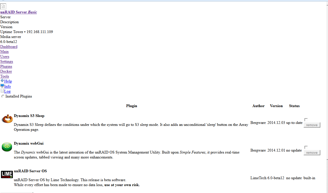

What happens here is that the sheer installation of the S3 Sleep plugin over the updated dynamix messes up all the pages of the webGUI. It appears as if there's no CSS and no PHP actions (HTML text, no formatting, no action on buttons). Sample screenshot attached.
When S3 Sleep is installed on the "vanilla" (beta12) Dynamix, no problem. When Dynamix is updated - breakage. When I remove S3 Sleep, then update Dynamix to latest - no problem; when I now install S3 Sleep - breakage.
Deleting the S3 plugin files and rebooting doesn't fix the breakage. Deleting the entire /boot/config/plugins/dynamix - does. Deleting only /boot/config/plugins/dynamix/dynamix.cfg - also does.
The problem seems to be with the fact that S3 Sleep plugin writes the dynamix.cfg file if it does not exist. What I end up with here is:
[confirm]\nsleep="1"\n
[display]\nsleep="plugins/dynamix.s3.sleep/Sleep.php"\n
That's the entire file.
I'm guessing you don't experience this because you do have dynamix.cfg already, in which case the plugin edits it, and seems to do that correctly.

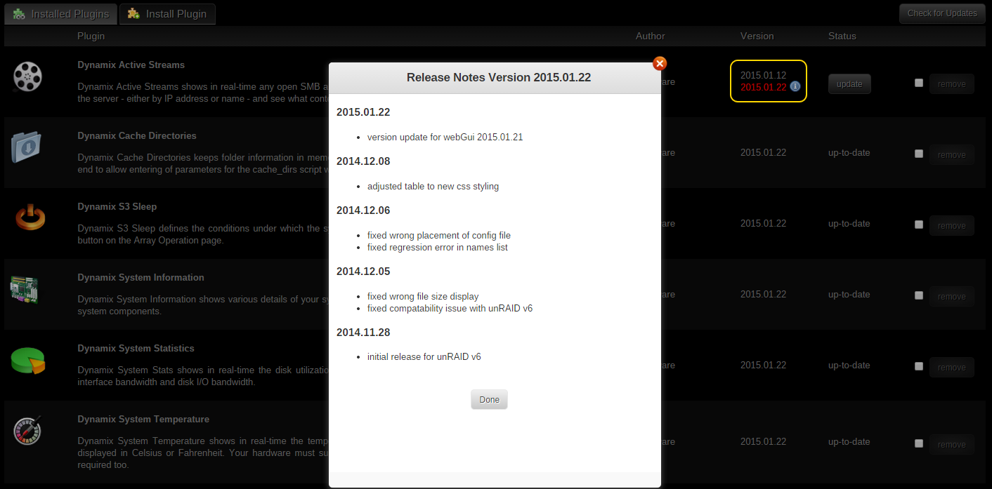

Did anyone of you notice the "info" button and read the changes prior to installing the plugin ?
Says something along the lines of
Updated for the new web GUI
They all said the same thing
Have a look at the attachment. Pressing the blue "i" button brings up a second window with release notes (you need webGui version 2015.01.21 for this).
