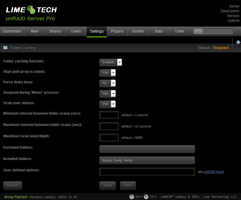

cache_dirs won't start, tried starting it from web UI and aldso via '/etc/rc.d/rc.cachedirs start'.
Same here... nothing in the log either!
Hmmm working for me. Which is to say... It works... So what is different?
can you walk us through how to start it?
Settings -> Folder Caching -> Status:Stopped
Cant seem to see the start button either
Change the 'Folder caching function' setting to Enabled and then the Apply button at the bottom.
That isnt working for me
Same here - cache_dirs will not start.
next I did this:
1.uninstall plugin
2. reboot
3. install plugin and enable, after apply the service did start
4. reboot - the service shows enabled but it is stopped and will not start again.
next I did this:
1.uninstall plugin
2. reboot
Interesting.  Seems to work on a re-instal on my end too following your steps.
Also like your results a reboot will not allow it to restart
Doing some more quick tests and will report back
edit:
Tried disabling before a reboot, with no luck. It apears a reboot breaks the Folder Caching.
If you can not get it to work uninstall and reinstall.
After every reboot you will also have to repeat the uninstall and reinstall.
However no reboot is required between removing and reinstalling the plugin.
Tested with Dynamix Cache Directories 2014.11.28
Dynamix webGui 2014.12.01
The cachedirs plugin downloads the cache_dirs script each time the plugin is installed.  If the Internet is not available (network may not be ready yet on a reboot) or the download does not succeed, the plugin will successfully install but the cache_dirs script will not be available.  That is why it won't start - the cache_dirs script is not available.  I've passed this along to bonienl with some ideas on how to fix.
For the time being, remove and then re-install the cachedirs plugin until a fix is made.
This is indeed happening. I will look into an approach that suites the requirements. For the time being use the workaround as explained above.

Good to hear, I have made a correction to the installation script as well, this will become available in an upcoming version.
The 2014.12.03 update for the Dynamix Cache Directories solved the issue for me. Thanks!!!
