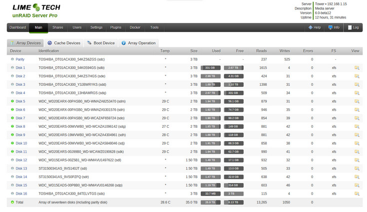

My drives don't seem to be staying spun down.  I do see unRaid log of them spinning down but something is spinning them back up. I can force them down and they do spin down, but after an amount of time they come back up.  I've not had this problem in the past. Only thing I've changed since switching to 12 is adding Dynamix System Temperature and install Cach_dir Dynamix Plugin vs just running it from my go script.
For instance, here is my log up until I updated my APC plugin just a few minutes ago.
Dec  5 05:32:02 NAS1 logger: mover finished
Dec  5 06:00:38 NAS1 kernel: mdcmd (93): spindown 2
Dec  5 06:02:19 NAS1 kernel: mdcmd (94): spindown 0
Dec  5 06:02:20 NAS1 kernel: mdcmd (95): spindown 3
Dec  5 06:03:51 NAS1 emhttp: shcmd (22813): /usr/sbin/hdparm -y /dev/sdh &> /dev/null
Dec  5 08:58:08 NAS1 kernel: mdcmd (96): spindown 4
This would lead me to believe they were spun down, however they are not, they were all spinning.

I just spun the drives down manually at 2:06pm  and now at 2:16 all but drive 4 are spinning.  I'm the only one here and wasn't accessing any files.
Dec  5 14:06:07 NAS1 kernel: mdcmd (97): spindown 0
Dec  5 14:06:08 NAS1 kernel: mdcmd (98): spindown 1
Dec  5 14:06:08 NAS1 kernel: mdcmd (99): spindown 2
Dec  5 14:06:09 NAS1 kernel: mdcmd (100): spindown 3
Dec  5 14:06:09 NAS1 kernel: mdcmd (101): spindown 4
Dec  5 14:06:10 NAS1 emhttp: shcmd (25688): /usr/sbin/hdparm -y /dev/sdh &> /dev/null
Only drive I would expect to be spinning is drive one where I have some torrents stored.
Is there a way to track down what might be spinning these drives back up?

smartctl 6.2 2013-07-26 r3841 [x86_64-linux-3.17.4-unRAID] (local build)
Copyright © 2002-13, Bruce Allen, Christian Franke, www.smartmontools.org
Device is in STANDBY mode, exit(2)
root@unRAIDb:/usr/local/emhttp# hdparm -C /dev/disk/by-id/ata-HGST_HDN724040ALE640_PK2334PCHX2DLB
/dev/disk/by-id/ata-HGST_HDN724040ALE640_PK2334PCHX2DLB:
drive state is:  standby
If you do the smartctl and get a full attribute listing with the ID# header, then don't post all that data at this time, Just post that you received a full attribute listing.
Attached is a copy of the picture in text.
DriveSpin.doc
no cache_dirs installed. Plex (installed on cache) set to look for new once a day. I do manual update when I add movies usually. Sorry can't run hd debug right now :P
i have this same issue with HDD - WD WD2002FYPS
i have 4 disk ST2000DM001 and 3 WD2002FYPS - i have spin down setup for 15 min - after this 15 min ST2000DM001 disk go to idle
and WD2002FYPS stay active :(  - they only go sleep after manual spin down from webGUI
i have setup for all disk "use default" but i try change for WD disk manual per disk to 15 min or 30 min and test, after that again back to use default
but nothing help - all time stay active ( dont go to idle from automat).
i was try also delate super.dat file (but i dont know if this is connected)
i must add - from beta12 im add 2x WD2002FYPS becuase on beta11a i have only 1 but sleep/idle for this one works fine on beta11
I also have this similar problem. the spindown issue confines to WD 2T green drive. I have cache dir on. This issue only after beta12.
Could you boot without Dynamix and see what is happening?
